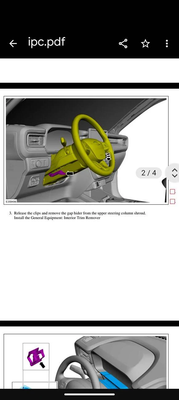

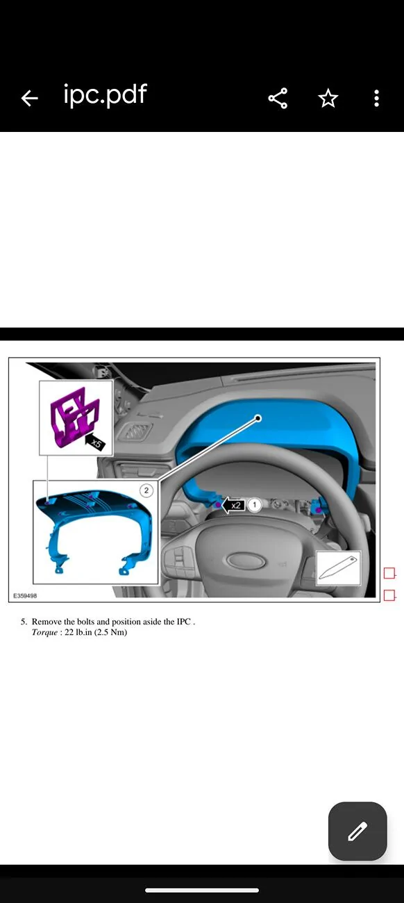

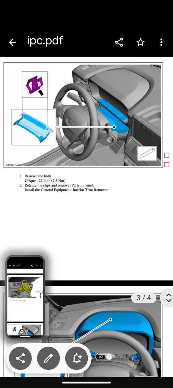

Anyone had the issue with the instrument cluster and how did you solve it? Like I mentioned above once I put some pressure of top of the cluster the rattle disappeared. But not sure how to solve this.
bgn
Jun 12, 2021
3,038
5,696
WA
Ford Maverick Dashboard Rattle Screenshot_20250626-095014
Ford Maverick Dashboard Rattle Screenshot_20250626-095017
Ford Maverick Dashboard Rattle Screenshot_20250626-095025
Add insulation to the black piece.
I will definitely look into this. Hope I don't break anything with the flimsy materials they are using.
Really appreciate it. Thank you.
bgn
Jun 12, 2021
3,038
5,696
WA
Having done it, you want to be careful with the first step of removing the cover at the bottom of the cluster. Everything else would be tough to break.
