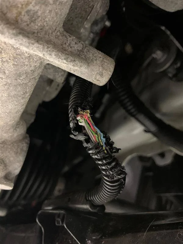

Wheel speed sensor installed today, still not fixed. I have a bad feeling it might be something in the transmission/transaxle--at 4500 miles!!!
What was the code the tech. found? I had a C0512 (right rear speed sensor open), and associated ABS, PSCM, and IPMA module codes. Same symptoms you described. Bad wheel speed sensor harness, had a corrupt wire or connection on the sensor signal side. Changed the harness about an hour ago, resolved fault.
My guess is you have the same issue.
Cheers.
