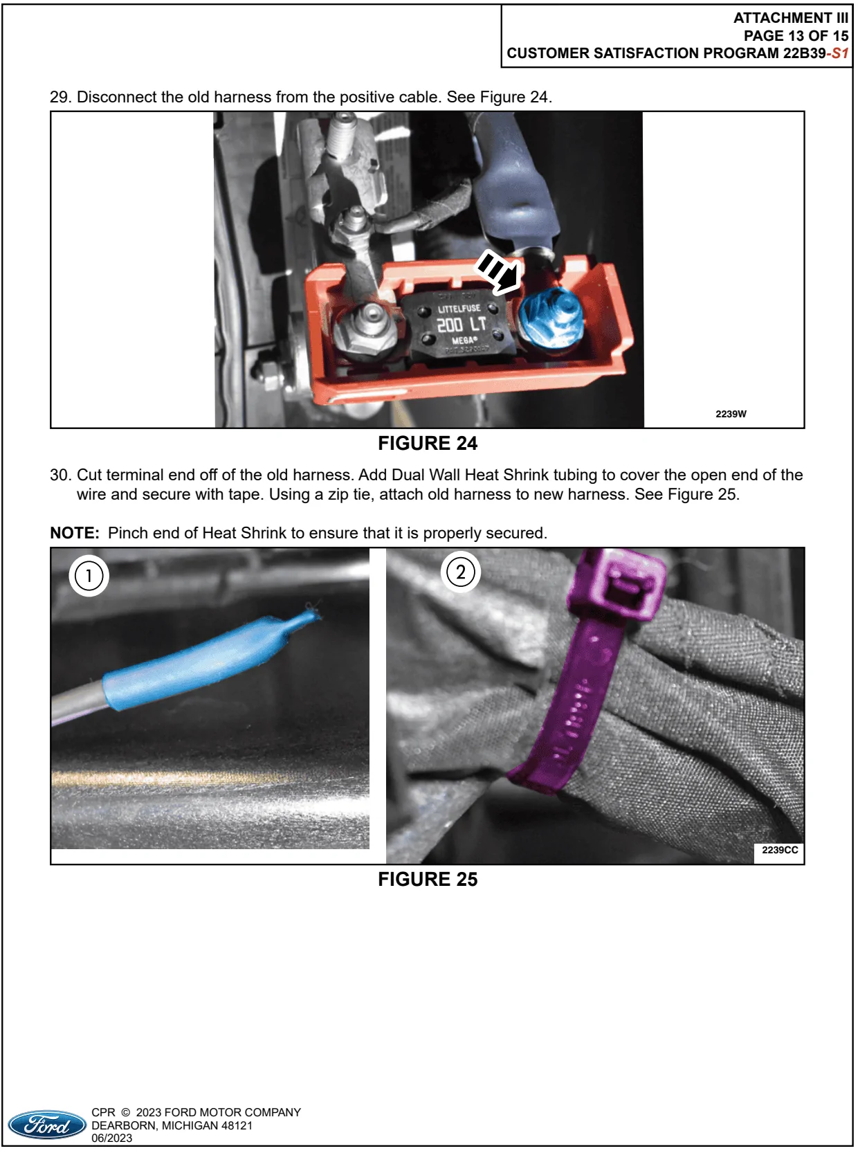

NHTSA now has the Ford directions for the CSP here.
Just running a new cable alongside the old one sounded a little hokey to me but apparently that is indeed what they're doing.

It's not a second line. It's a replacement. Only the new overlay harness will be live.
The original wire harness remains in the vehicle but the terminal will be cut off and covered with Dual Wall Heat Shrink tubing. Think of it like an electrician at your house running a new wire in the walls to replace an old one. They'll often leave the old wire in the wall, but simply twist on a wire nut on the exposed ends, and bury it in the wall. Not really worth the time and money to rip the old wire out of the wall.
Same thing here. Ford just doesn't see value in paying techs to fish out the factory wire harness.
