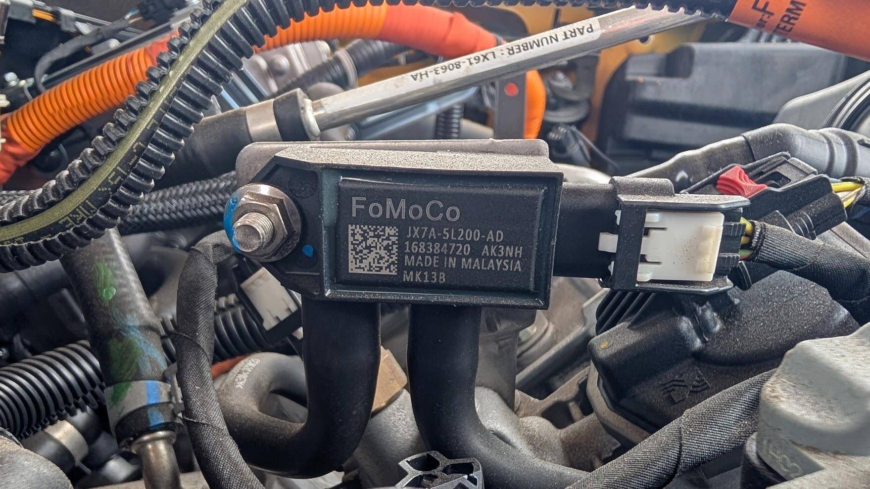

Doing some more research...wondering if anyone has seen this before: https://static.nhtsa.gov/odi/tsbs/2023/MC-10232494-0001.pdf
This is pretty much what I'm dealing with...the part number they reference is for the full sensor with the hoses attached (seems to be out of stock everywhere), but the sensor without the hoses is available. It's right on top of the engine...no reason to think it would be a difficult job:
Ford Maverick Customer Satisfaction Program 24N04 - What to replace? 1747149867247-w0
Now I'm curious as to why my old dealer service department didn't know about this TSB when I had the truck there last year...

Not to dig up an old thread, but wanted to close the loop in case anyone else has this issue and is out of warranty. I finally got around to fixing it a couple weeks ago.
If you look at the TSB, it says the part to replace is LX6Z-9J433-A. This appears to be both the JX7A sesnsor I pictured above, plus the bracket it sits on and the two hoses that feed into it. It's about twice the price (or more!) of the part that I wound up ordering, which was just the sensor.
I didn't see any reason to replace the hoses/bracket if it's just the sensor that is malfunctioning, so
I googled part no. JX7A-5L200-AD and found one on Amazon for $45. It says it's only for F-150s and Broncos, but everything looked exactly the same as the one in the Maverick. I figured I'd just return it if it didn't look correct when it arrived.
Anyway, got the part overnight, it was exactly the same. Unbolted the old one, pushed off the hoses, put the new one in its place. Took all of 2 minutes. Cleared the codes and it has not come back...this was about 3 weeks ago. Truck seems to be running much better, but that all might be in my head...
Either way, if you're plauged with the P0402 code give it a shot with part JX7A-5L200-AD.
