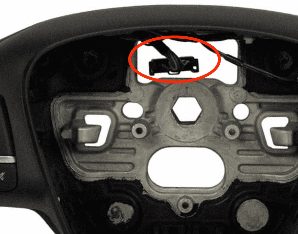

I'm betting that XL folks will be able to use OEM parts, but it needs to be confirmed... To use the OEM hardware completely, someone needs to verify that the base steering wheel is wired for the LH Cruise Switch cluster. The chain of components is: Switch > Steering Wheel > Dash Harness... It may not just be as simple as installing the switch, although you could easily pin the wires yourself.
Ford Maverick Cruise control add-on Screen Shot 2021-10-26 at 9.33.16 PM
Ford has five iterations of this steering wheel and the base version may different wiring. If the steering wheel connector that goes to the dash harness isn't pinned for cruise control, it won't work even with the XLT/Lariat switch. The solution will be DIY or the installing the new steering wheel and switching your airbag over.
If the internal steering wheel wiring is identical, AND the wiring from the dash forward is compatible, then everyone can use OEM components pending the software configuration.
