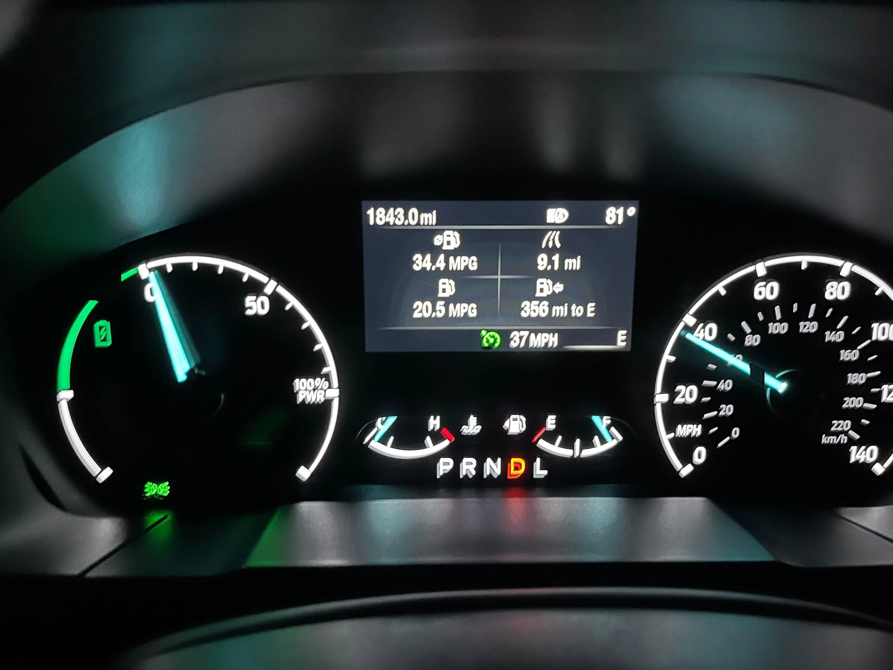

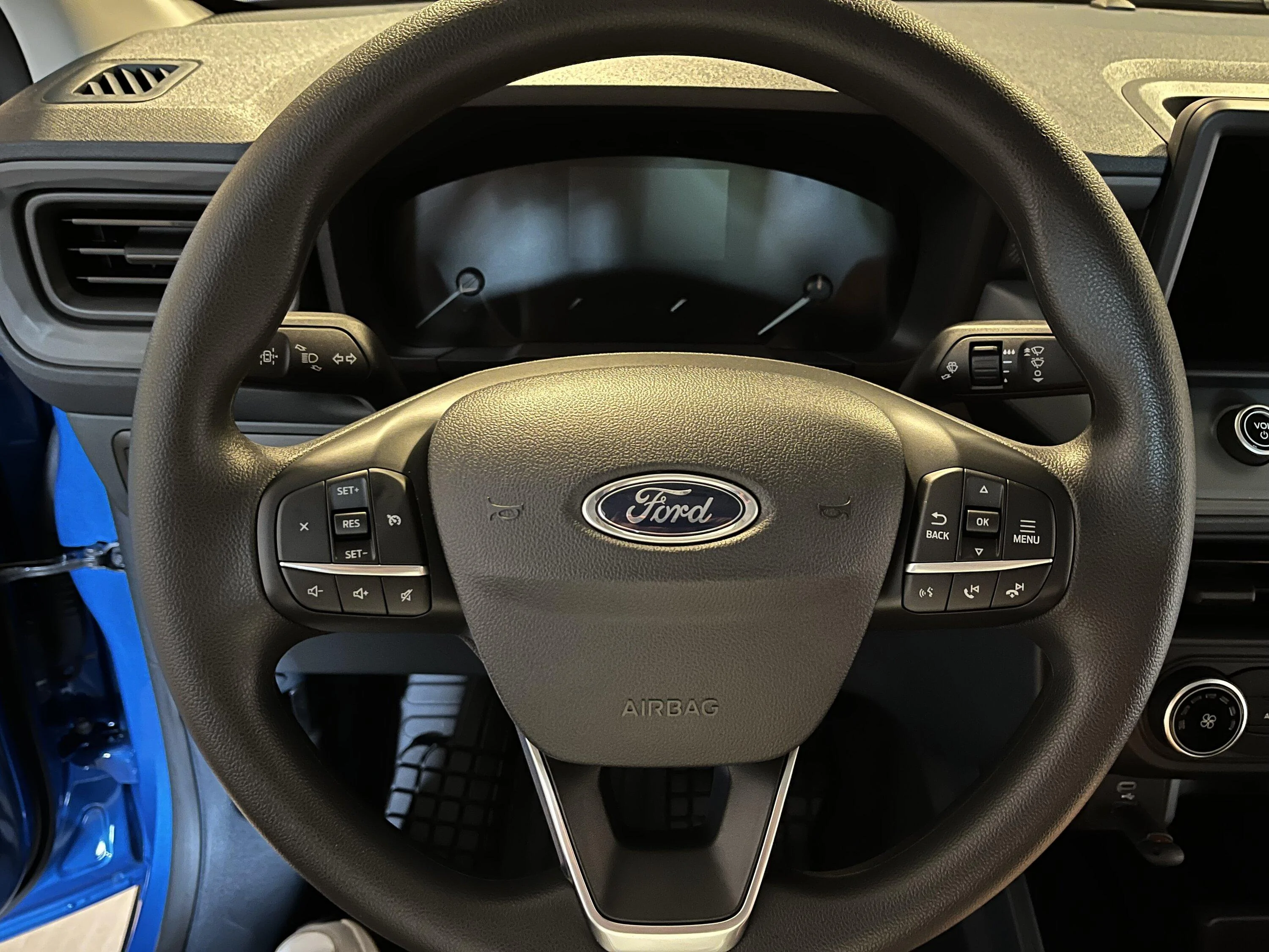

Absolutely no problems on two that we did so far!
Ford Maverick Cruise control 6. factory original XL steering wheel NEW cruise control switches
Ford Maverick Cruise control 7. cruise enabled

I ultimately, changed the control switches and programming. Works great. I would not go aftermarket. I know it sounds very daunting, but it's no big deal. I left the steering wheel on and gently pulled on the trim by hand. Remember to disconnect negative battery first. Handling of airbag kinda scared me but was super easy.
Good luck wherever, you end up doing!
