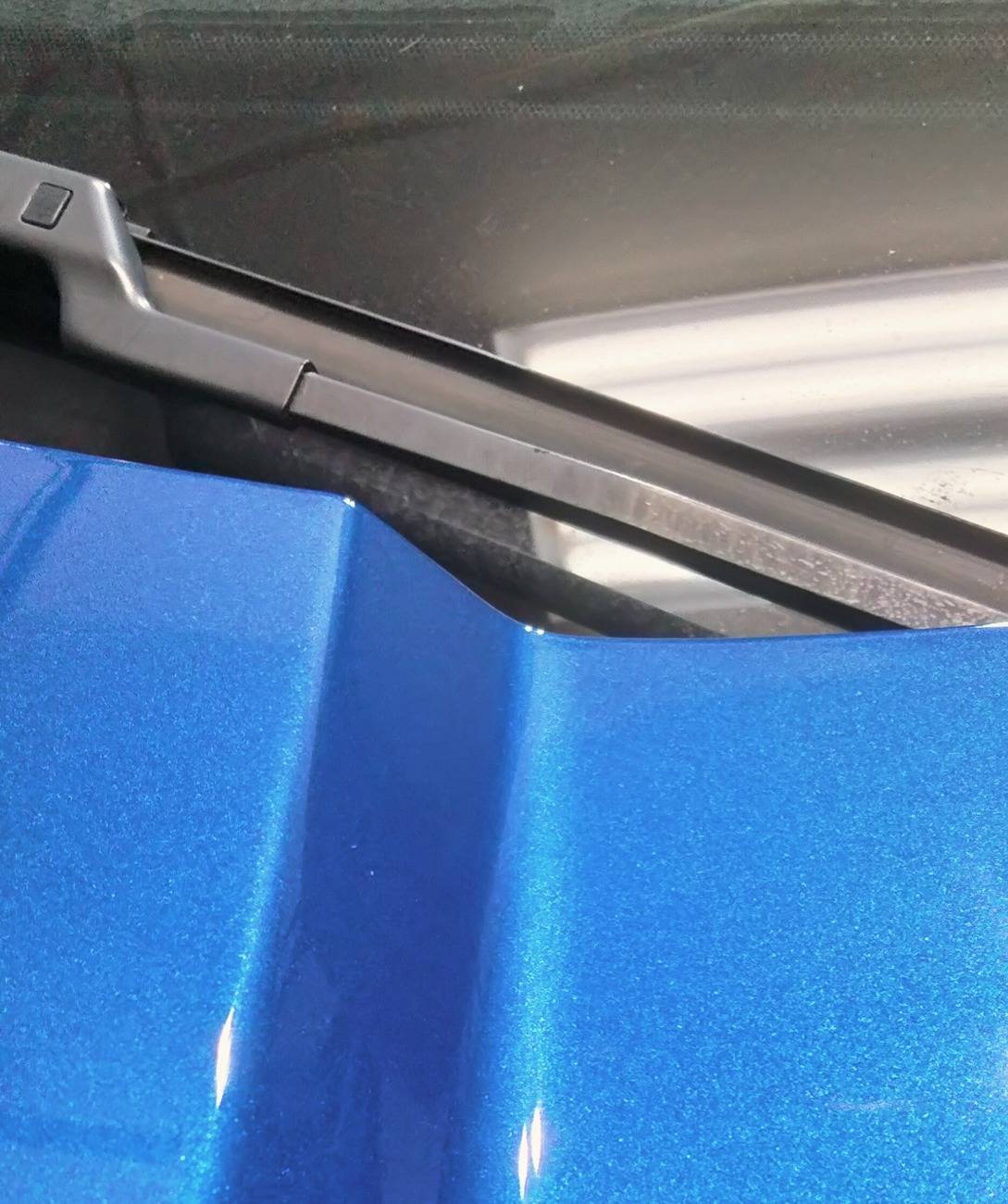

I’m following this as well. When I first saw your photos I saw the texture as well and. I have carbon fiber wrap stripes on the same area. Did your wipers make contact with the hood edge. Some people lifted them up while cleaning under them and accidentally cycled the wipers and they collided with the hood edges. Not saying you did but the blue hood photo has small chips on the trailing edge as well. Let’s us know what Ford Warranty department says.

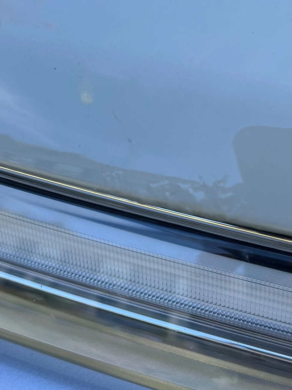

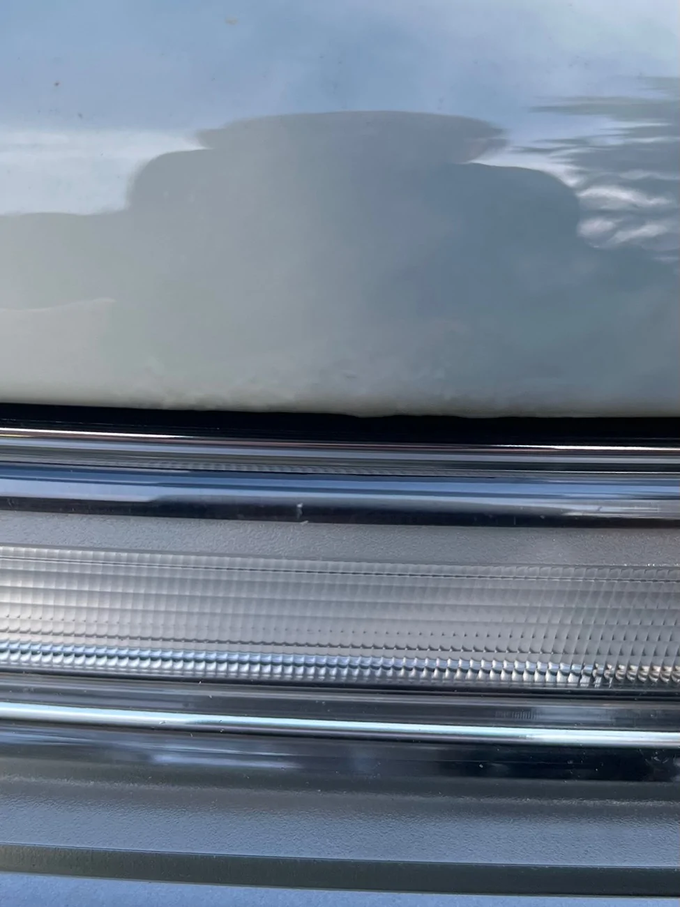

Found two spots on the front of the hood. Calling about the galvanic corrosion. Mine is the 2022 Lariat 2.0.
