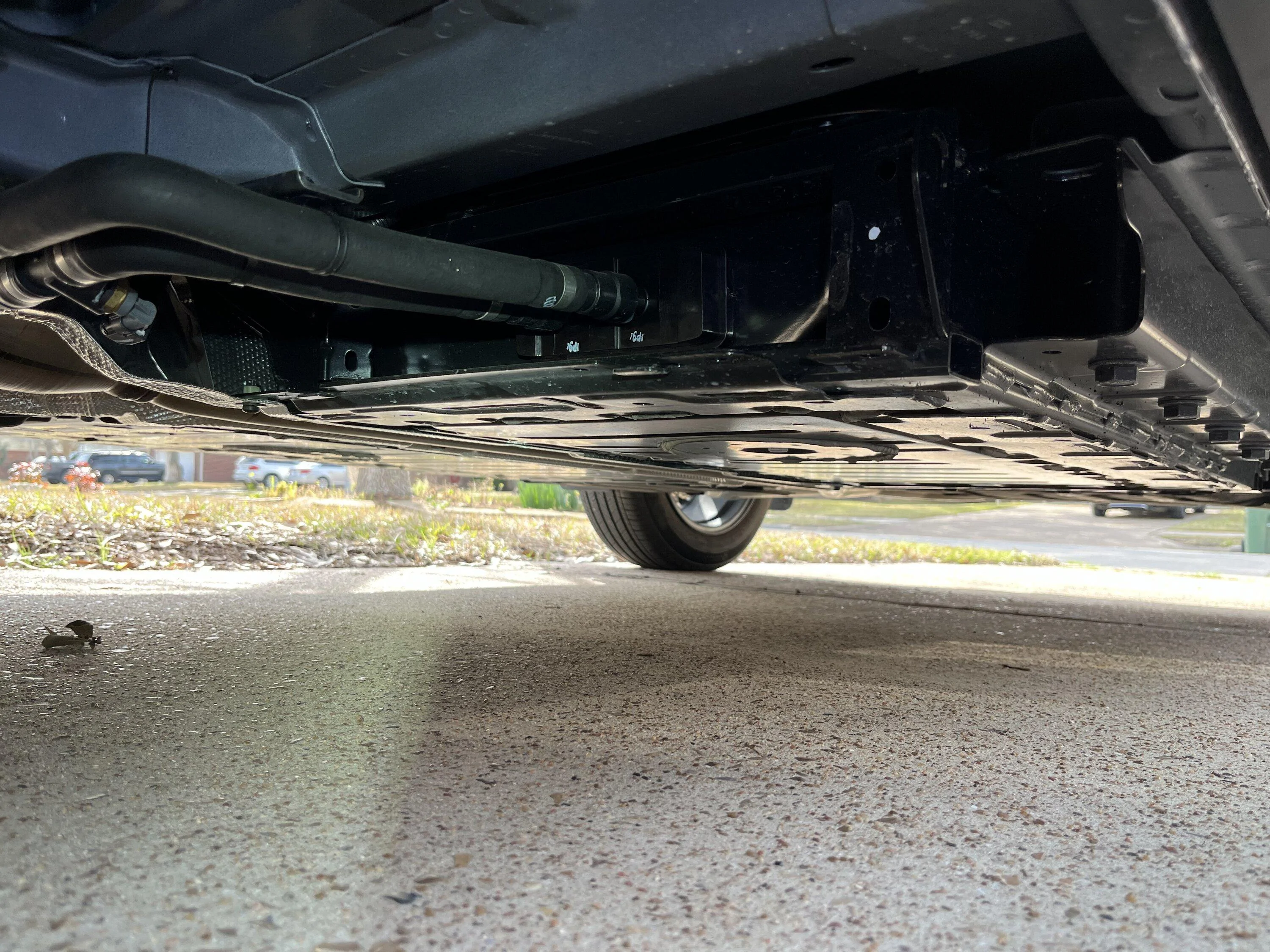

23 F150 XLT Powerboost, 22 Escape Plug-In, 23 Bolt EUV
I was looking at the Escape PHEV's HVB as someone's had a broken cooling fitting that's on the front of the HVB pack. New 14.4kWh Drive Motor Battery Pack ~$8300.
Escape PHEV's HVB goes just in between unibody from side to side.
Pict is w/o the splash shield.

Pictures like that are why my Mav isn't off-roading....
I knew a guy in a small car that hit a rock and poked a hole in the gas tank. Sure Maverick sits higher, but it scares me to think about possible damage to the HVB...
