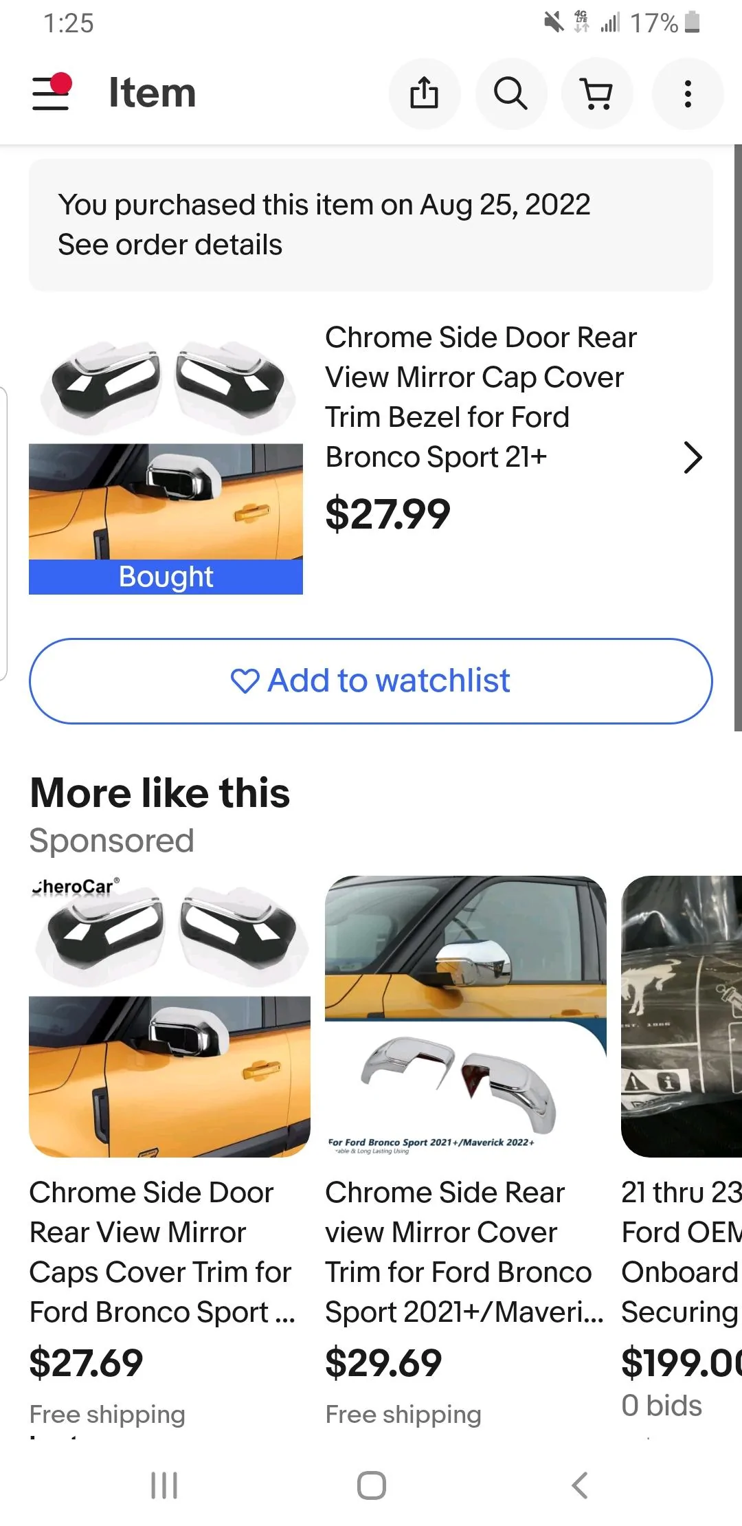

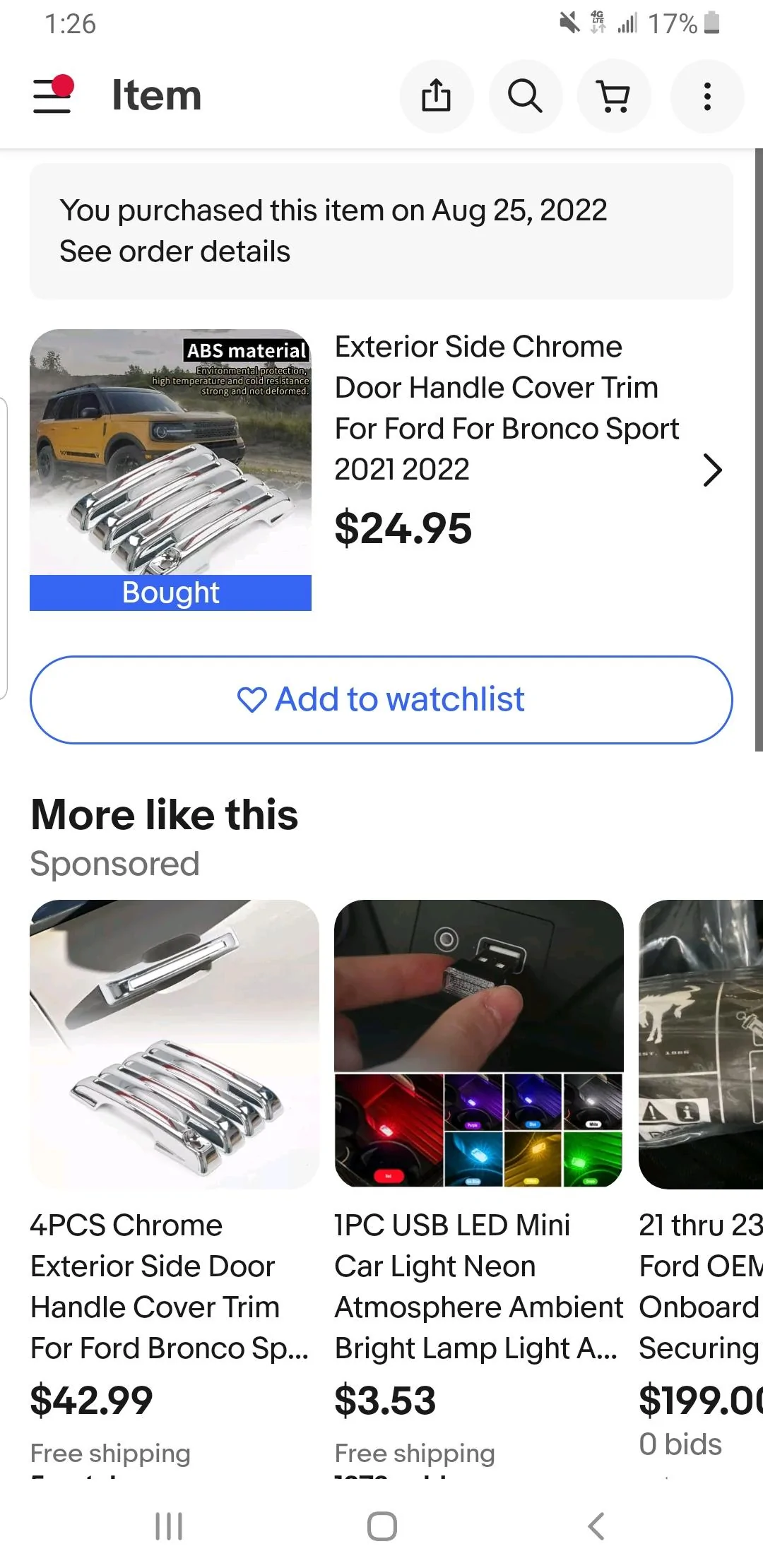

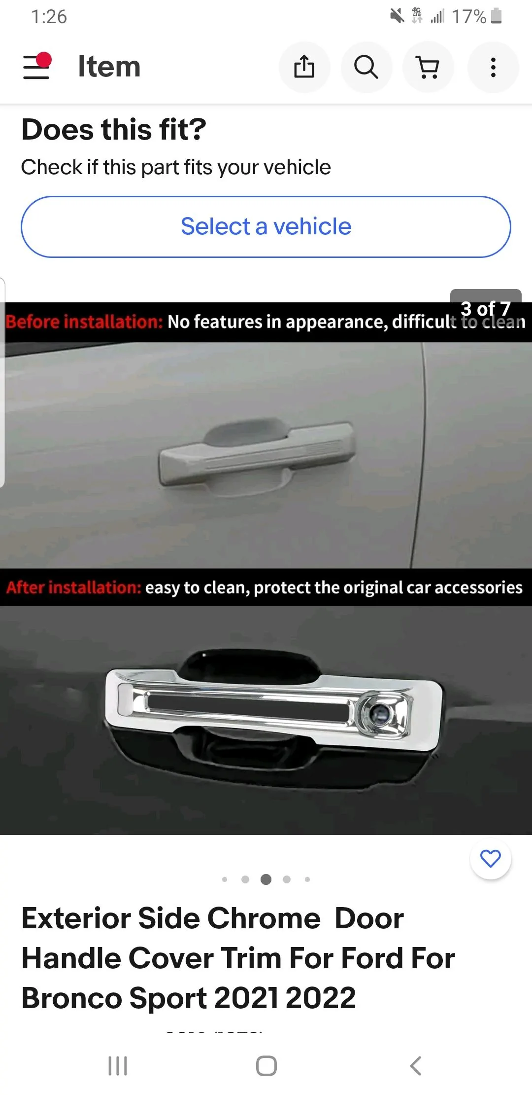

I bought the chromed bronco sport handle covers. I am planning to scuff these down, and epoxy primer them, then base coat, clear coat them in iconic silver. I also bought the chrome mirror covers and plan to do the same with them. The slotted hole in the center of the door handle covers I plan on putting white reflective tape on the handles before fitting the covers on over it.
I may tape these and the mirror covers in place and see how they look in chrome first before painting them. The prices were pretty inexpensive, and the chrome looks nice. They may look good as is instead of painting body color to look like every other maverick out there with the lux pak.
Tuffskinz makes these handle inserts in Iconic Silver, you may be able to apply these and then attach your painted handle cover over top. Although the reflective tape is a pretty cool idea too actually.

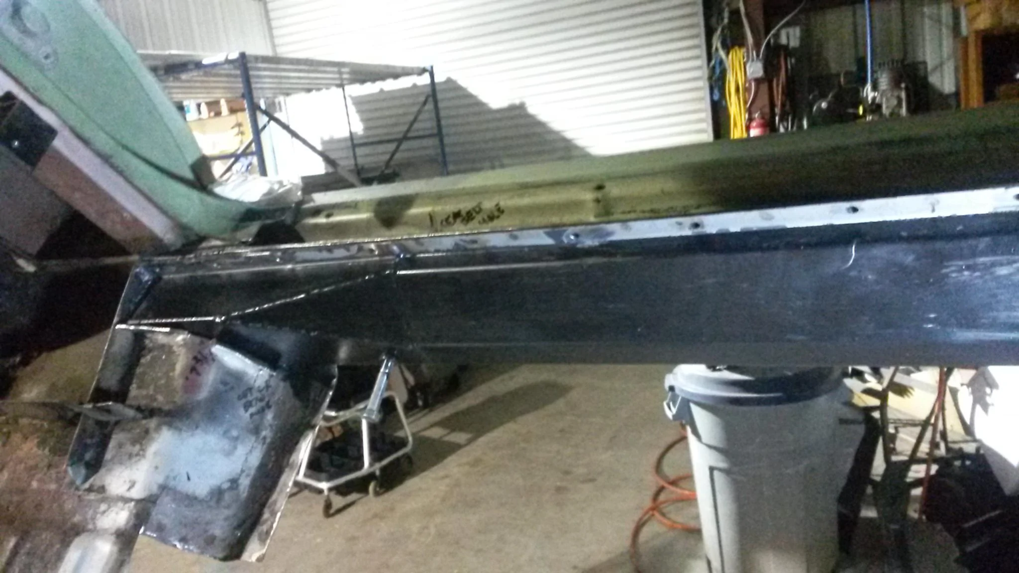

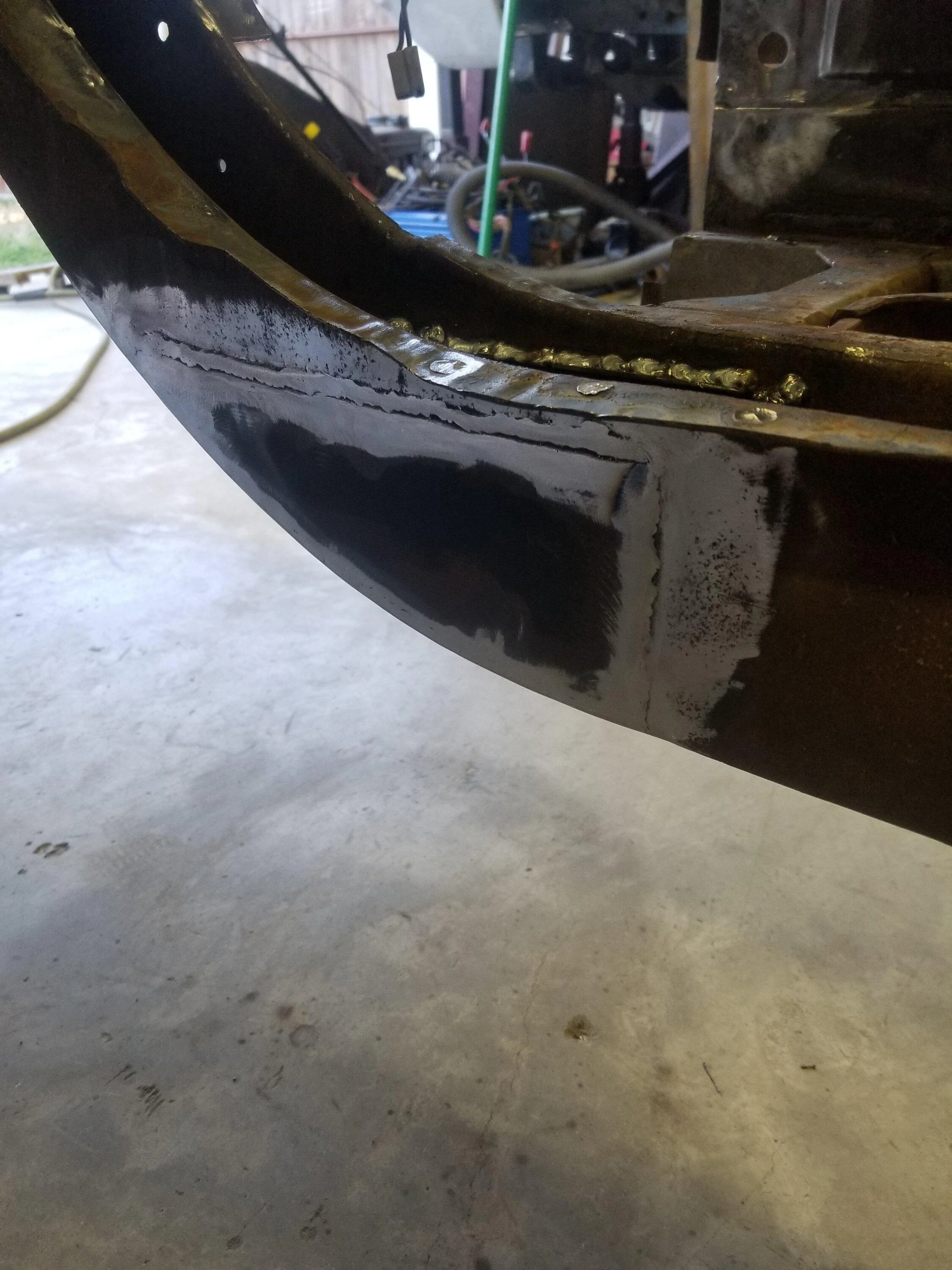

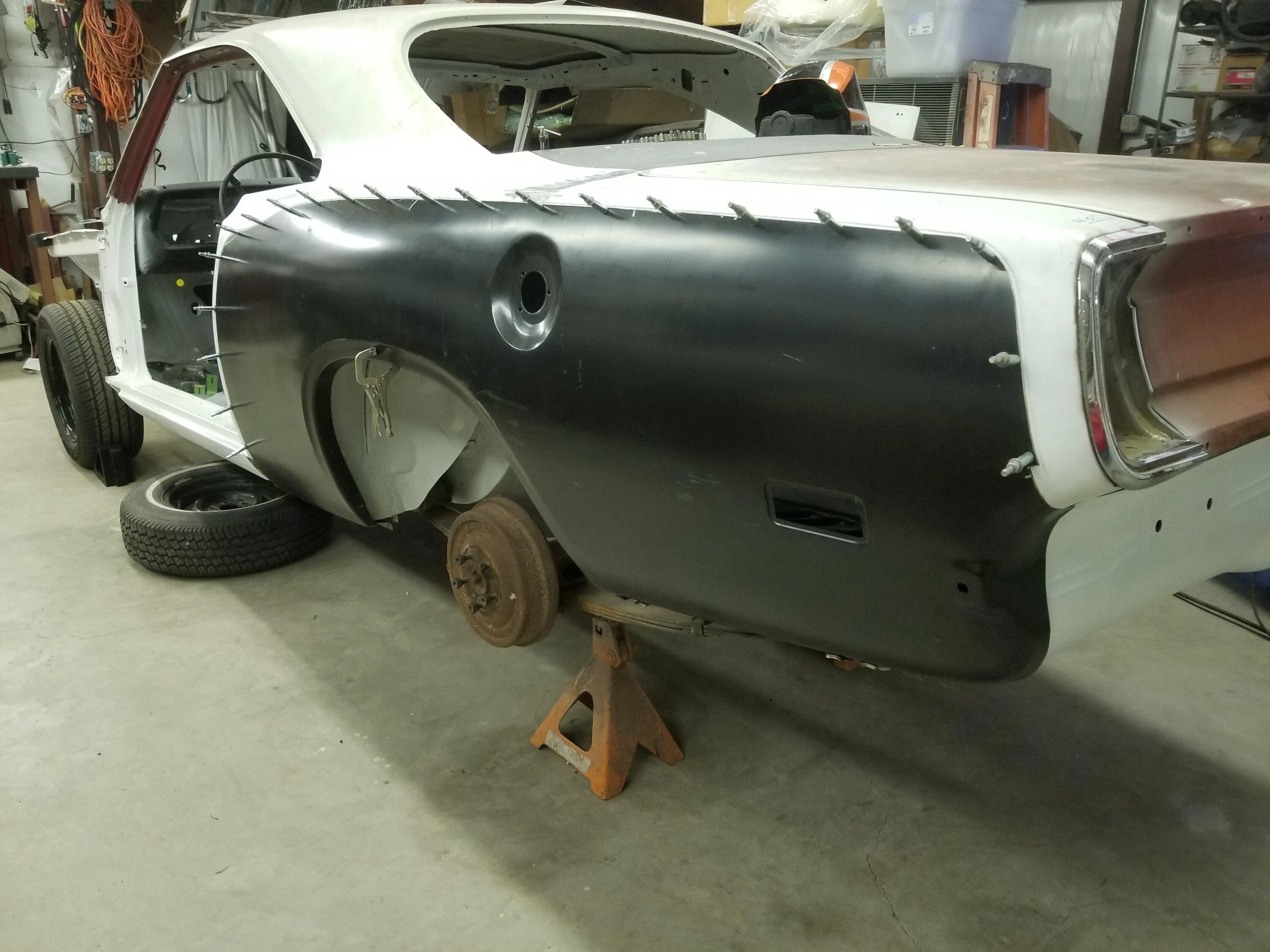

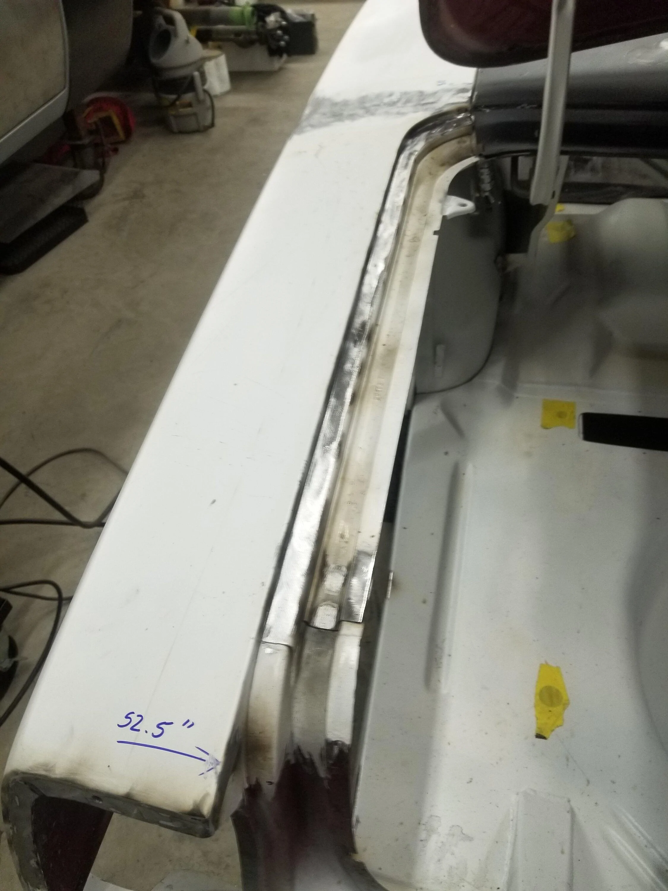

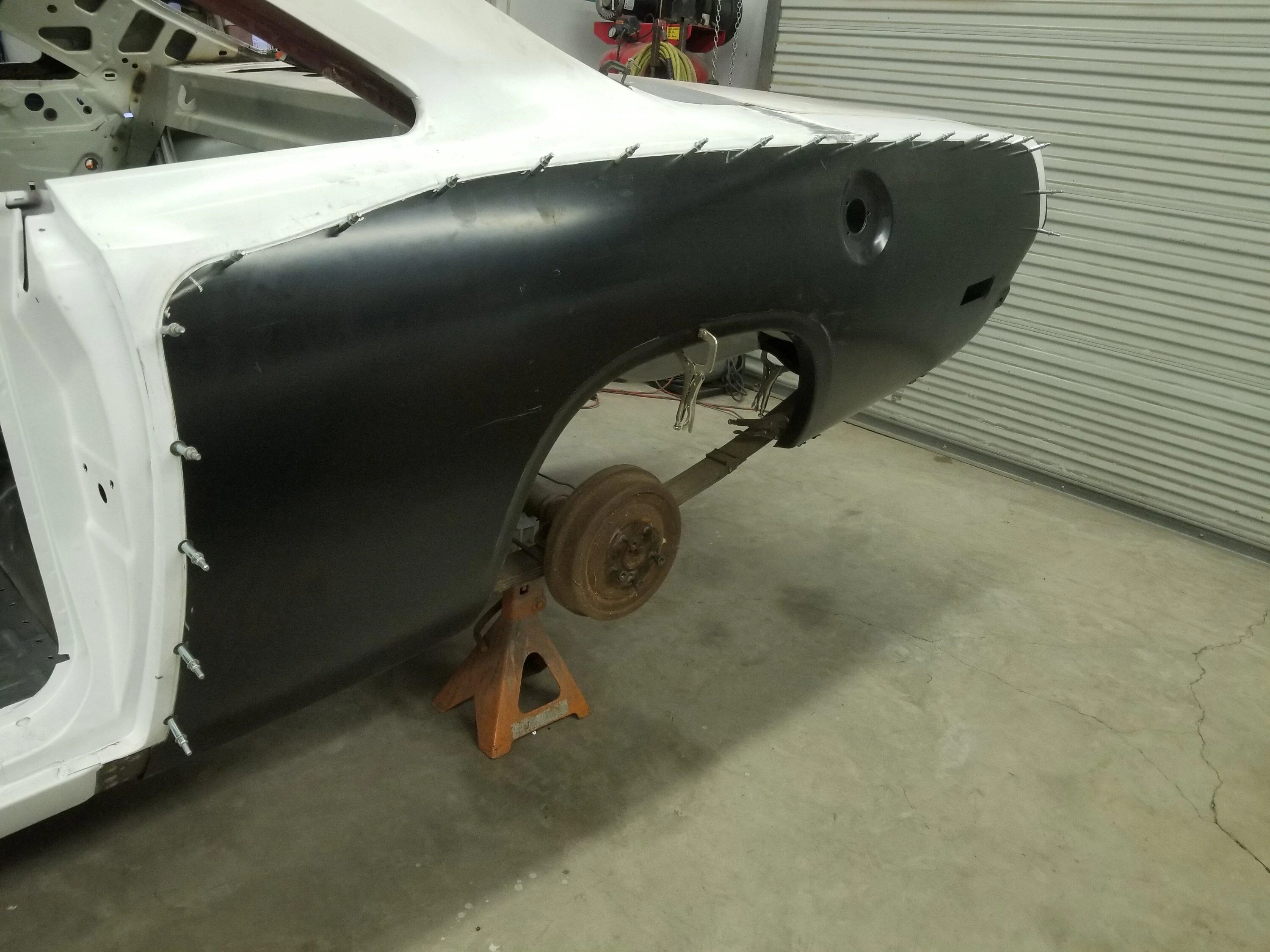

Heres a treat for ya. Goodmark quarter skins kinda suck. They dont fit well at the top, front, or back which is why the splicing, but they were pretty inexpensive. I had to reuse the tops of the original skins. Everything was rotted around the trunk opening. Required me to splice in rust free sections from a donor 69 barracuda back half. I used steel tubing to hold everything in alignment when I cut the car back end apart.

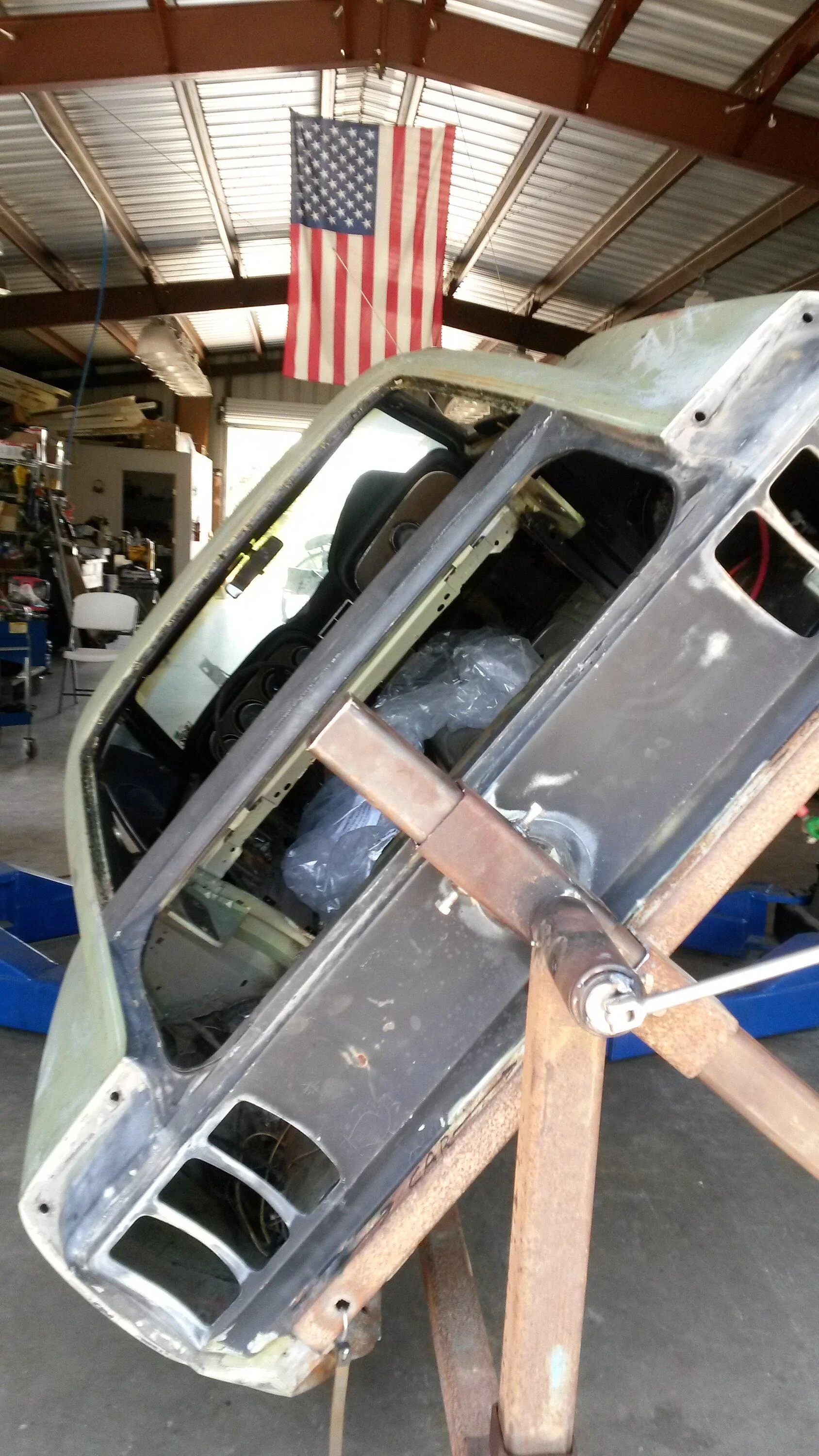

Damn dude, thats frigging awesome, I am doing a 1969 Mach 1 S code. I am doing the convertible inner rockers and h beam seat pedestals. I have mine on a rotisserie, doing a 3 link rear, double A arm, all coil overs, 4 wheel discs, restromod.
Scuffing is work. Thx for tips, love Cuda, thats a real one.

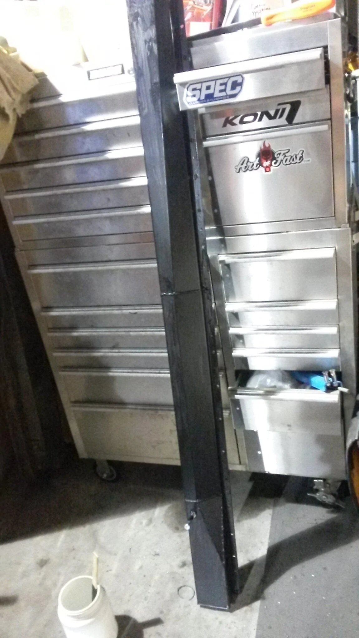

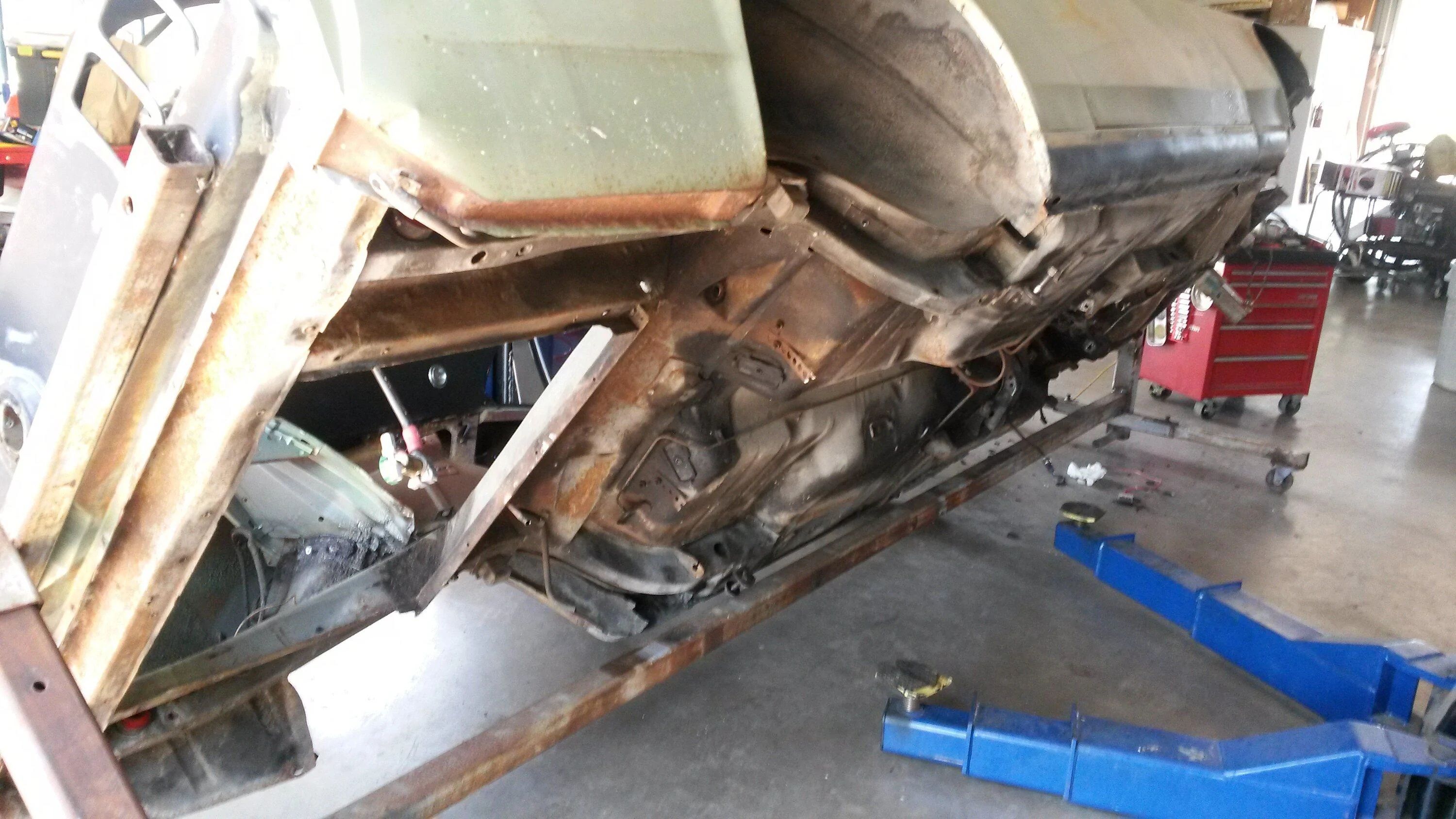

Heres mine, hope others dont mind, yeah the dealer sells handles already painted to match color.
Ford Maverick Color matched door handles? 20140707_120010
Ford Maverick Color matched door handles? 20140707_120046
Ford Maverick Color matched door handles? 20141122_181226
Ford Maverick Color matched door handles? 20141122_170229
Ford Maverick Color matched door handles? 20141101_181132
Ford Maverick Color matched door handles? 20140707_120101
Mach 1
Randy
Apr 10, 2022
638
533
Spicewood
2022 Maverick Lariat Hybrid sold 2024 mav hybrid 2018 F150 Lariat 3.5 ECO

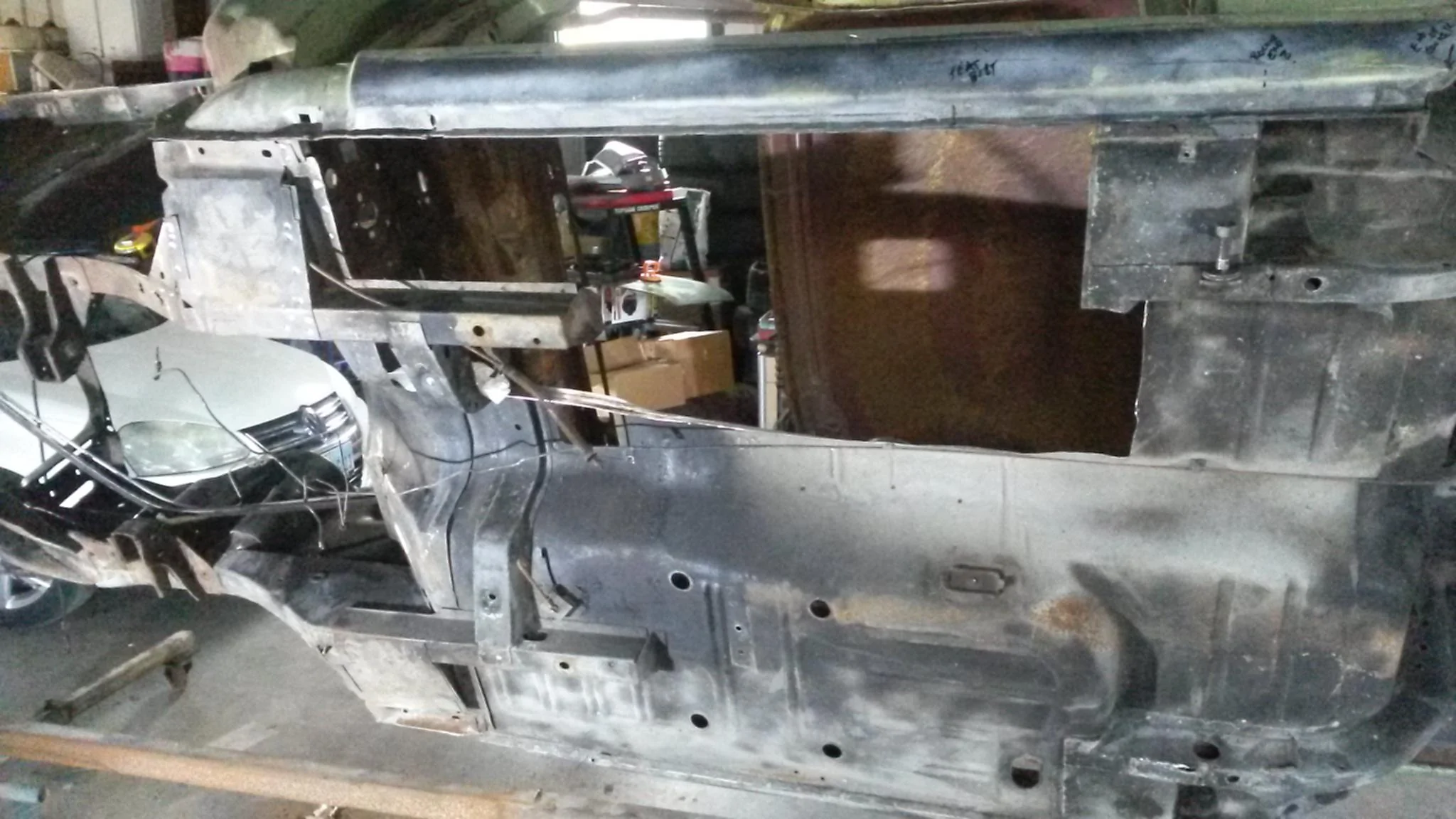

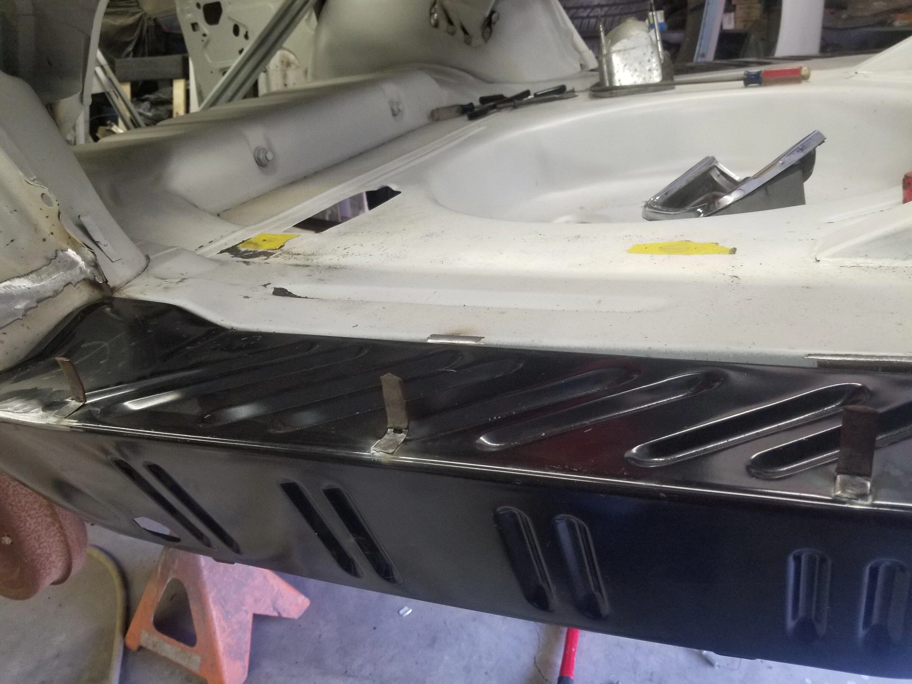

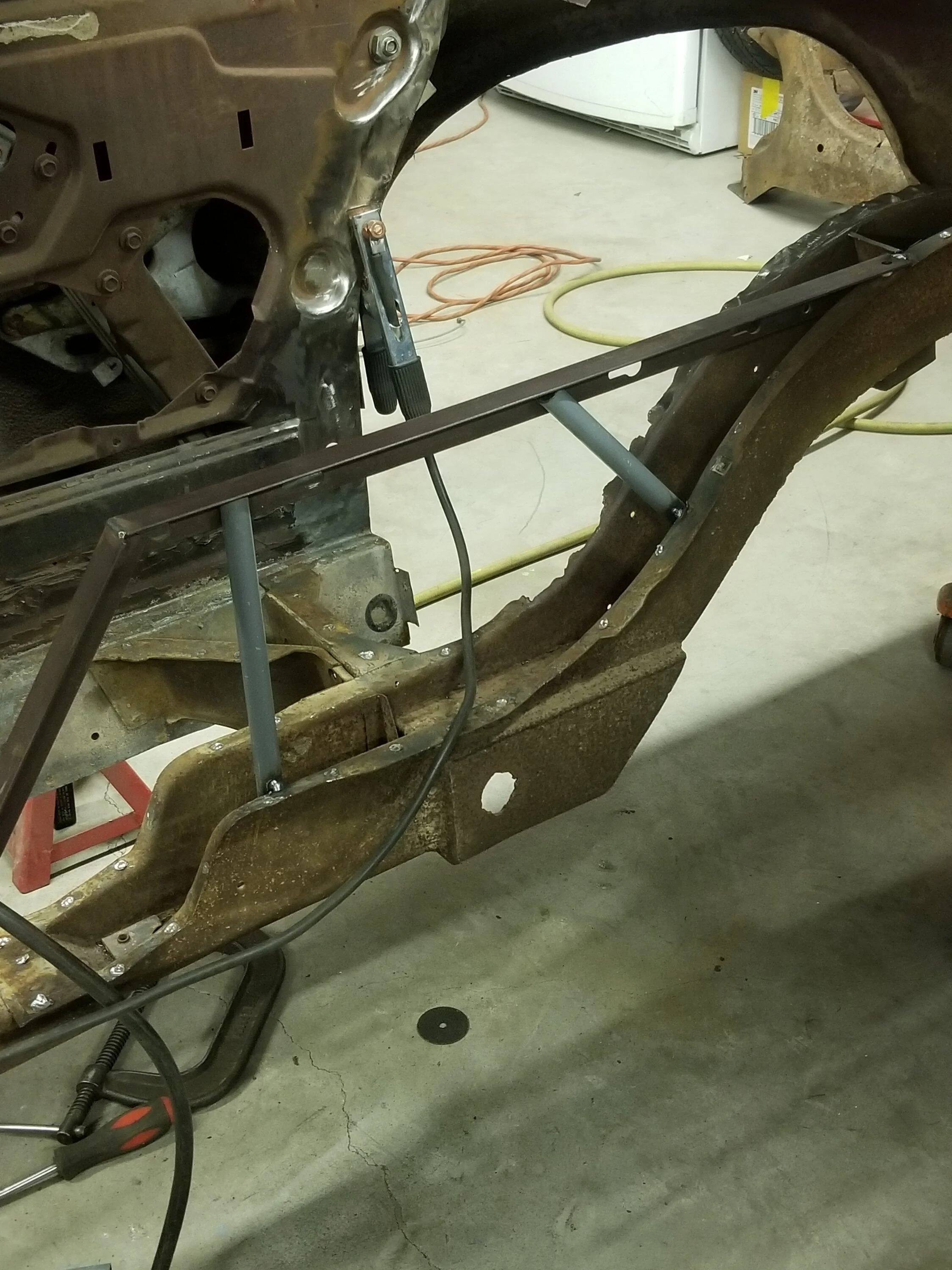

I think i counted no less then 30+ sheet metal panels to be replaced, i only had to replace drivers side floor, and toe board.
The frame rails are the convertible inner rockers.

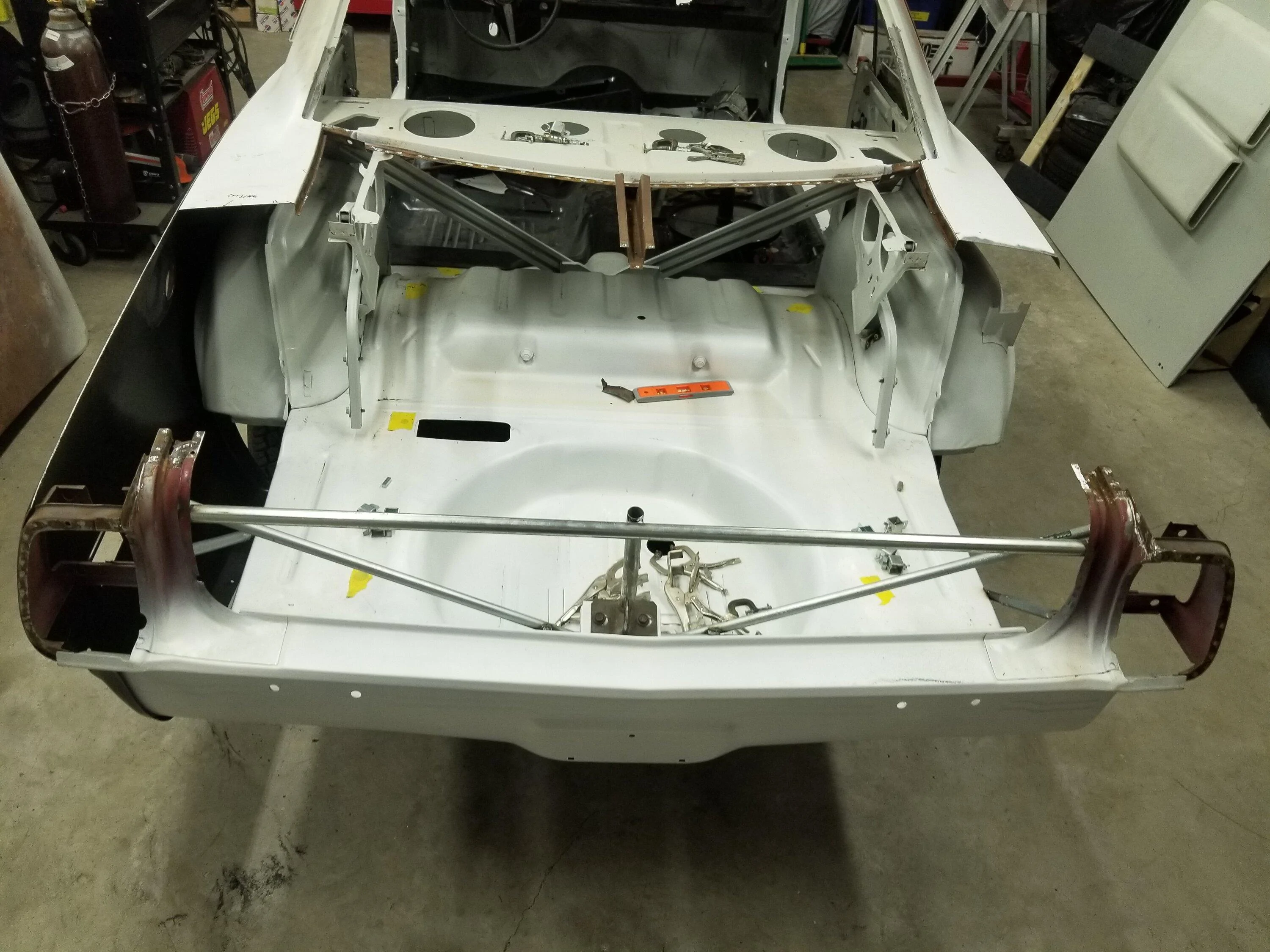

I have X frame that welds to subframe connectors. Still going back and forth if i need a roll cage?
Its fun, but a lot of time and dedication.

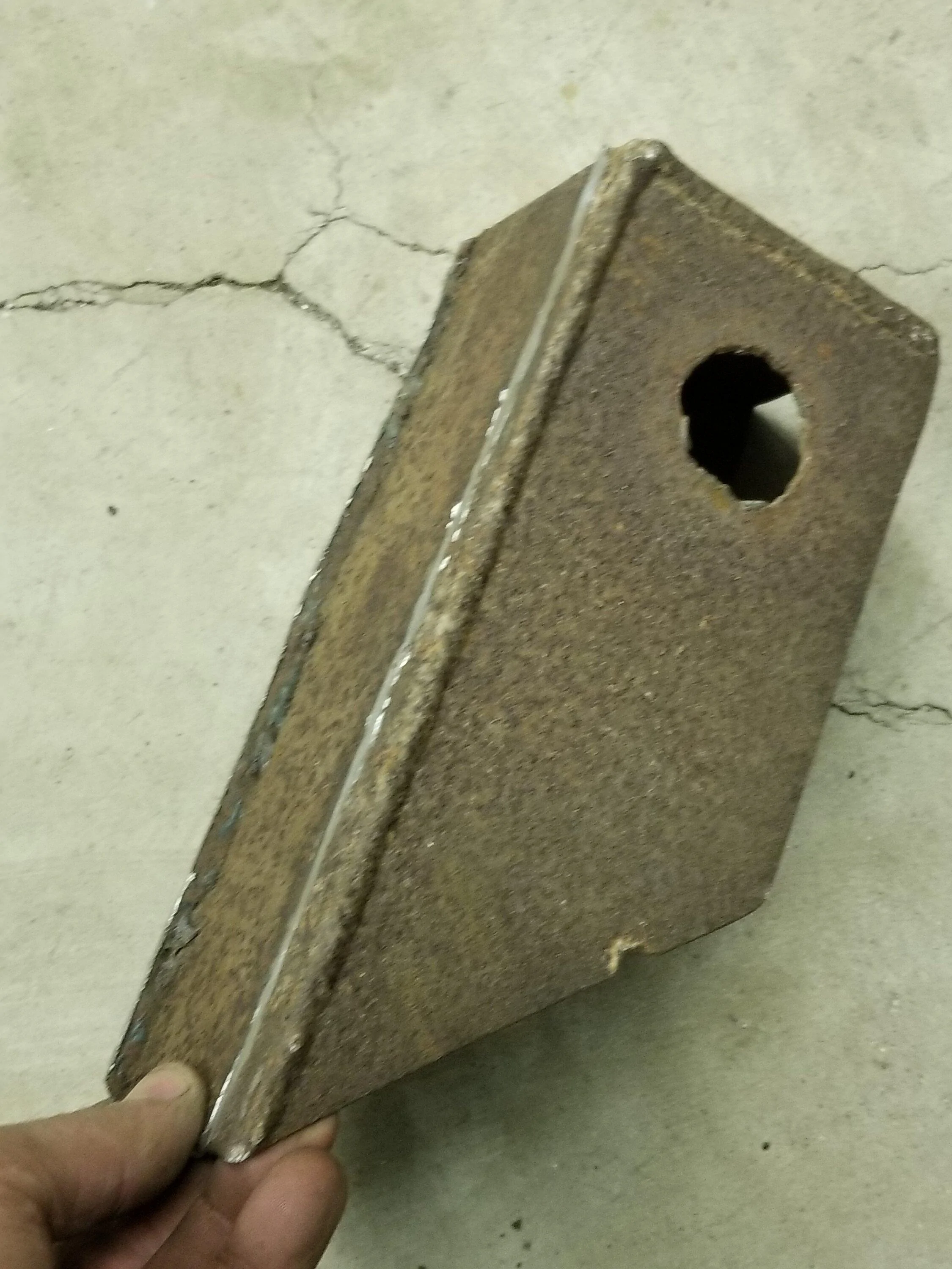

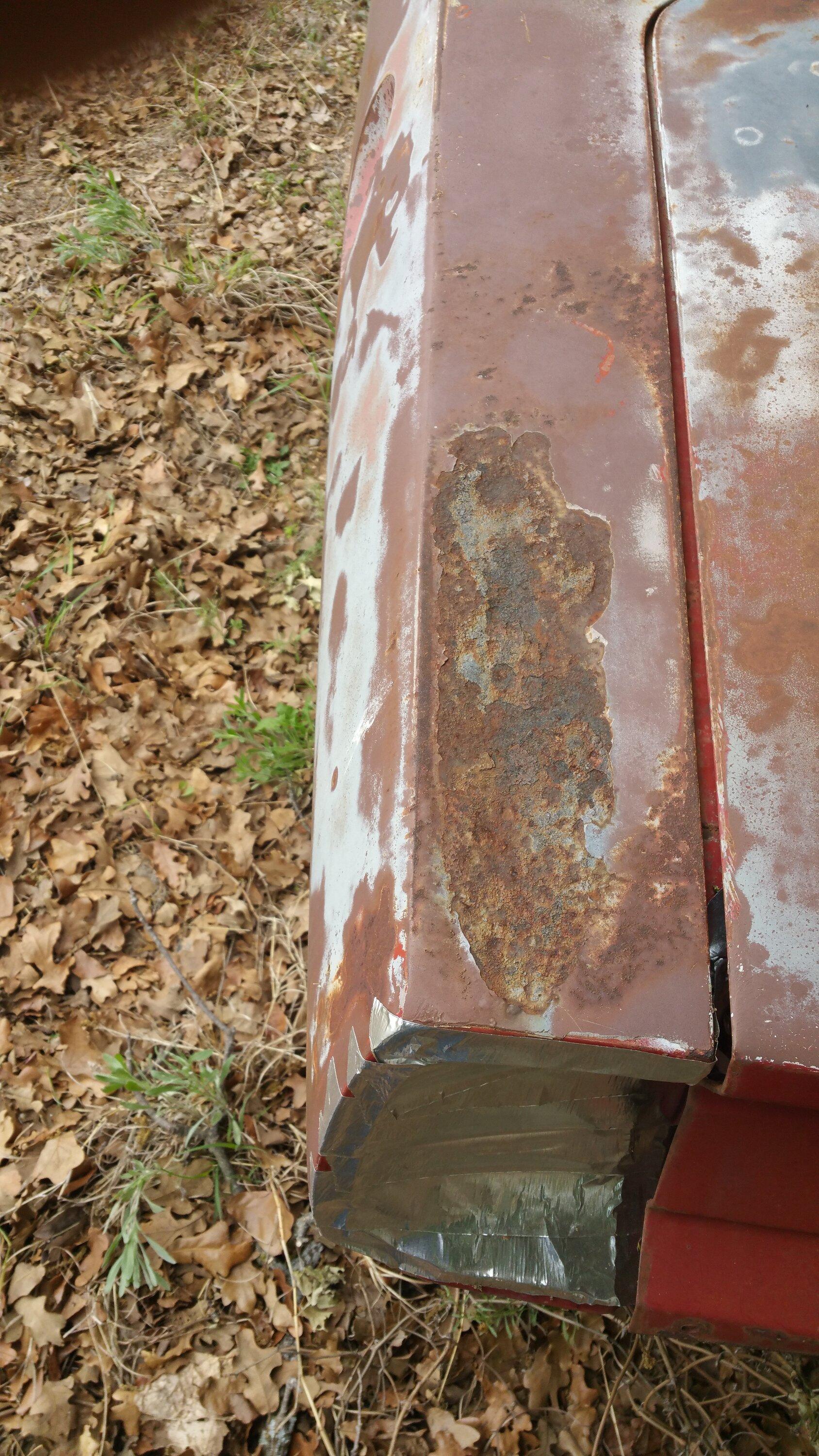

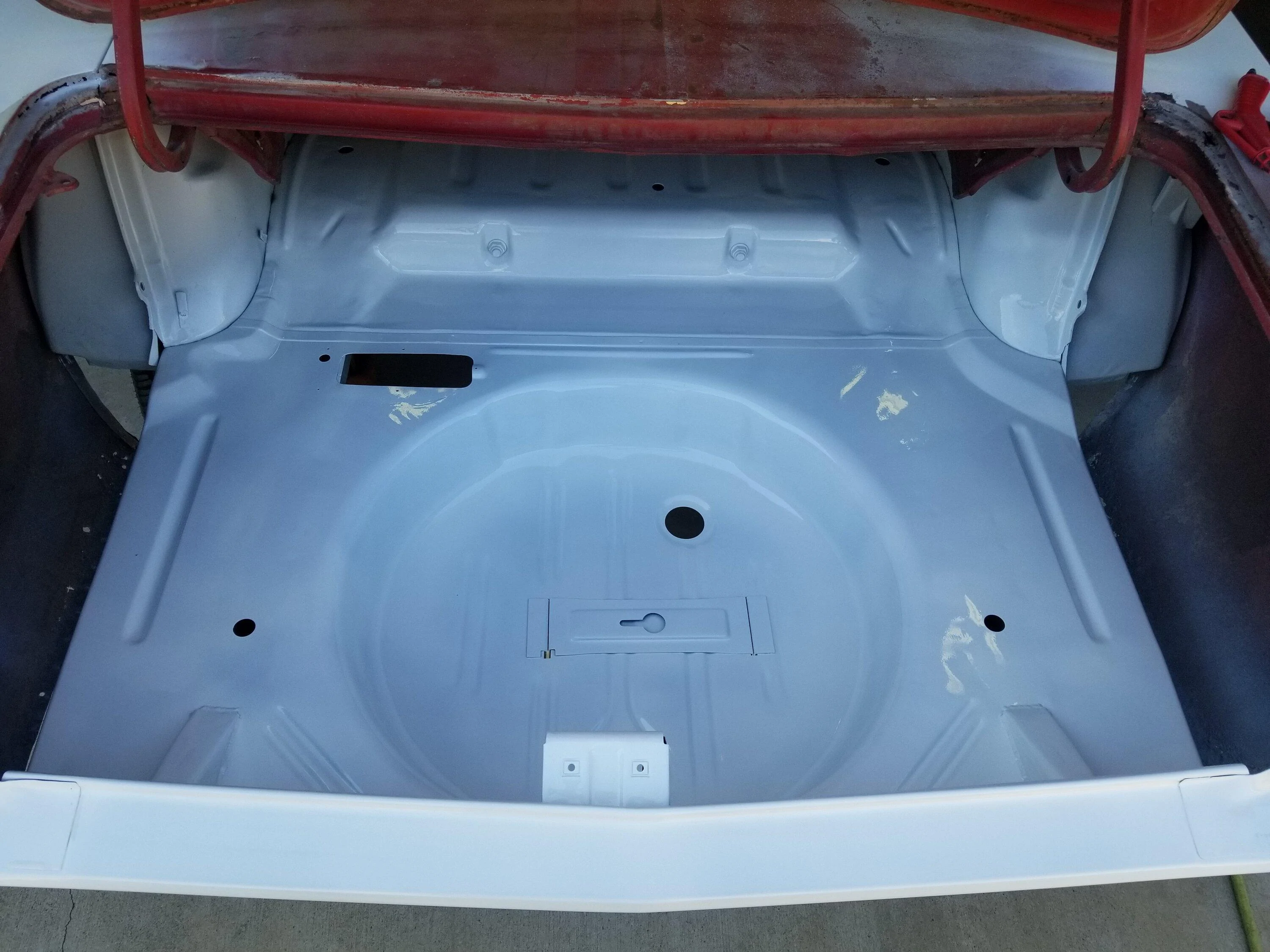

I love those!! My co worker has a 69 mach 1 with a 4 speed I love that body style. Thanks for the kudos. This type of work is time consuming to do it right especially when these cars are over 50 years old.

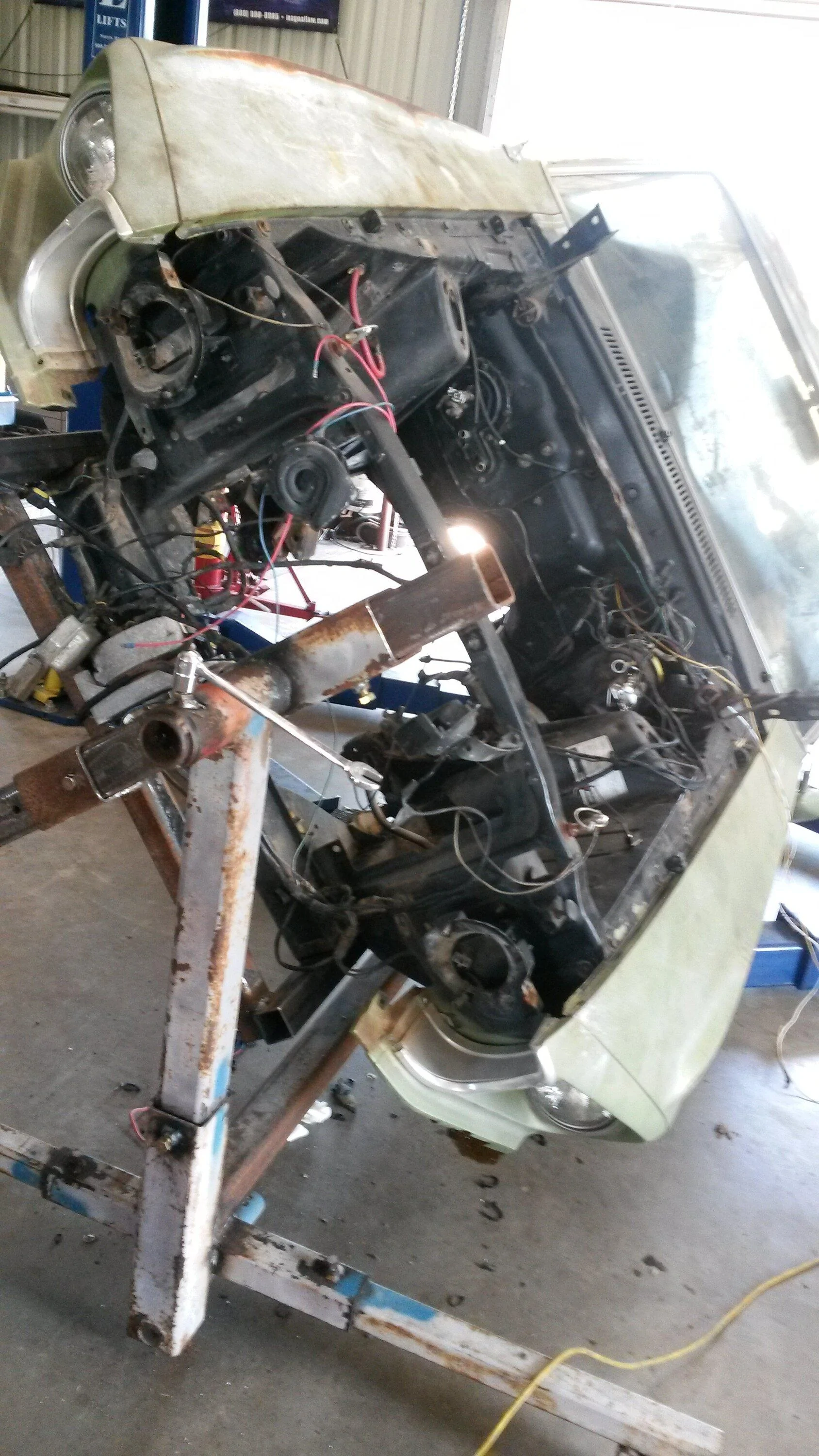

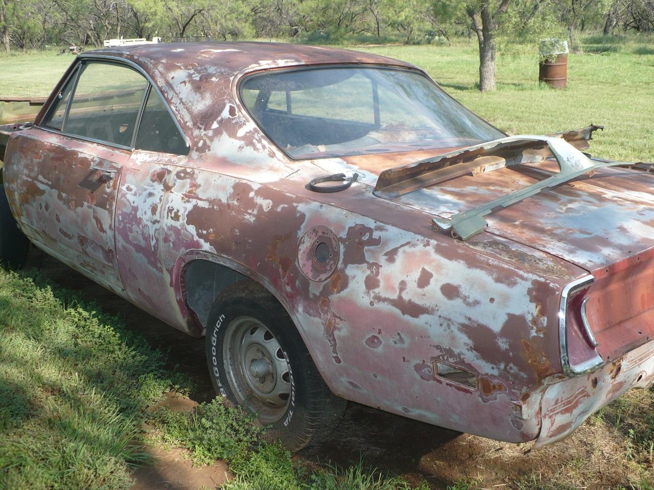

This cuda is a 69 340-S that somebody butchered into a drag car in the 1980s. By the time I got it, it was stripped and left for dead. It had a spring relocation done to it that was horrible, and the rear wheel houses hacked out with a sawsall and a torch to pop rivet in aluminum tubs. I have reversed all that.

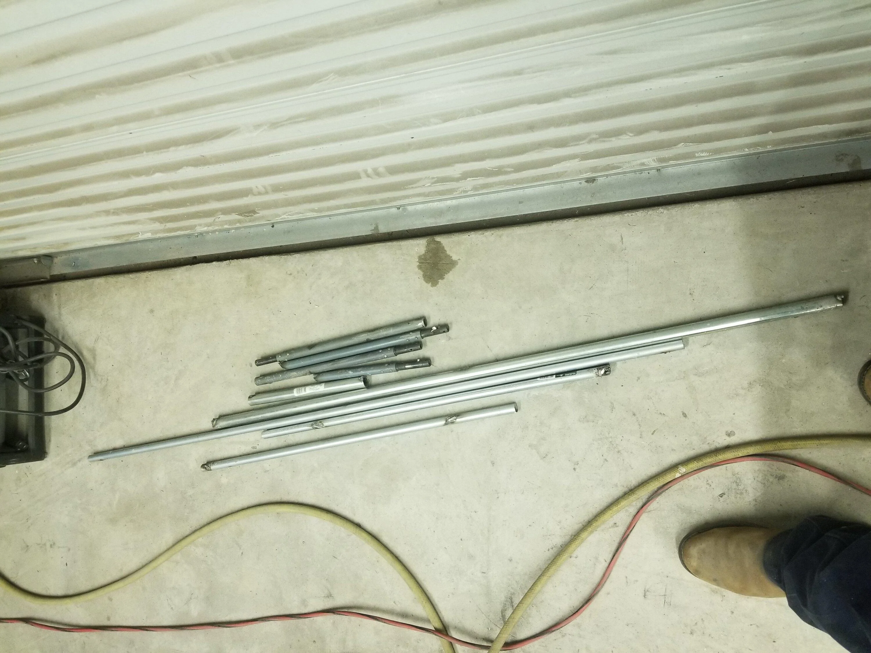

It had some horrible welded in 2" square tube sub frame connectors. I removed all that, and made nicer ones out of 2x3 boxed steel tube. I payed $300 for it as a roller. Heres some more pix of how far I drilled it apart because of butchery, and rust. I temporarily left the horrible connectors in place to hold whats left of the unibody together as I drilled everything off. I also temp braced the framerails so I could remove the relocated spring boxes. Then I fabricated new framerail sections and welded them in.
Since the data plate under the hood was missing I cannot restore it since nothing on it can be verified as such. The only thing that can verify it is the Vin#. I mean I could restore it, but again no data plate to verify any options. As such it was a nicely equipped car when new.
