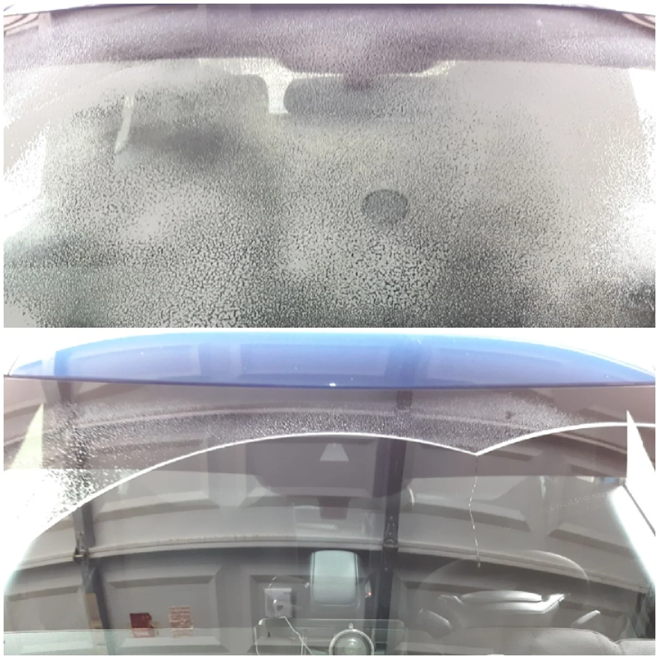

Clean your camera on the window behind the rearview mirror and or the sensors along the bumper. I had that once and after I cleaned everything it went away
Hopefully, if the OP's windshield wipers are the correct size. They will automatically wipe the camera area with each pass.
Ford Maverick Collision Assist Unavailable (Dash Warning) 20260421_092449
I'm not referring to the active cruise control sensor in the grill.
