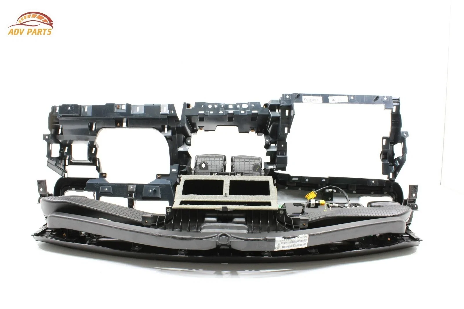

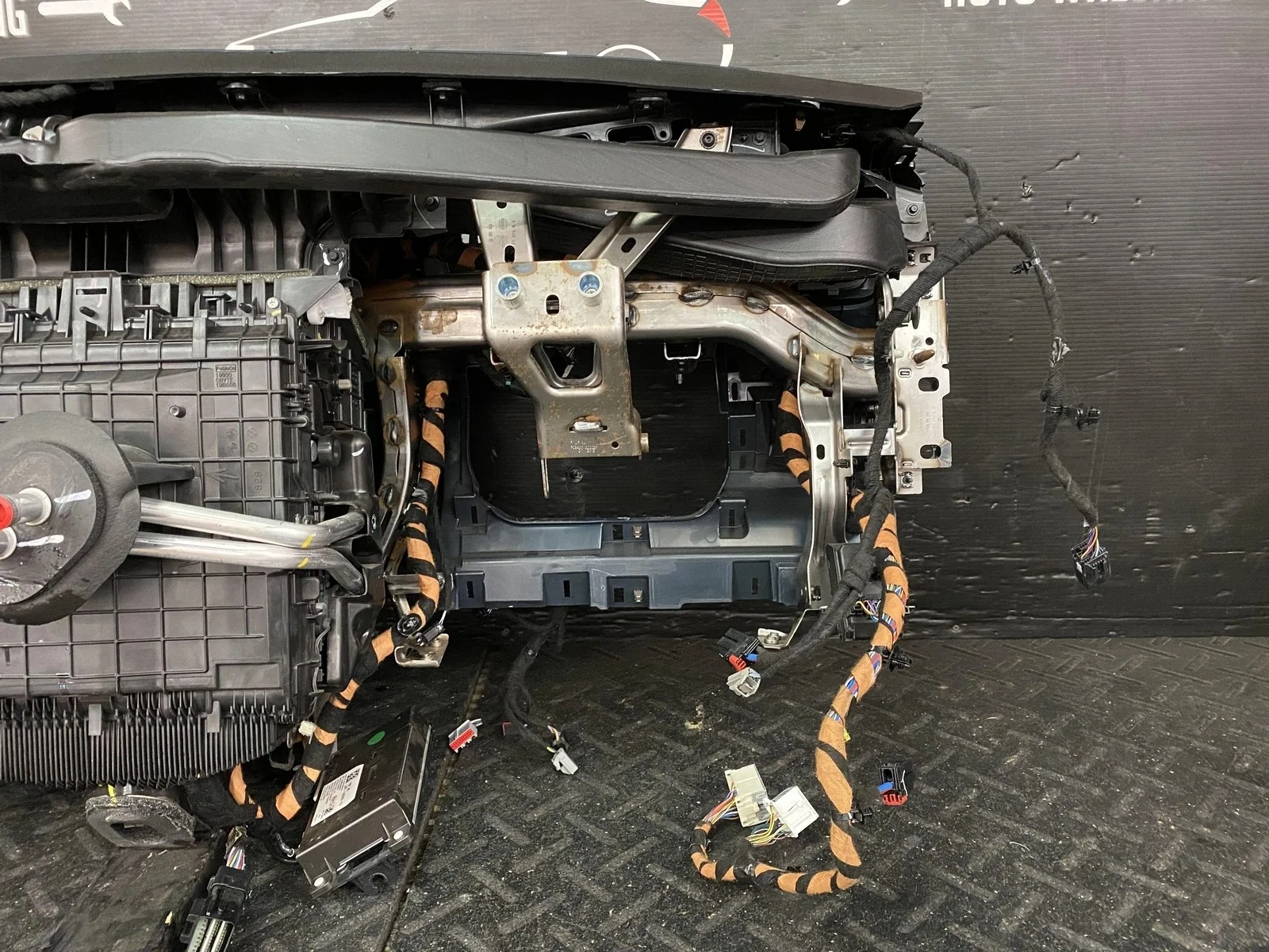

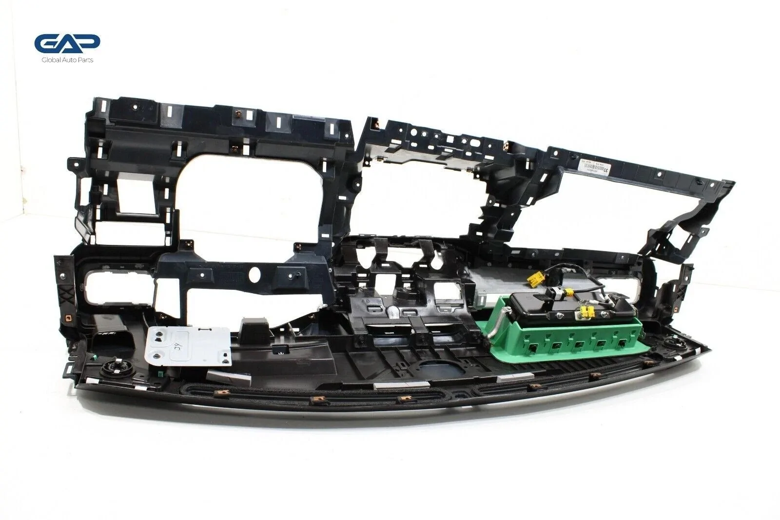

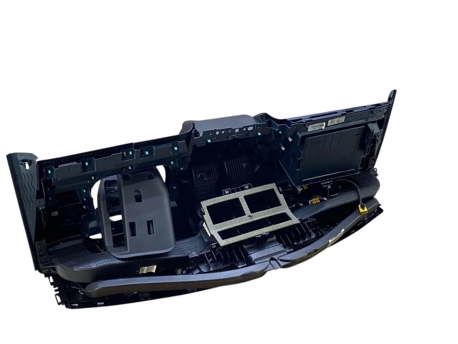

I believe almost every Maverick has this same dash pop. It has something to do with contact between the upper dash and the defroster vent. The Ford TSB for dash rattle won't fix it. I had the TSB done and the dash still pops.
I have found photos from eBay listings of used dashboards to be the most helpful in trying to determine where it is coming from and a possible fix. Most likely just a block of firm plastic foam jammed in the right spot. You can reach almost everywhere by just removing the steering wheel shroud.
That being said I haven't found the sweet spot yet. Someday I will and that day will be a glorious day lol.

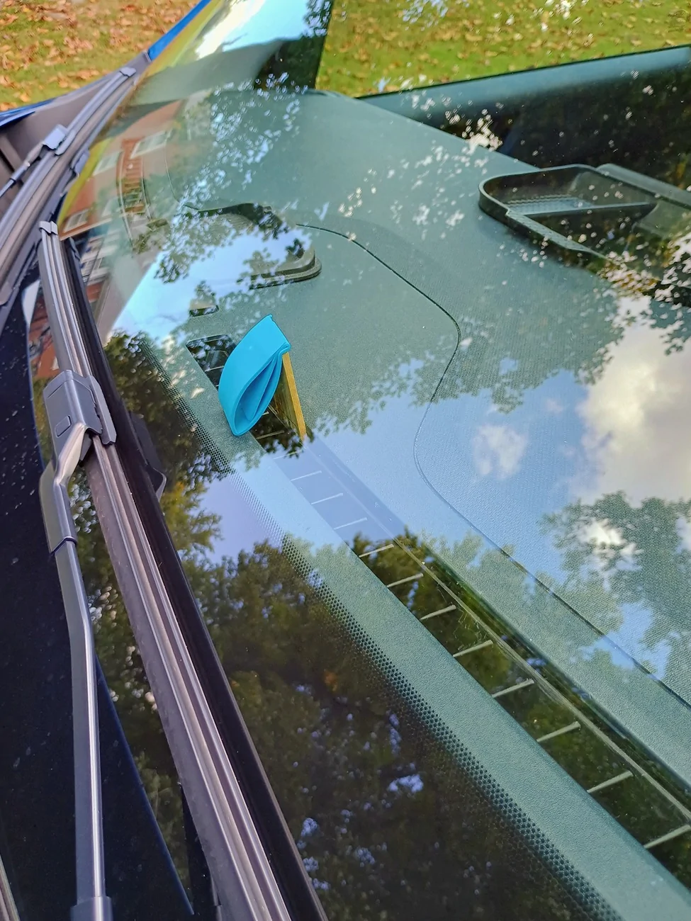

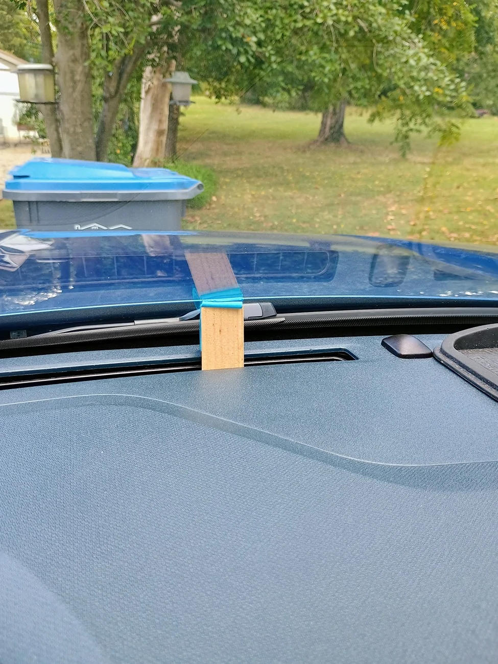

This is how I fix mine. I cut a piece of a paint stir about two and a half to 3 in long and stuck it between the dash and the left side defroster vent in the channel there. The paint stir needs to be long enough to touch the windshield. This will hold the wooden piece in place
Ford Maverick noise in the dashboard IMG_20250903_145518957_HDR_AE
Ford Maverick noise in the dashboard IMG_20250903_145534079_HDR_AE
and then I put a piece of foam between the windshield and the piece of wood to keep the wood from making noises against the windshield

That's the best fix I've been able to come up with you hardly notice the piece of wood after a while but you enjoy the quiet of the dash not making that sound

Mas por que você adicionou a espuma? Só para evitar tocar no vidro? Explique de novo.
A parte de madeira que se encaixa na saída de ar exerce alguma pressão?
Potatman
Bruce
Feb 9, 2023
84
115
Kentucky
Escape
At first I had a matchbook there with a picture of a Holiday inn sign but after a while it wouldn't stand up too much pressure on it if it had been long enough to reach the windshield I would have used it
