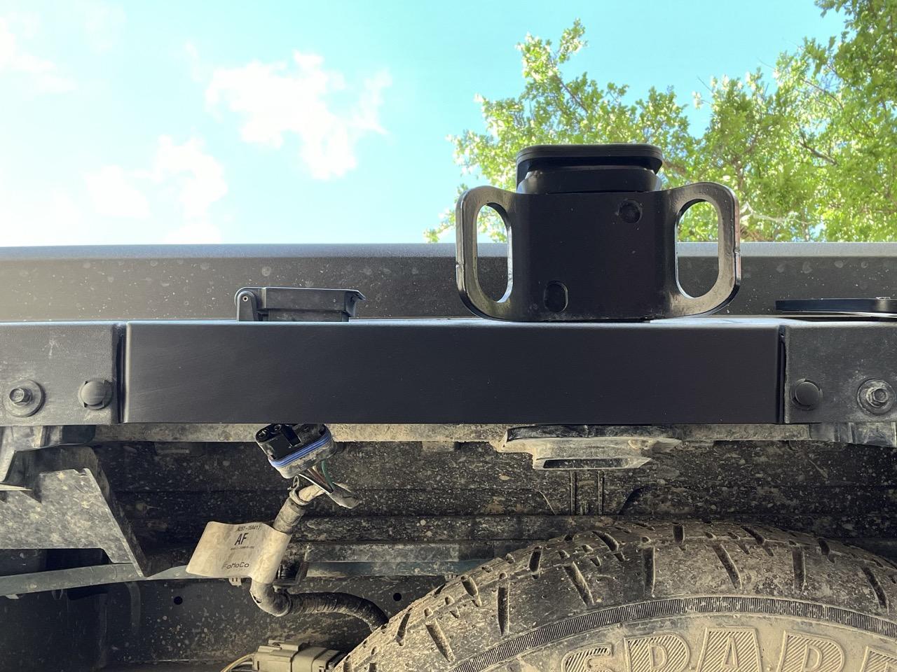

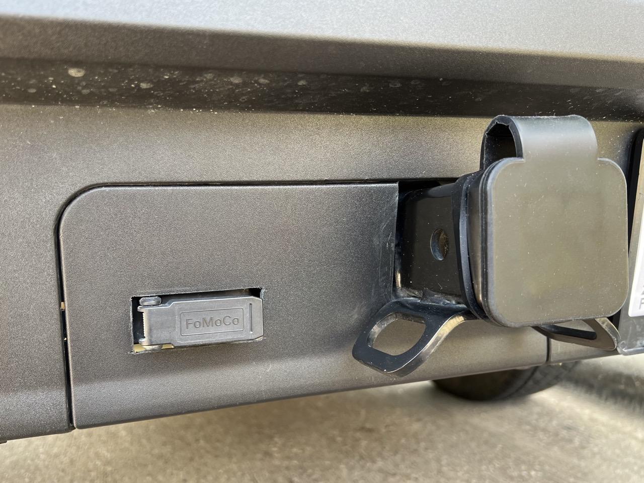

@Don806 I was gonna bump this thread yesterday to say THANKS for your dimensions several pages back! I did this mod yesterday and am happy to say it worked out fine. If anything, I could have tightened up the cut for the 4-pin connector, but I was more worried about neatness than tolerance.
All the key takeaways have been mentioned in the previous 7+ pages... Removing the 4-pin connector was helpful. As was pulling out a couple of fender screws either side of the hitch area.
The only tweak I can add is that I used some plastic push clips I had laying around for the two holes on the bottom. I had to rout out the holes in the trim piece and the fender a tiny bit. Looks 100% OEM except for my cutting. All in all, a great cosmetic mod for less than $30.
Ford Maverick Clean up area around the trailer hitch IMG_4588 Lar
Ford Maverick Clean up area around the trailer hitch IMG_4589 Lar
Edit: went out and took these pics, and looks like I never plugged the trailer connector back in yesterday. Oops. :p

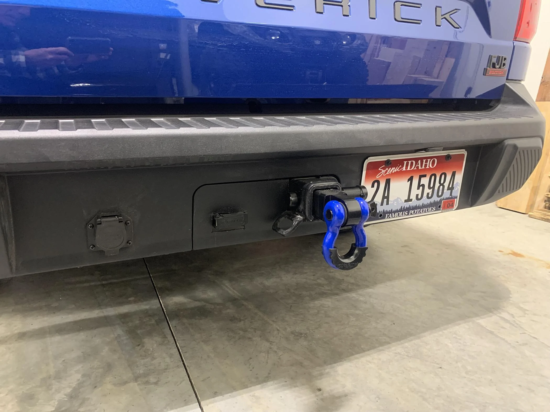

That is a nice, clean install! I did mine a few months back, got the part with Ford Pass points and got to cutting. A little too large on my bottom cut around the 4 -pin, but it is what it is and doesn't look too horrible. I had a spare 7-pin laying around and out it on. Had to mount it where it is at because of the plastic bracing on the backside was in the way everywhere else. I sometimes pull small trailers that have 7-p
Ford Maverick Clean up area around the trailer hitch IMG_4235
in and do not like those adapters. Just one more thing to fall out / go wrong. Looks like things are scratched, but no, just a dirty little truck in need of a bath!

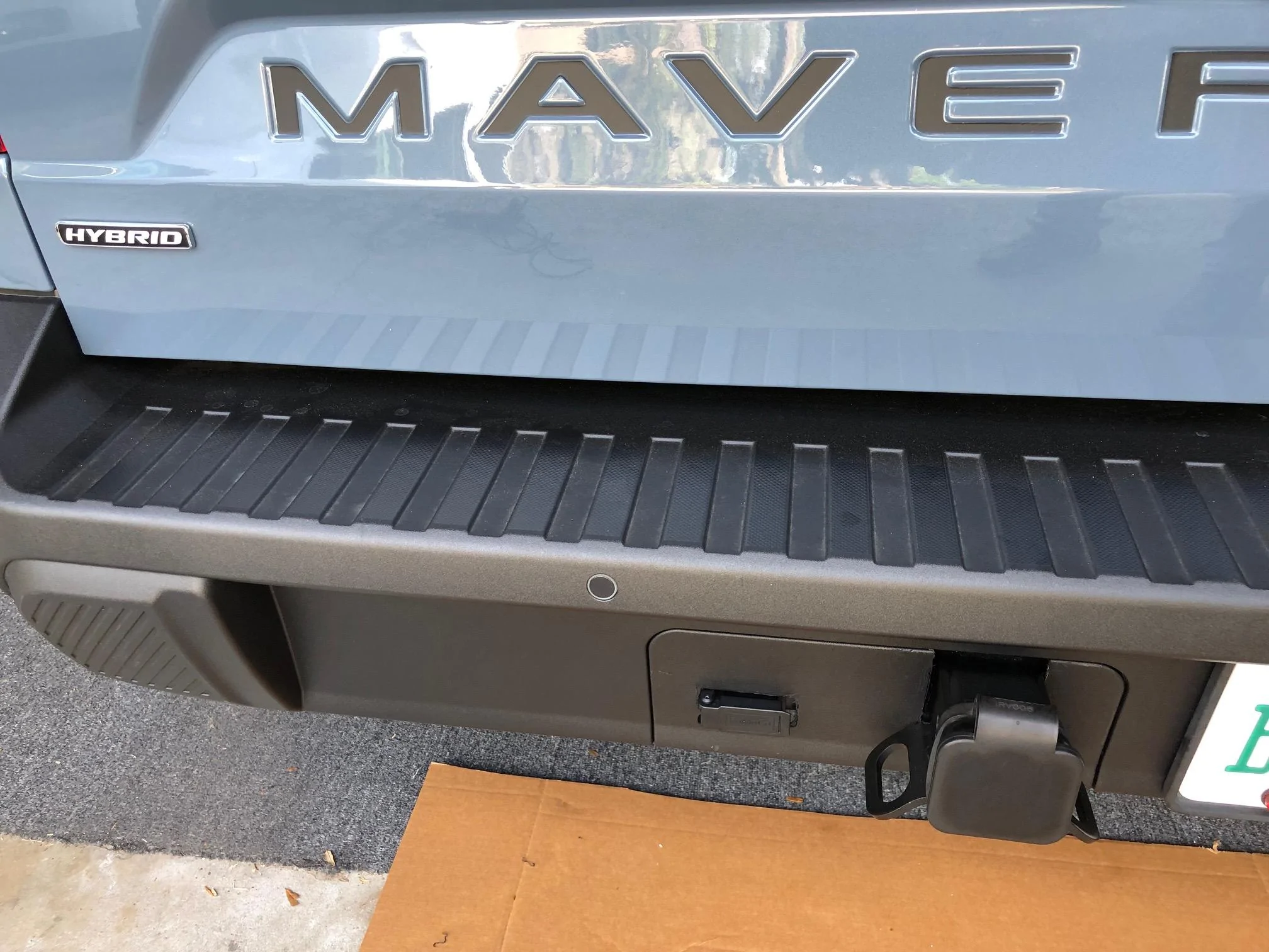

Thank you to all who have provided part#, measurements, experiences, & photos. I completed mine today. I'm sure the 90 degree temp helped with part flexibility. My dremel skills certainly are not what they used to be (I'm nearing 81), but it isn't too bad. It looks a bit more "finished" now. Bottom is secured with plastic push pins.
Ford Maverick Clean up area around the trailer hitch IMG_1767
Ford Maverick Clean up area around the trailer hitch IMG_1766
Ford Maverick Clean up area around the trailer hitch IMG_1764
