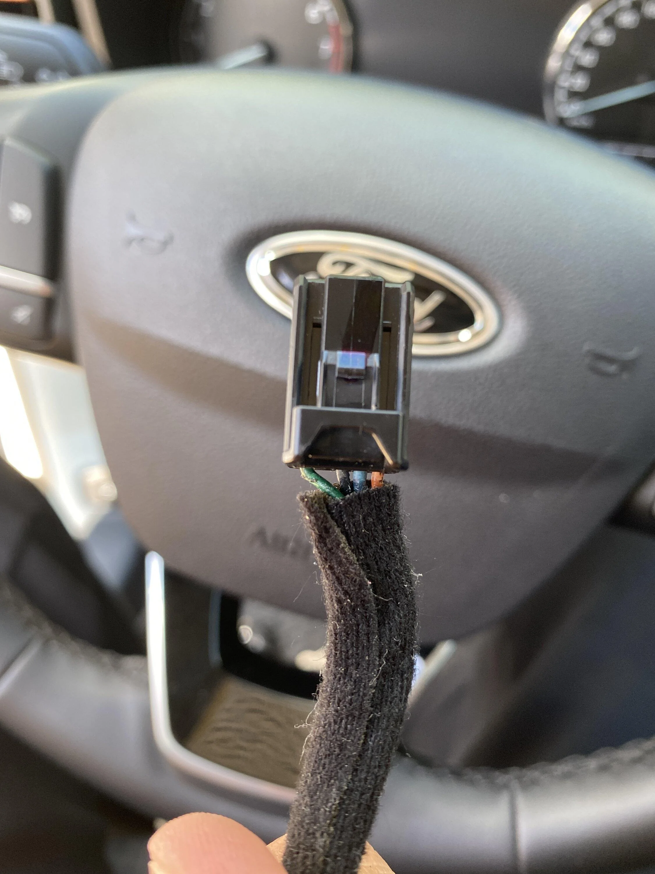

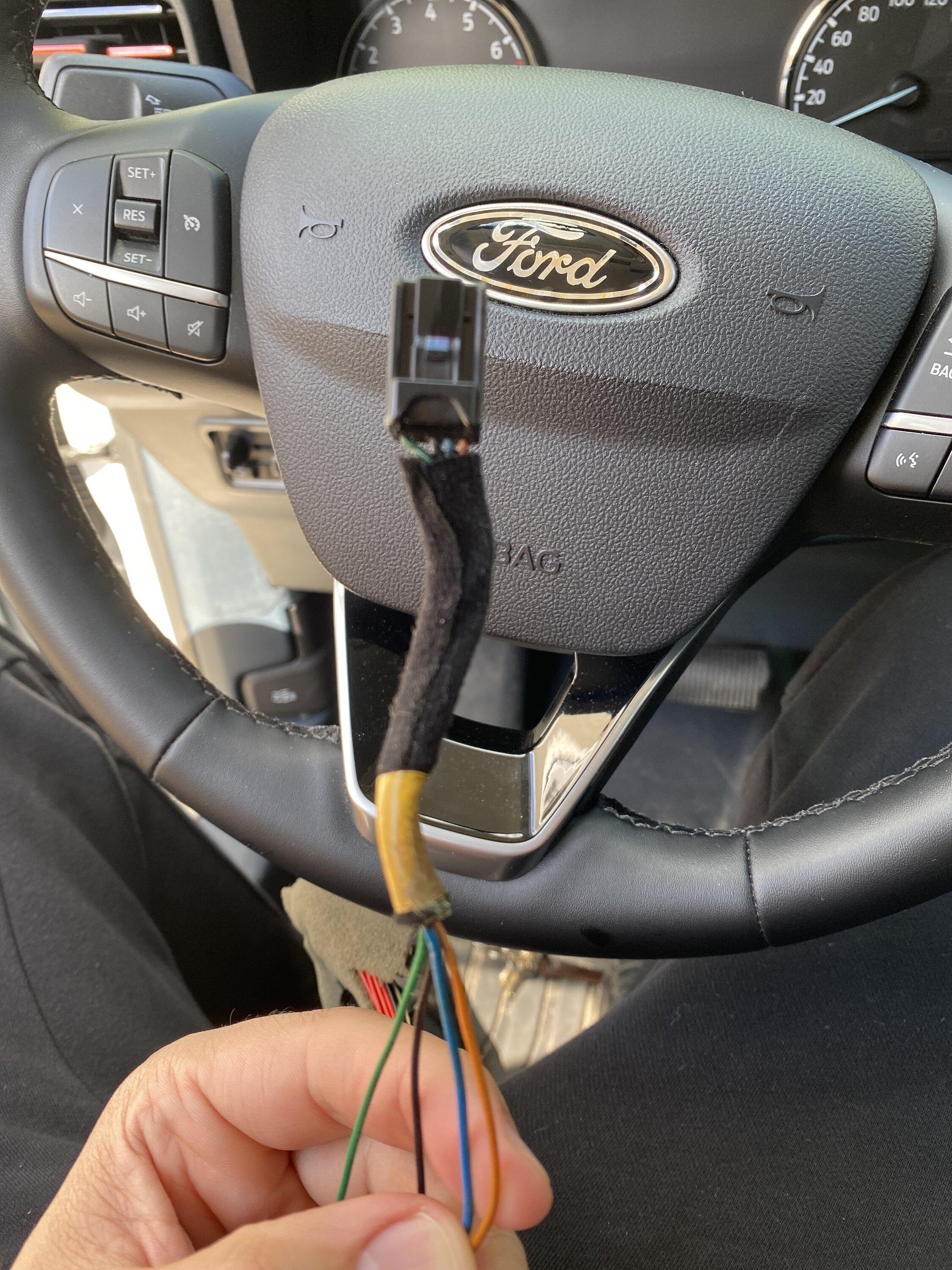

I’m looking to install this today. I’ve read previous posts but most have 3 wires. I’ve seen others had 4 wires but different colours. Can someone steer me in the right direction here?
Thanks

Still waiting to see if somebody can give me some help with the 4 wire connector. As a previous poster had 4 different colored wires than i do.
I'm thinking the following:
Black - in the mirror harness will be my ground of course (splice into the black wire of the harness)
Green - Constant 12v (homelink) (splice into yellow wire of the harness)
Blue - Intermittent 12v ( splice into purple wire of the harness)
Am i thinking this right? or is my wiring mixed up??
Just guessing here, but i would make assumption that black is the ground. Others not sure. I think you might be able to test different wires by connecting them to 9v battery and see what happens.
would be good of you to post results back here along with model number of mirror you purchased. .
