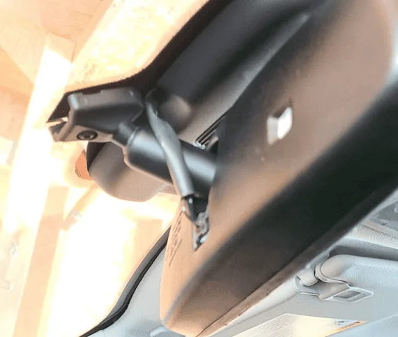

  1. Bought a Gentex-453 from ebay~$40 (Autodim & 3button Homelink & Compass)
    • Any 'Make' works it doesn't matter if its a Kia, Subaru, Nissan, Honda, etc... just get one that has wires
    • I got one with the orange compass to match the orange trim accents.
    • Glass is almost identical size as OEM, the frame is a little thicker is all.
  2. Bought a few Quick Splice (18-22awg), needed 3.
  3. Removed old mirror
    • Torx screw secures it to window, loosen but don't need to remove.
    • Then slide mirror UP towards the roof off the clip on the window.

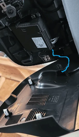

  4. Pop off the Camera trim by just grabbing it and pulling it away from the window.
    1. It is leashed (~3-5" plastic cord highlighted blue in pic) so it'll just dangle there once you've popped it off:

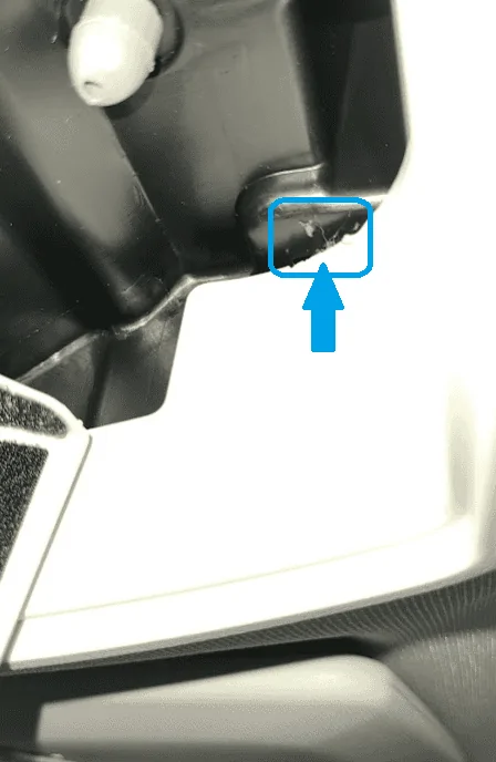

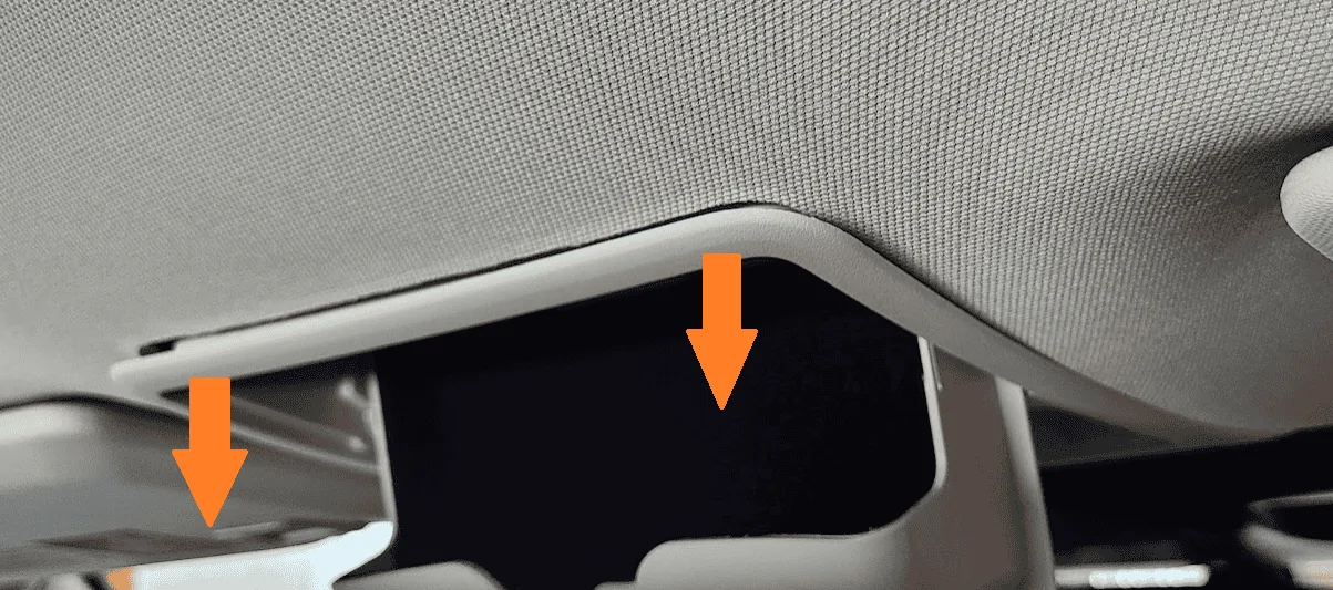

  5. Pull the Dome trim with these super easy pro tips- No Trim Puller needed:
    • Open the sunglasses holder
    • Grab a flat head screwdriver
    • Pry trim away from the black in this area on both sides:
    • Pry it enough that you can grab the trim from outside and gently pull down:
    • As noted in several other posts the trim tips down and the front has posts that can break, so be careful!

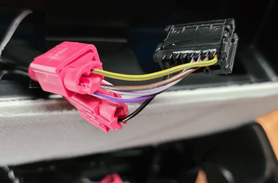

  6. Gentex-453 is 3wire: Hot (always on), Ignition (key in On), Ground
    • The area is tight and I didn't want to have things rattling around so I used the Ignition wire from the camera (purple with a stripe):
    • Used Hot (yellow with green stripe) and Ground (black with a stripe) from the dome light connector:

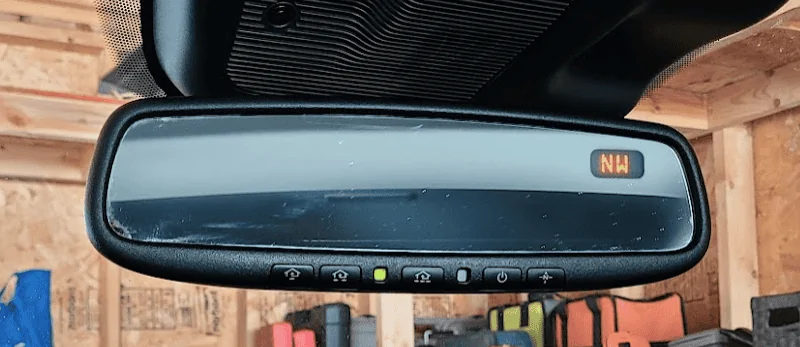

  7. My cable was thicker and I needed to file away some of the Camera trim so the cable could comfortable fit through, just depends what kind of wiring you get from your Gentex-453 purchase.
  8. All setup followed PDF instructions here, pics are little different but everything worked the same.
    • I cleaned the mirror afterwards ha, just noticed all the smudges when posting.
Turns off immediately when I turn key off and turns on when I start it, no power drain.
