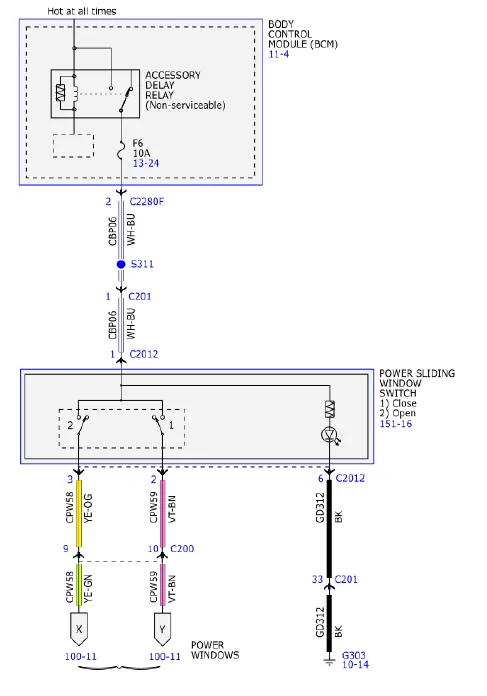

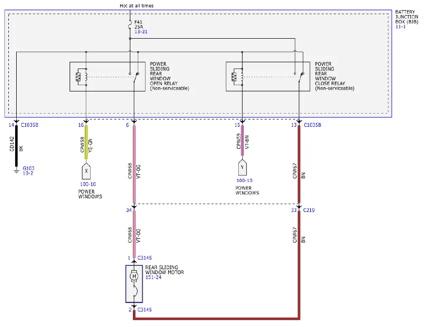

Is that single sliding power window really a 30 amp motor ?
That is what I read online.
Sounds like something AI would make up. I doubt the fuse is that big!! But I'm too lazy to look that up.
The sliding rear window is on fuse #60, a 25A fuse.
Page 299 in the manual.
