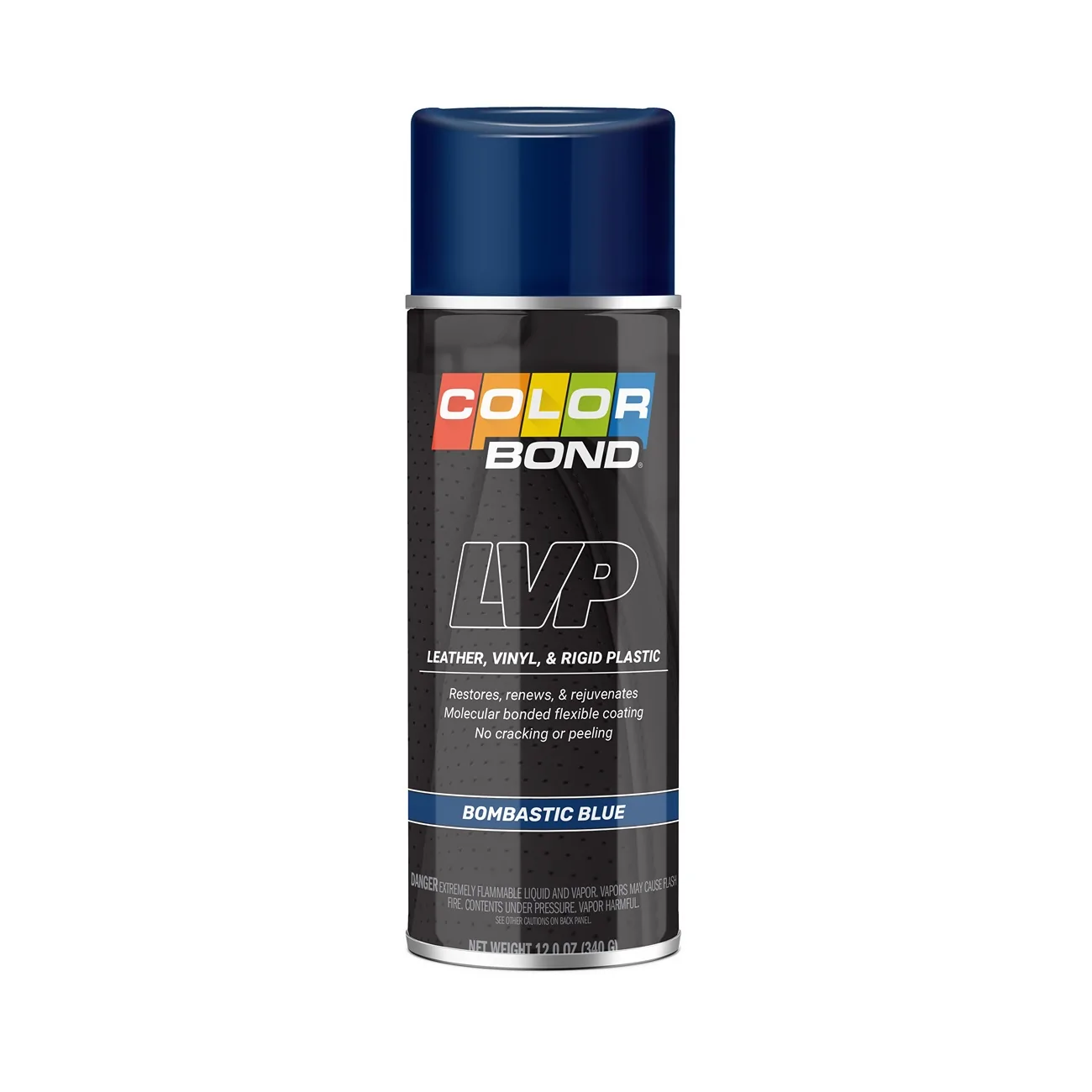

Phimosis
Larry
Jul 18, 2024
1,180
1,520
Santa Clarita, CA
Hey Ya'll, I used Cerakote Restorative Trim Coating on my 2024 Lariat BOP Maverick about a year ago. It's amazing and still looks like I just applied it yesterday. Been through many car washes too. I liked it so much I decided to use it on my 2021 Hyundai Palisade interior trim. It looked great but the next day the trim coating turned white. I didn't notice that the product description on Amazon said "not for new trim" until after the fact. I called the company and they had no recommendation for a coating that I could reapply to make the trim look like it did before I screwed up. They said to try a Mr Clean Magic Eraser (which are micro abrasive pads) and non acetone nail polish remover. They said it will take some elbow grease to get it off. I tried that but no lock. I'm wondering if anyone has used the product that turned white like mine did and if you used anything that could make the finish look original again. I tried 303 and Turtle wax Inside Job but they did nothing. Any ideas that actually work?
Ford Maverick Cerakote Restorative Trim Coating IMG_4449
