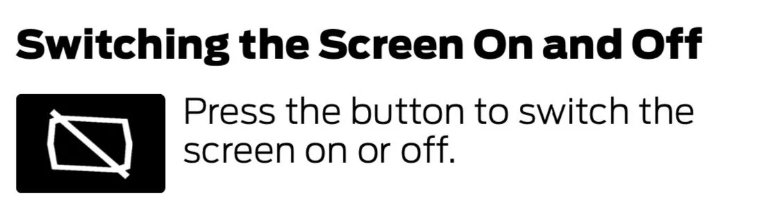

Just want to ask the obvious, without judgment… there is a screen “blackout” button that cycles through “on,” “clock,” and “off.”
Ford Maverick Center Display - Complete blackout 1734824460421-r8
Don’t know how one would hit it twice accidentally, and I would think once you start interacting with CarPlay it would come back anyway, but who knows. Good luck.
Side note: what happens when you put the truck into reverse?
Even if you hit the screen off button, it normally always defaults to Screen On, next time you restart the truck.
