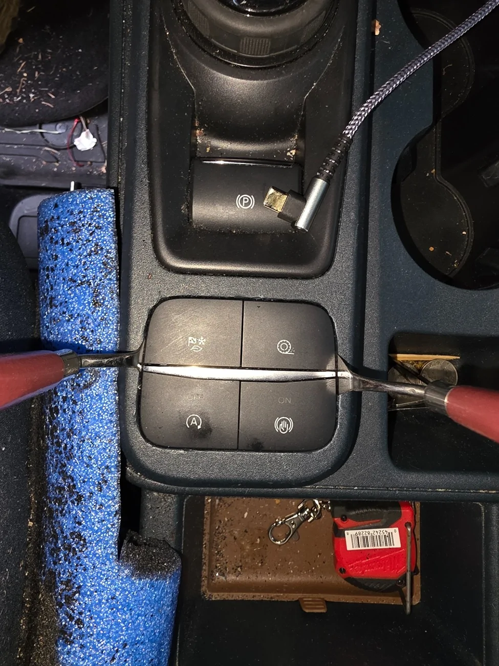

Read several guides on how to install jumper cable that allows you to override auto start/stop but can't pull out switch panel. Picture shows two spatulas that I've inserted that our supposed to relieve clips to allow panel to come out. You can see some dings where I've tried to wedge out to no avail. What am I doing wrong? 2024 Mav Lariat.

I was able to remove mine with two plastic trim tools. You need something thin, and you need something made of plastic so as to not scratch the vehicle trim. I think you have the tools in the right locations, but the tabs keeping the switch panel in place are too low for your tools to reach. I would suggest trying what others have mentioned and use discarded plastic packaging to fashion your own tools.

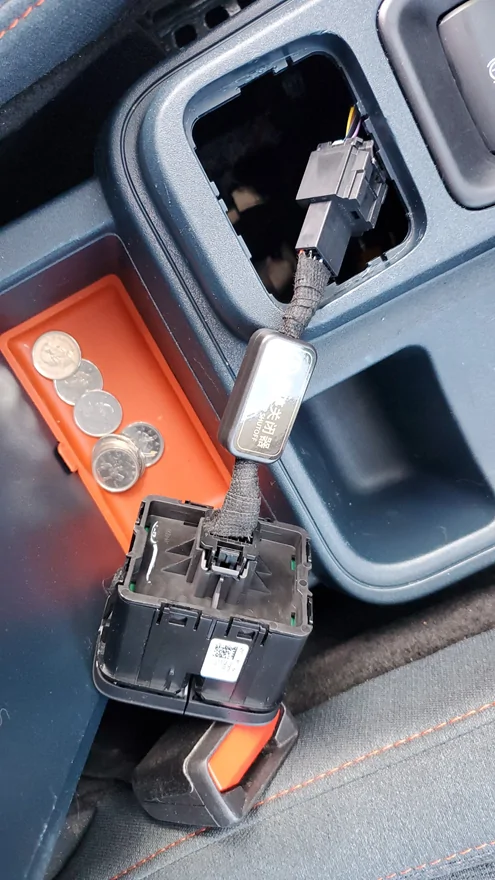

I had the same problem...was afraid I would break the switch. So took the whole console loose and removed the switch. The jumper that attached to the switch was about $15...the thing that plugged in under the dash was about $100. The best $15 I spent on the Maverick.

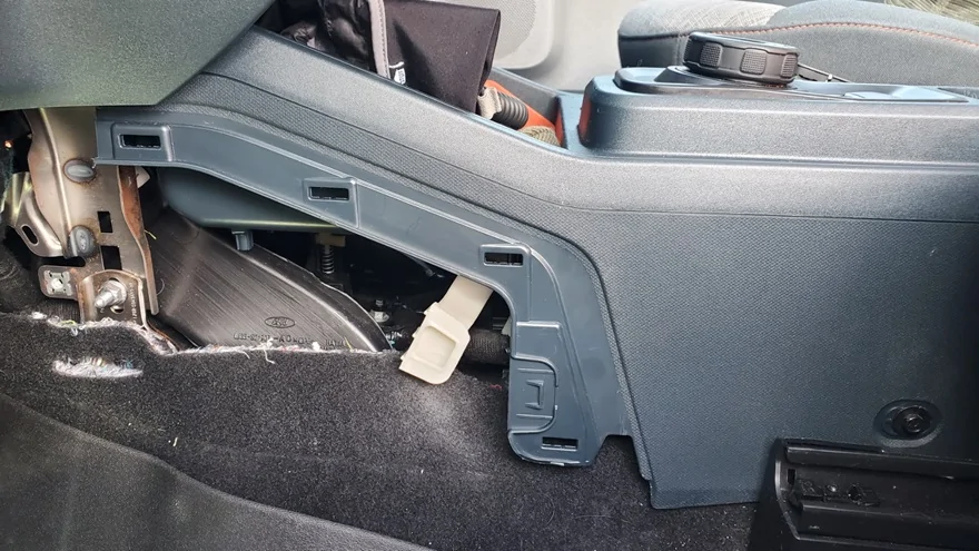

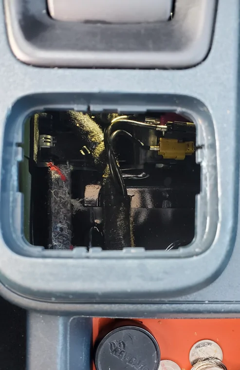

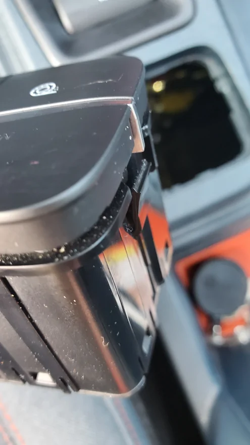

I removed the driver's side center console kick plate, and reached back to disconnect the switch wiring harness. I was then able to press the side tabs and eject the switch assembly from below. You need skinny forearms to do this, and I did get a few scratches.
Attached are some pictures to see the design of the tabs. If you want to try the thin plastic method from above, make sure your plastic tab is no wider than 1cm or 3/8".
