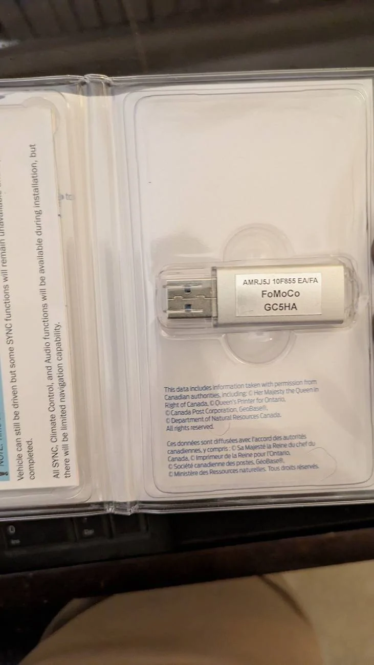

James, I went thru Fords website, which linked to another company, and I ordered the usb stick with the updated map on it. It was specific to my VIN. It came in the plastic case below. I don't believe it could be downloaded to another Maverick, though, as I believe it was set up just for mine.
Correct.... If you download online it must be downloaded to truck and installed to specific key (vin#). I haven't messed with mine. I just use my phone.
