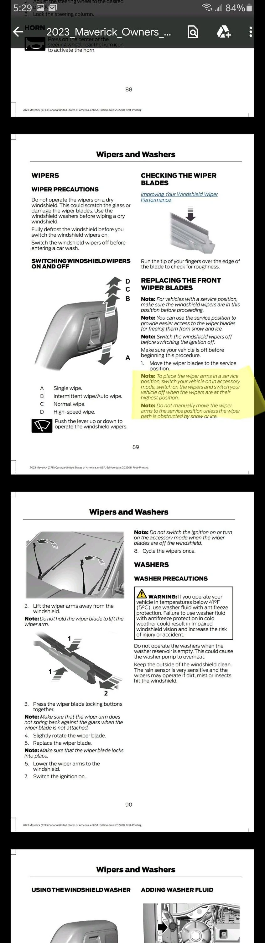

Advice please
note: To place the wiper arms in a service
position, switch your vehicle on in accessory
mode, switch on the wipers and switch your
vehicle off when the wipers are at their
highest position.
Note: Do not manually move the wiper
arms to the service position unless the wiper
path is obstructed by snow or ice.
Page 89 of the 2023 owners manual
did not see this in the 2022 manual..

See post #13 - Ford advises against this.
No, you misunderstood me, you don't move the wiper arm through any range of it's motion, you simply grab the wiper BLADE part only where it pivots on the arm, & lift it off of the windshield to release it, if there is snow or ice under where the blade rests, you can scrape under it with a small scraper.
