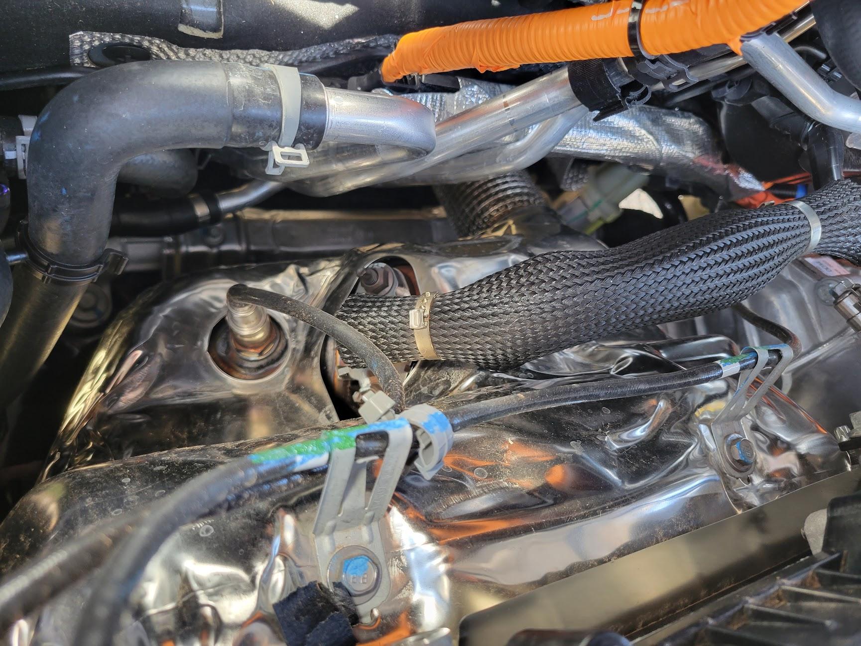

I picked my maverick up today with 10.8 miles on the ODO and wanted to see if the heat shield I saw posted in one of the these threads was in fact melted from the heat or that is just how it looks new.
It appears the melted/crinkled look of it is how its installed brand new from the factory not as a result of the cat glowing and heating it up.

I checked mine as well and agree it is kind of crinkled to to begin with.
