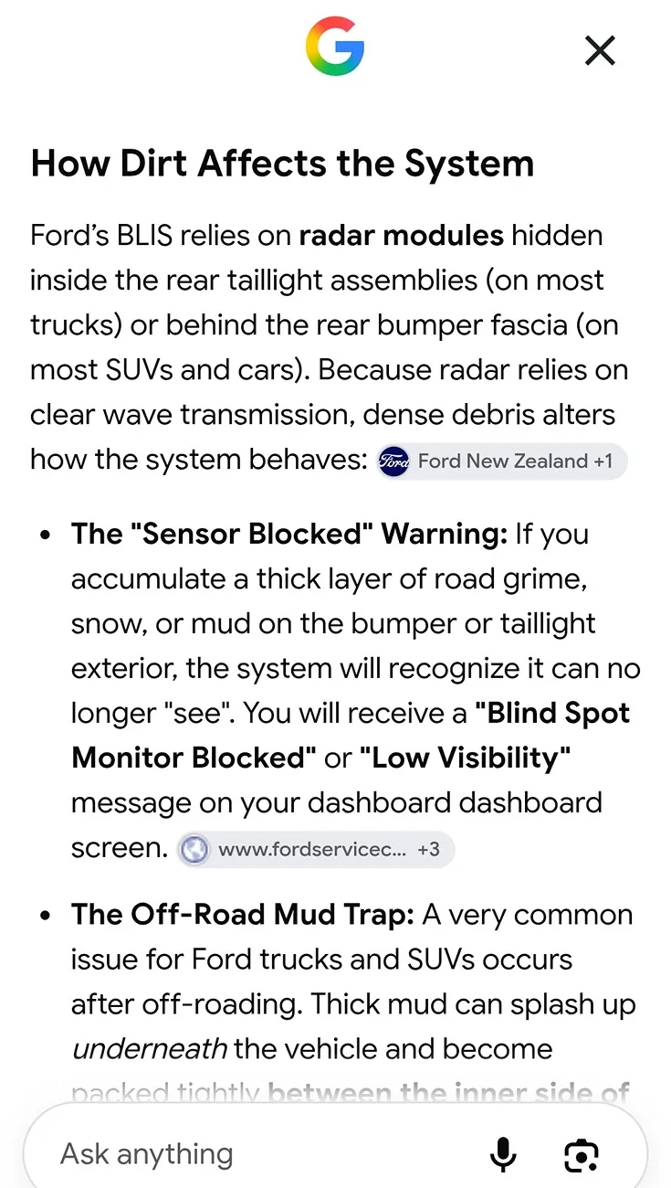

Dirt is blocking the Blis sensor you will get a message.

Give your sensor a good scrubbing. It's likely picking up some dirt or other material that is reflecting the radar signal and makes it think there is a car there.
If there is anything growing next to the road, or fences, ece that can also set it off.
If everything is clear and after a cleaning it still goes off randomly, have the dealer look at it. It may need recalibration.
