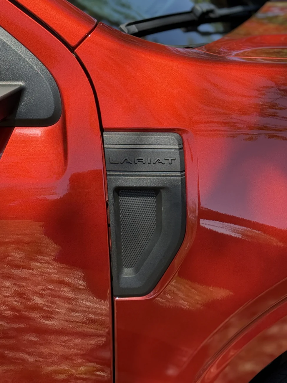

I'm currently doing a chrome delete on my truck and decided to tackle the Lariat side emblem. I did try plasti-dip at first so I could just paint the actual metal text, but I got frustrated with it, and while attempting to remove the excess with tweezers any little touch would break right through and expose the metal. I cleaned the plasti-dip off with a brass brush and went another route. I masked right up to the letters, hit them with self etching primer, peeled that back and masked into the 'ditch' surrounding the text area, hit that with plastic adhesion promoter. Final top coat was rustoleum truck bed spray can (platinum).
Looks pretty good, I think.
