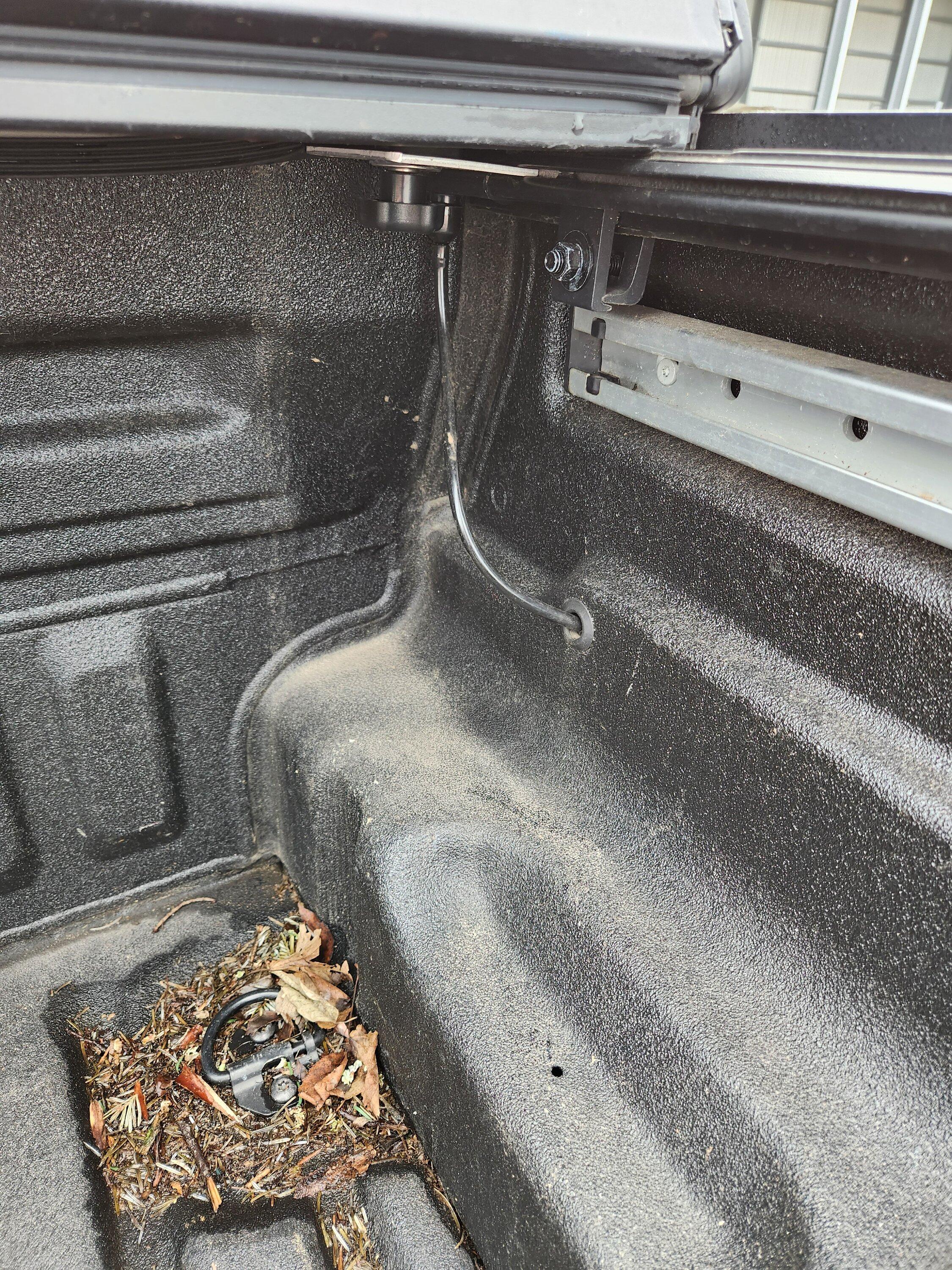

I have 3/4" plastic filler plugs in the bed sides, right under where the Bison drain pipes are. Just pop out the plugs and feed in about a foot of pipe. You have to twist the pipes around so that they don't kink. Done.

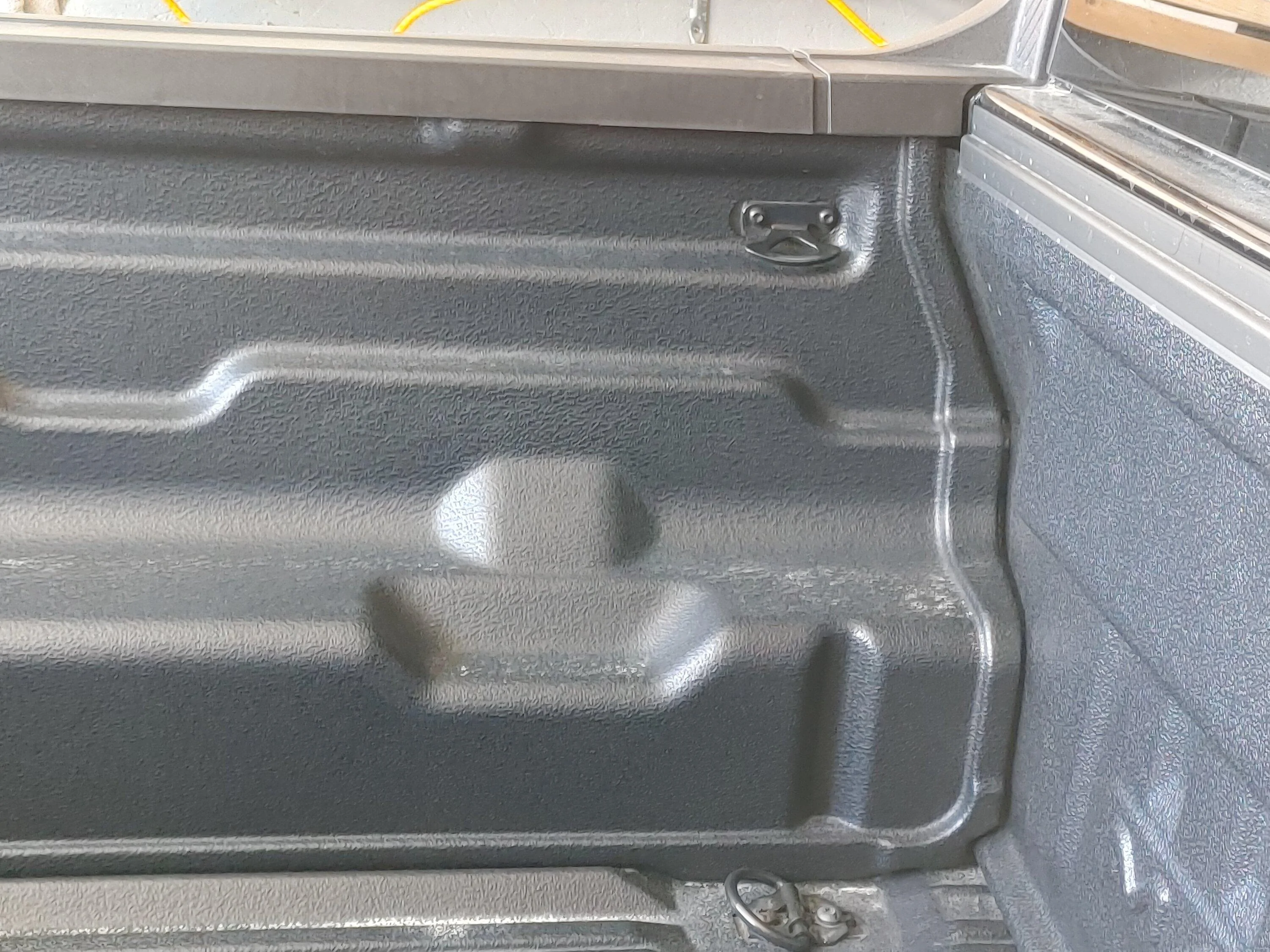

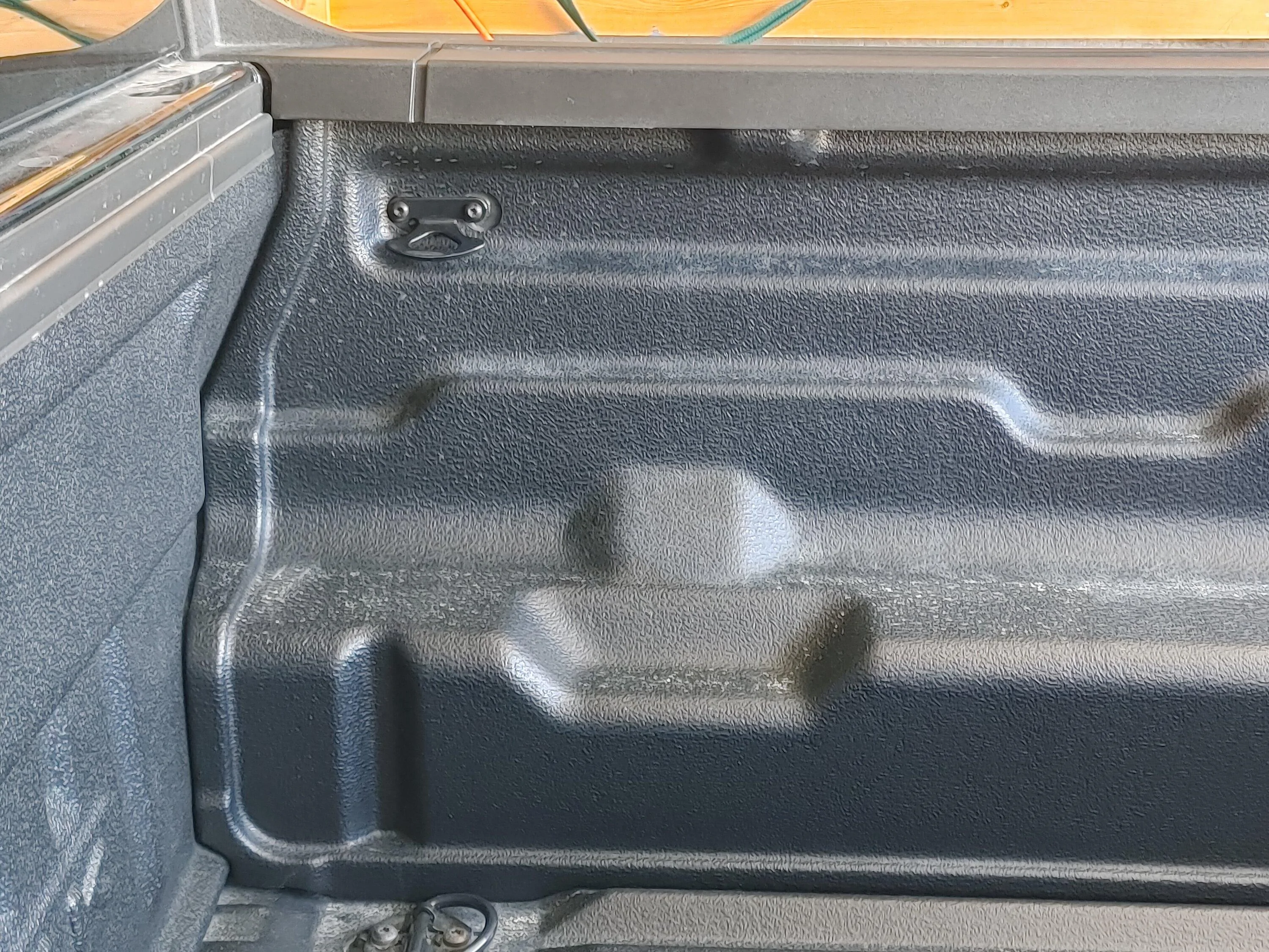

As you can see I'm doomed, mine have no such plugs!
Ford Maverick Bison Tonneau Cover 20240307_130405_HDR
Ford Maverick Bison Tonneau Cover 20240307_130424_HDR

Something happened to the image I posted earlier. But yeah it seems the drop-in liner covers the drain holes.
Ford Maverick Bison Tonneau Cover 1000006958
I think I have the same bison tonneau cover as you @Kirkster and no bed liner.
I have those same holes that Whatcolortochoose posted above.
