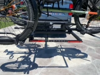

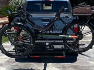

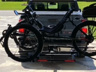

Our state has laws for rear overhang exceeding 4 feet. Anything overhanging more than 4 feet requires a red clearance light at the rear for night travel. Also, in the daytime, red or orange flags are required for an overhang exceeding 4' rear. I am sure your state will have similar laws.
And as I said I have added lights on the rack for added safety. This picture was taken before I tied them down. I also have an 8x8 orange safety flag secured on the back trike. Been hauling like this for 5 years. Used a RAV4 before the Mav.

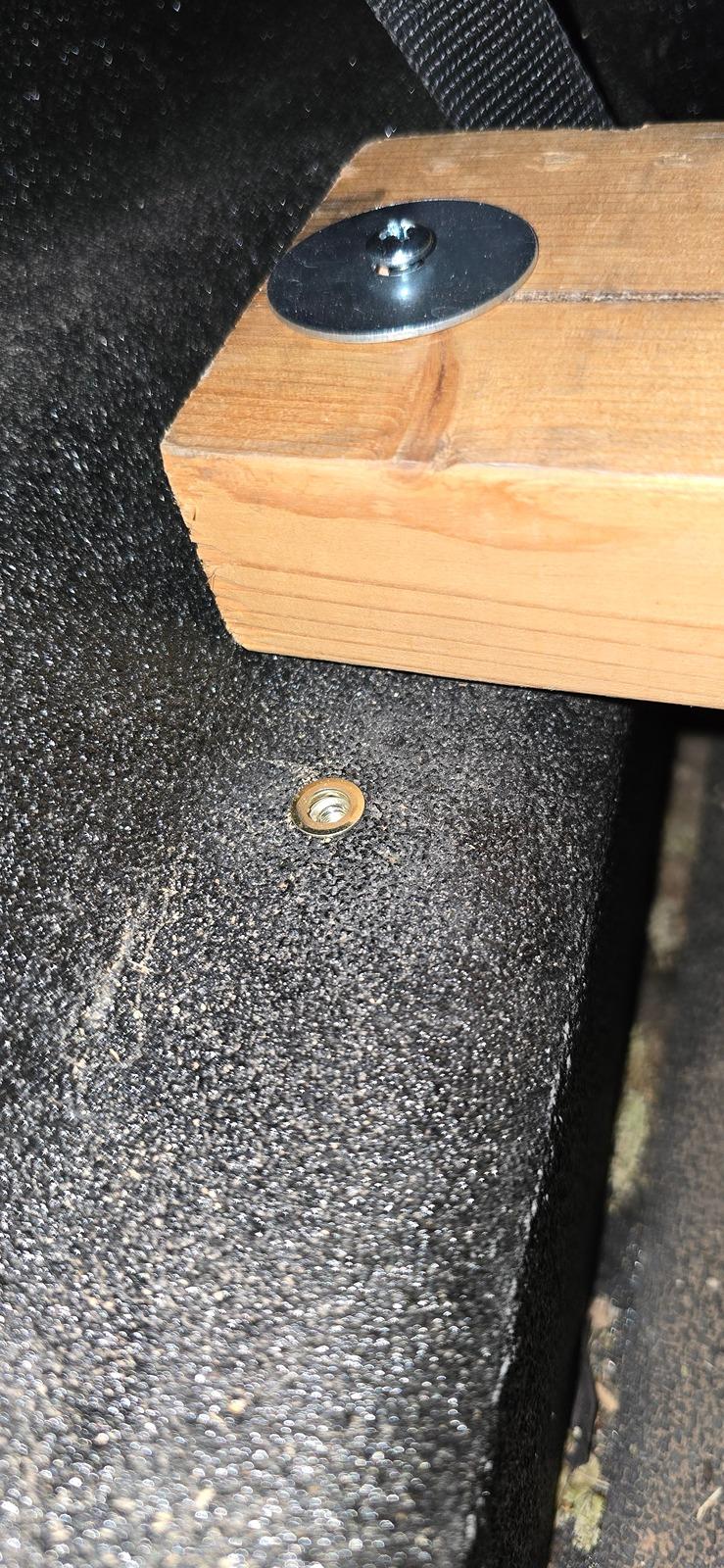

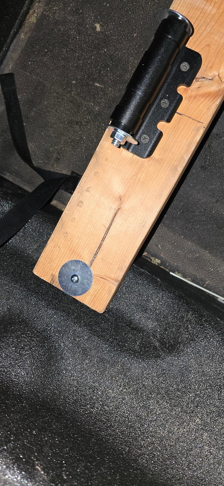

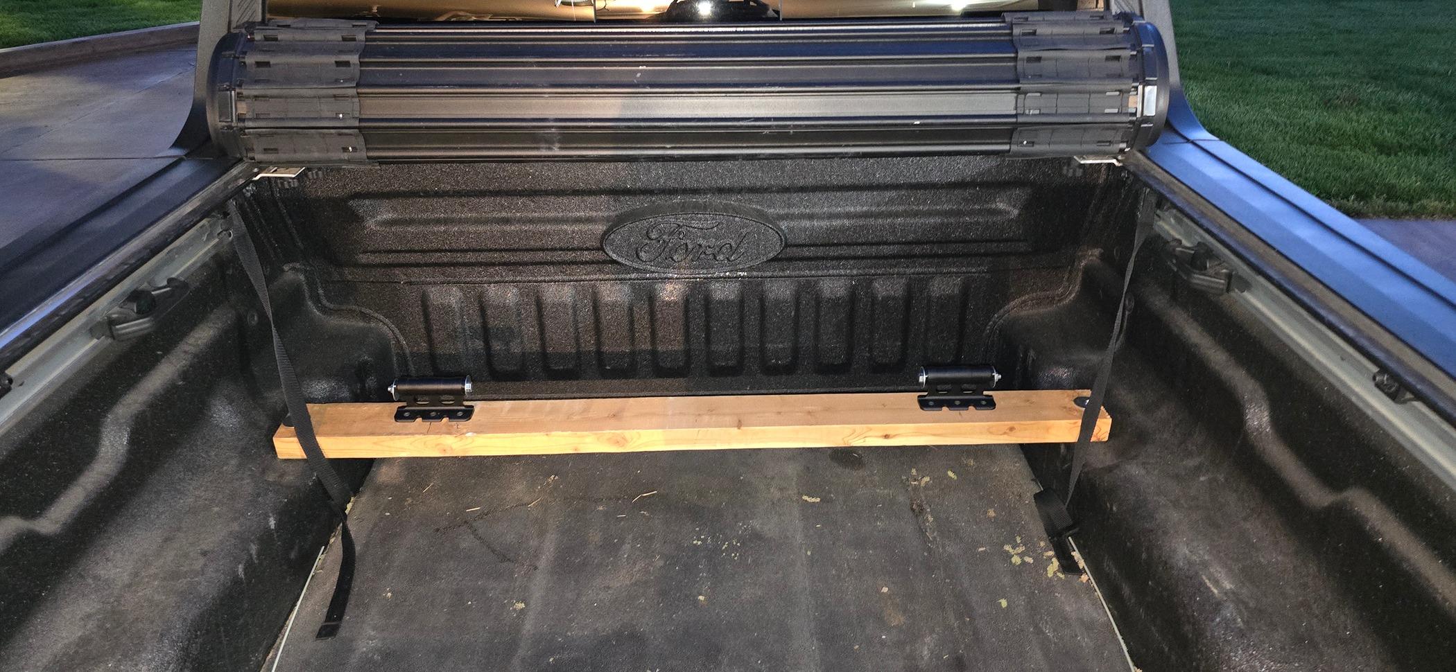

I threw this together in a few minutes.
Ford Maverick Bike Hauler - my single and multiple bike carrying solutions 17139266130722489544842036245615
I drilled the existing holes in the fender wells slightly bigger to accommodate 1/4" X 20 Rivnuts, then screwed in two, 2" X 1/4" X 20 screws. The fork mounts were under $10 each on Amazon.
Ford Maverick Bike Hauler - my single and multiple bike carrying solutions 17139267965363848125230286965538
Ford Maverick Bike Hauler - my single and multiple bike carrying solutions 17139268727904285067536671429435
Now it's a super quick in/out with just a screwdriver!

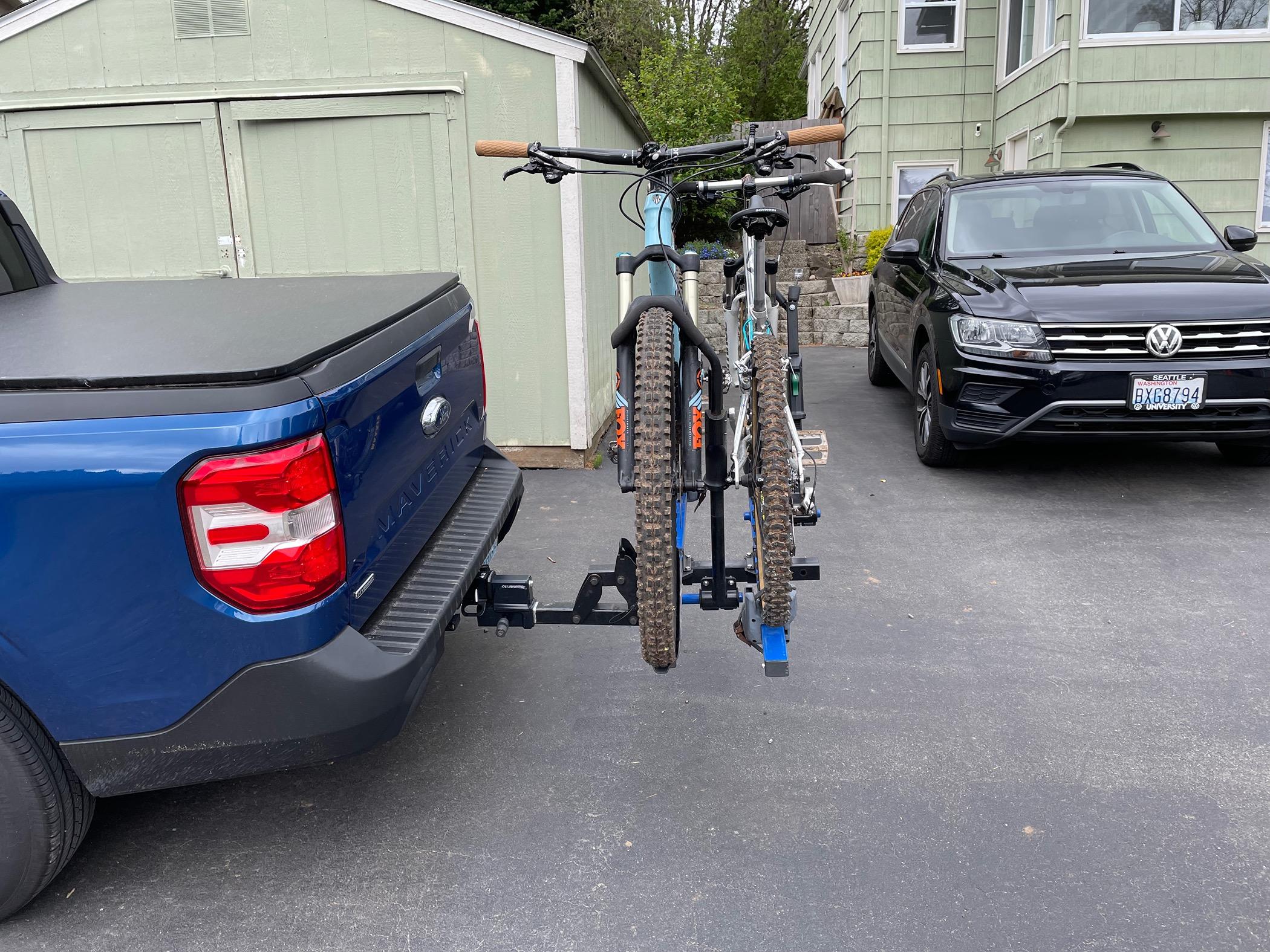

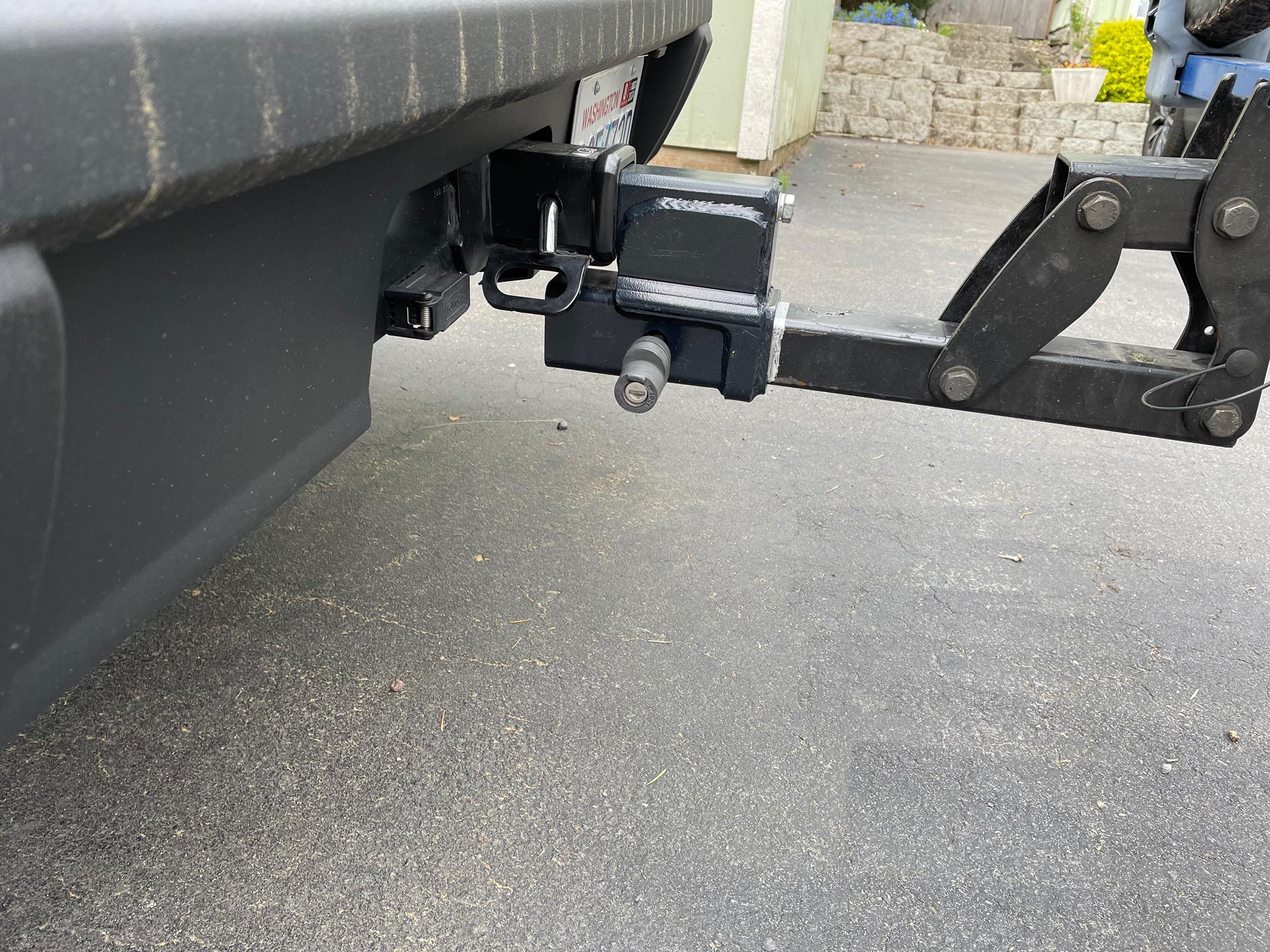

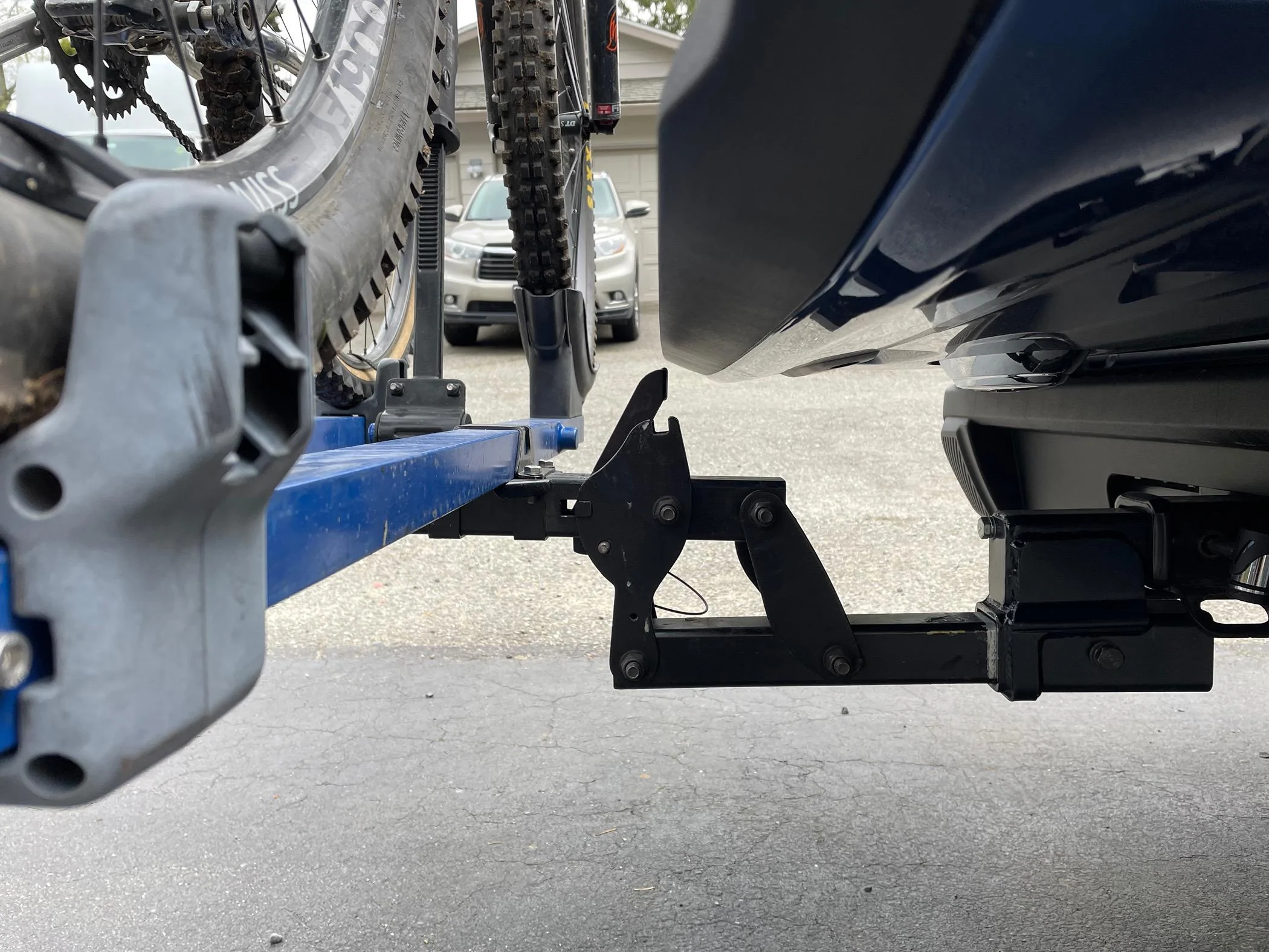

I have a Thule T2 rack (the older style) and bought an adapter which moved the rack down and back a little bit so I can open the tailgate with bikes loaded.
I wanted to tuck my rack as close to the truck as possible so that it’s just not hanging out so far and this was the best solution I found. I re drilled one of the holes on the adapter to tuck it in a little closer and thought about drilling a second hole to bring it even closer but I’d only gain another 3/4”. As is, it sticks the rack out perhaps 2” farther than just the hitch alone
I have the two bike extension as well so I can haul 4 bikes when I want to and that adapter handles it just fine. It’s a stout piece of metal and has a great anti rattle wedge in it.
as I price these racks, I like your solution a lot more.
