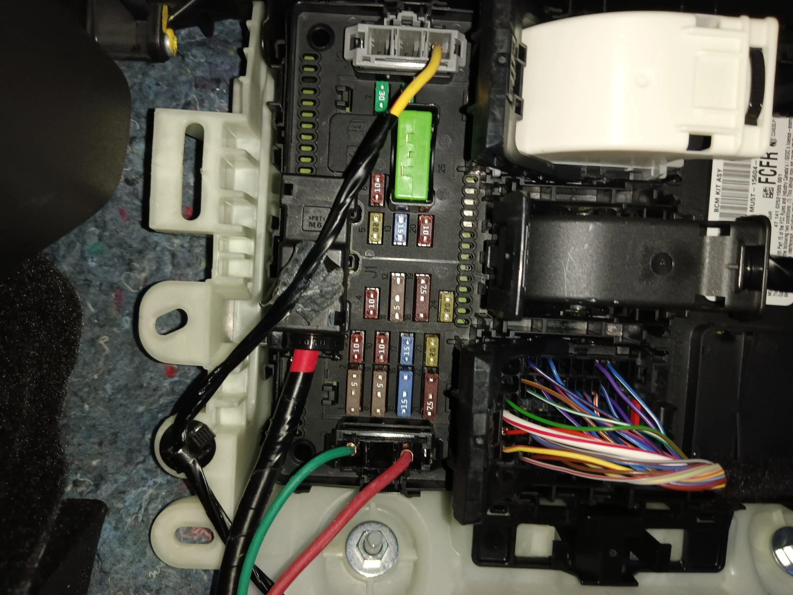

Fuse 3 and Fuse 6 are the only 12V switched that I found in the body control module panel found in the front passenger footwell area.
I used a piggyback fuse holder I got from Amazon. Because of the height of the fuse holder and the 90 degree angle, I found fuse #3 much easier to use.
Another member is using use spots 1 & 2 with a Micro3 fuse tap. They are listed as unused. He claims that they are switched. I haven't tried it yet.
This doesn't help the OP as he wants the start circuit.
