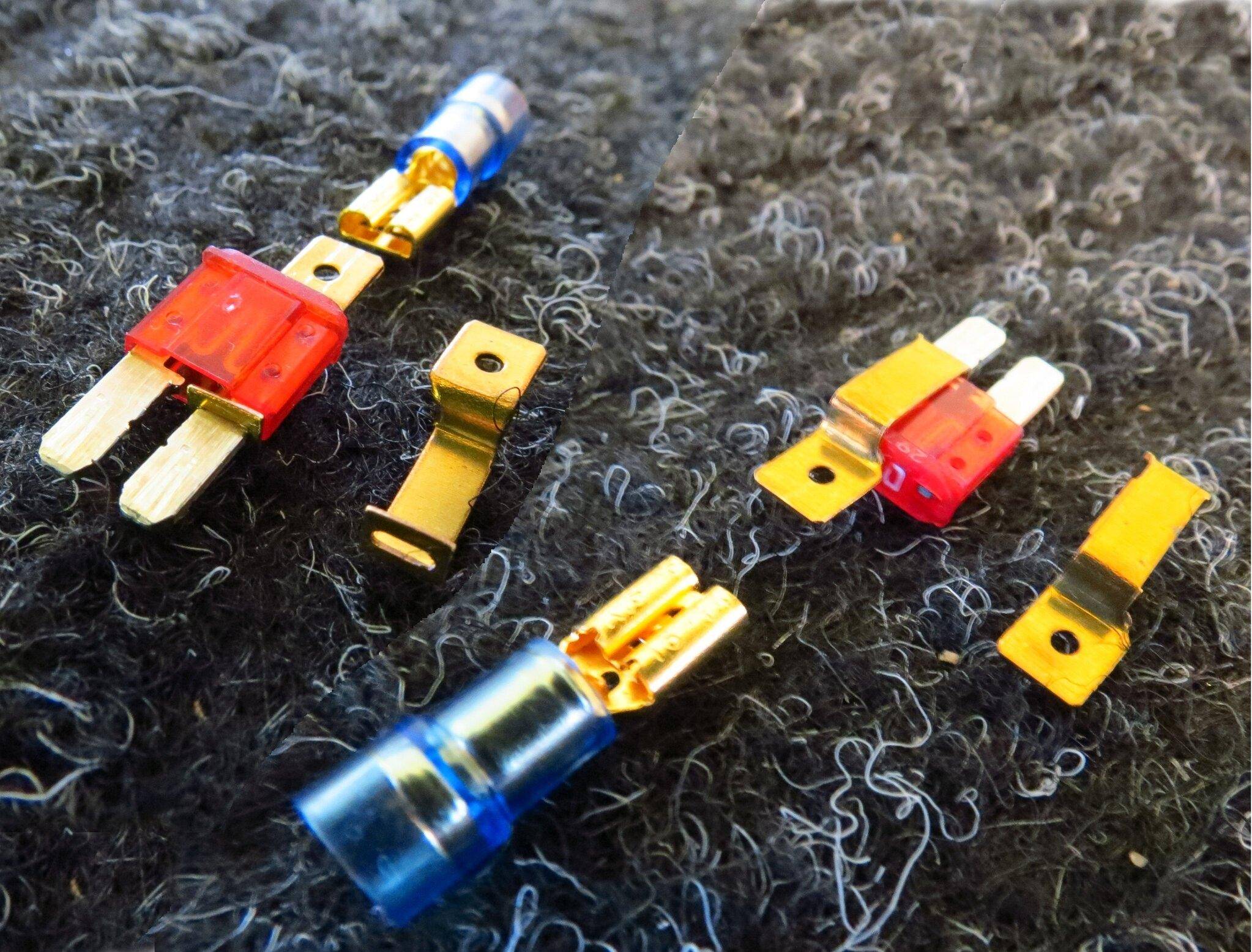

I don't mind if the amp turns off with the truck. So fuse 1 is a good choice? What does it run?
Can you give me an amazon link to the fuse tap you like?
I found that fuse 1 didn't produce any power at any time on my 2024 XLT but they do make Micro 3 fuse taps or add-a-circuit kits.
Check it with a multi-meter on your truck to see if it's producing power before ordering a fuse tap.
