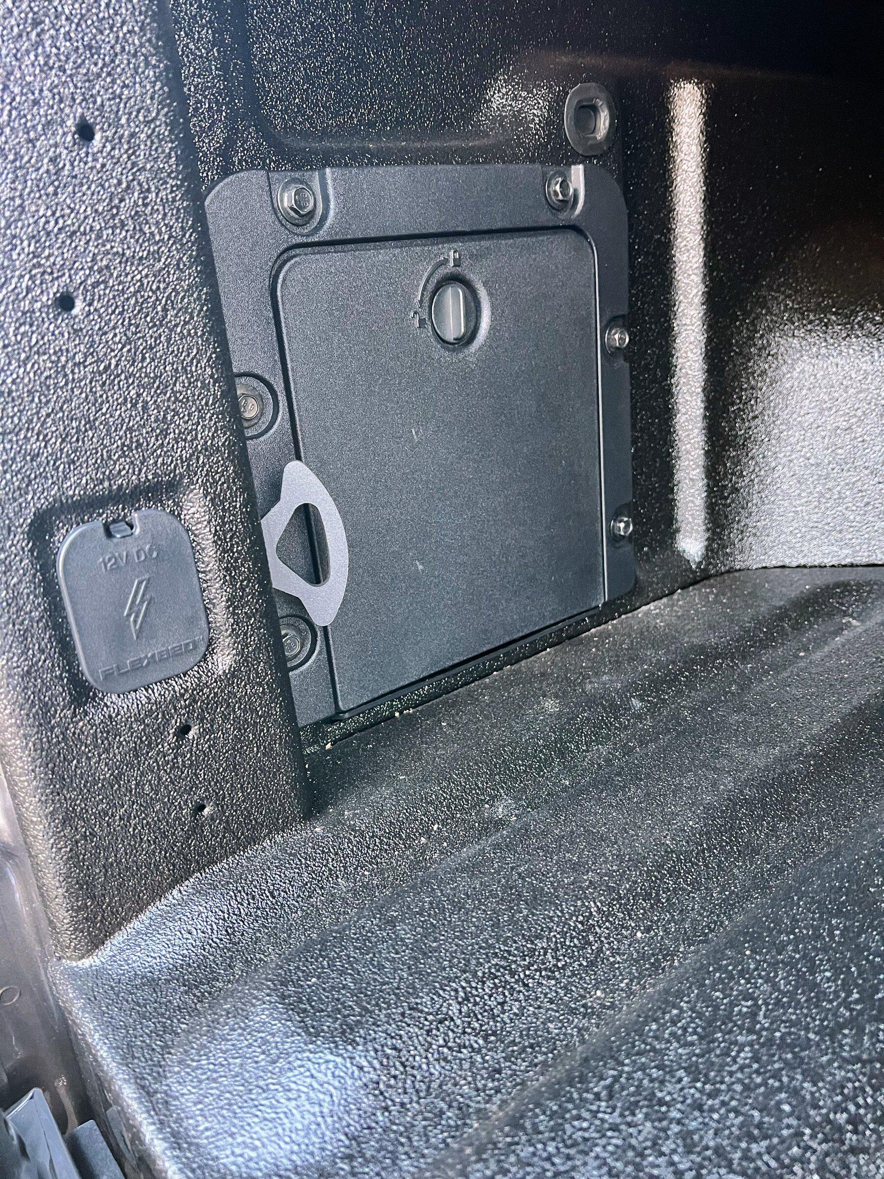

I have an XL (no cubbies) and bought the Right side cubby. However out of curiosity I installed it on the left. Fit fine and I left it there. Went back and ordered another to actually install on the right.
If you ask the Ford dealer they will tell you it’s a different cubby for the left and that it isn’t available yet. But…
Make sure you order a package of bolts too. The block off plate uses 4 bolts and covers over 2 additional holes that are used with the cubby.

Thanks a lot. I'll probably do the same (just on the left since I'm getting an XLT).
Can you post a picture of the cubby in place on the left side?

Thanks. That looks like it fits perfectly.
I'll probably order one when my hybrid gets here. Depends on what the cost is for the cubby insert itself (the plastic bin that fits inside the body) and the cover/door plate.
The bin comes complete with a door. The only thing extra you need is 2 more bolts and they come 4 to a bag. If memory serves me the whole project was less than $50
