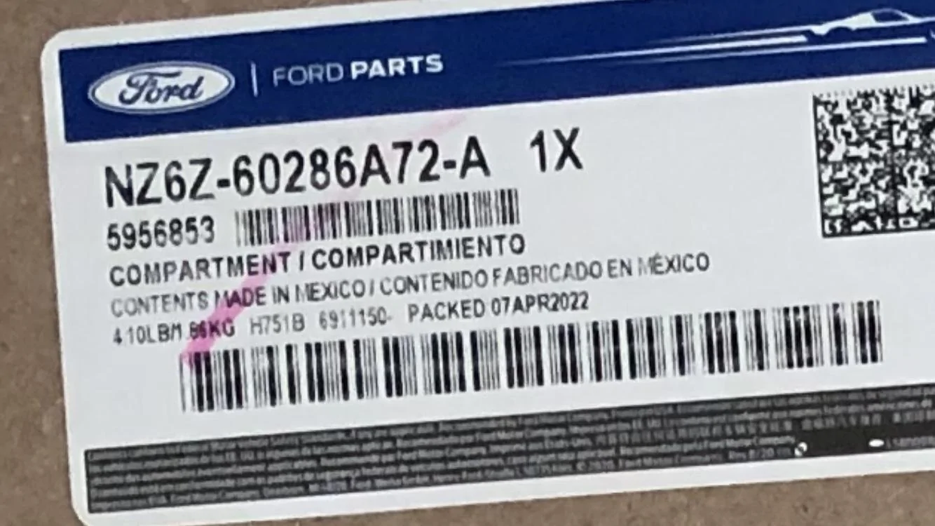

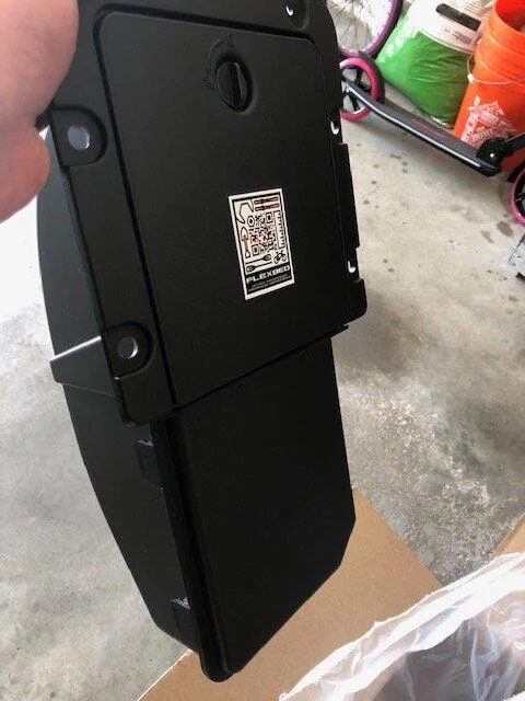

I just installed two cubbies (Ford part lists them as "Partition") in my XL.
Ford part # NZZ-60286A72-A as noted in thread listing. List price is $40 each, dealer sold them to me at $33.60 each plus tax. Both sides are the same.
You have to remove the "tie-down hooks" to install the cubby. Cubby has holes for 6 bolts, threaded holes are in the bed for the other two, the covers only have 4 bolts.

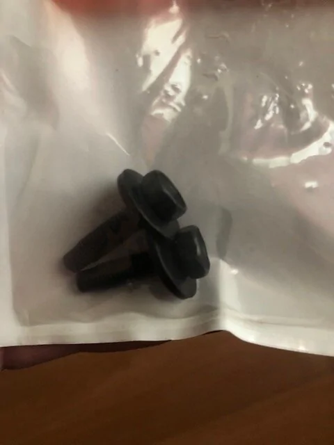

I ordered one at my dealer the other day and it came in fast. And the 2 extra bolts....W505424-5450B.
