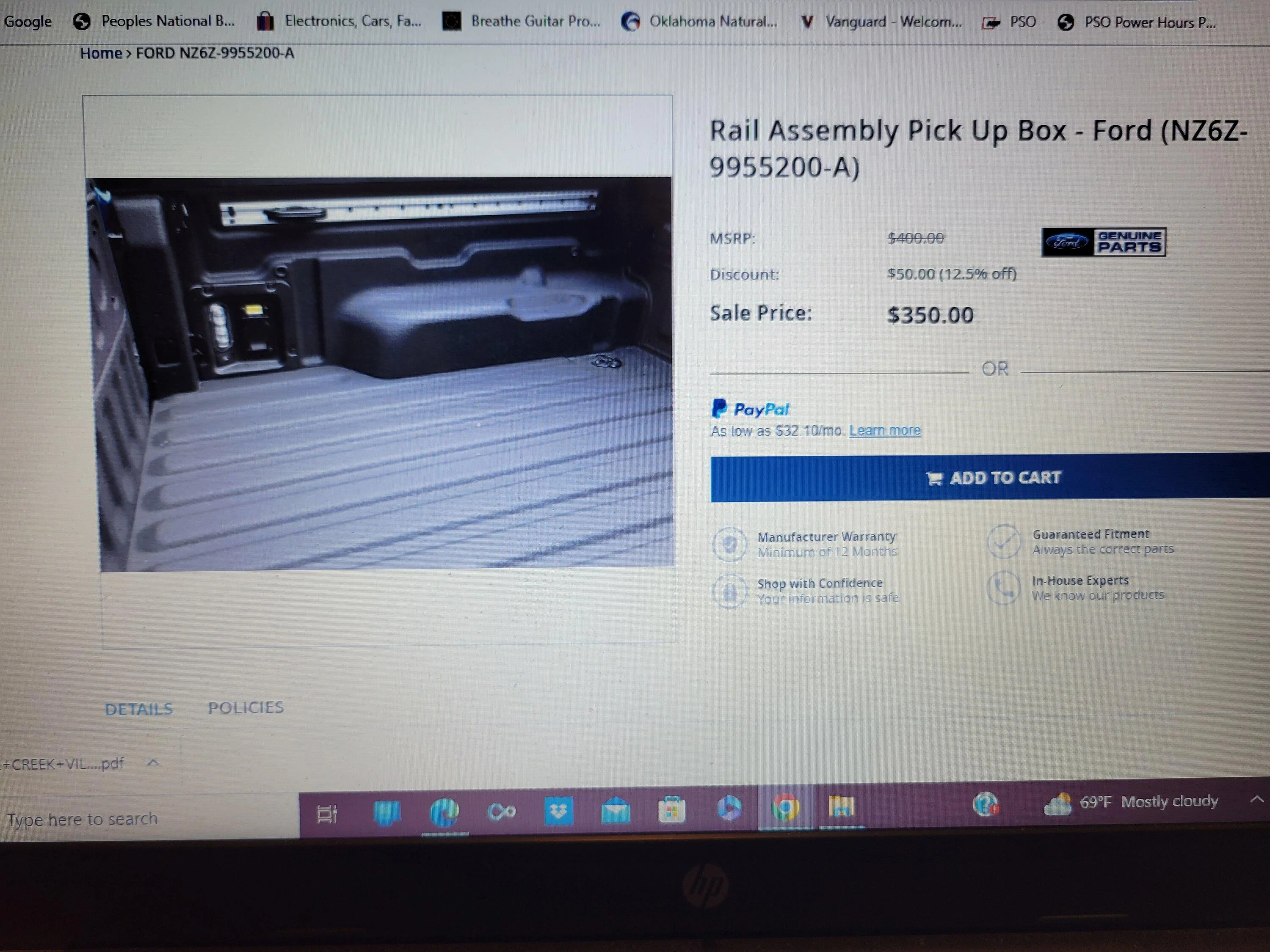

Anyone know where I can find a part number for a bolt for the bed rail assembly? In the process of removing mine in order to install new drop-in bedliner, I somehow managed to lose or misplaced two of the torn 30 mm bolts that hold these rails on.
Ford Maverick Part number for a bolt for the bed rail assembly? 20230306_184936

If it takes a Torx T-30 bit, it's a M6 x 1mm pitch screw. Should be able to find something with that thread at a local hardware store.

Thanks, but a lot of what I have found are hex bolts, which might work, but I'm not sure the tiedown will slide over a hex bolt.

Looks like they are Low or Ultra-Low-Profile Socket Head Screws. Might have to search for that type.

M8-1.25 x 30mm Flat Head Hex Socket Cap Screws Bolts, 304 Stainless Steel 18-8, Connector Bolts Screws for Furniture, Bed, Chairs, Bright Finish, Full Thread, Pack of 20 https://a.co/d/cu3mZtv
Just ordered these. I hope they’re strong enough but at least they’re stainless. I wasn’t paying attention and stripped one oem screw. Line-X dude didn’t properly mask those holes so I spent an hour cleaning out the threads. He only masked the ones I had hardware installed. :mad:
If they’re too long, you can install them at the end so they won’t interfere with the cleats.

Thanks. I ordered these and they worked out well. Thanks again!
