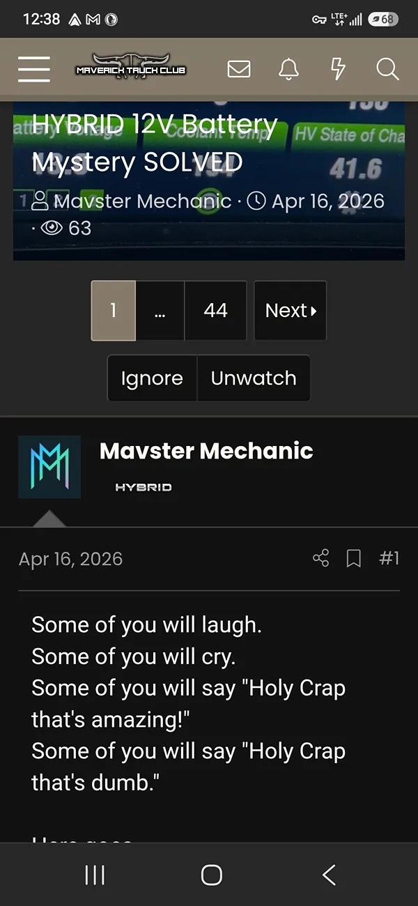

If you haven't informed yourself on the 12 volt battery drain and what can be done to help yourself when you get the new battery...here is some...ahem...light reading here on MTC to catch you up and help you out.
Ford Maverick Battery warranty 2024 hybrid Screenshot_20260627_123820_DuckDuckGo
If you get a new battery, ensure they fully charged it (not a quick surface charge), and followed the manuals directions on how to reset the truck so it knows it has a new battery and figures out the appropriate charge parameters.
And then turn on your headlights or parking lights when ever driving (yes, even in the daytime).
I hope all goes well with your battery replacement,
Andy
Oh, this info and thread started my Mavster Mechanic will not help if you are suffering from an occasional sudden overnight battery drain issue.
That needs dealer investigation and work, as well as module updates to resolve...such as the air conditioning module being one of the updates.
