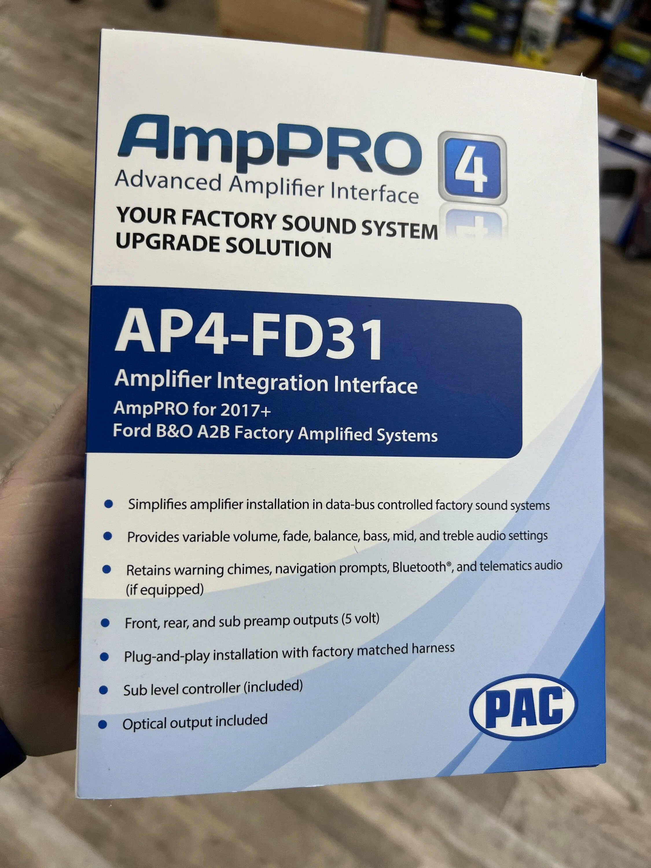

I used the PAC to grab the signals for my fronts and subs
It was easy and required no splicing, but for the price I’m not sure it’s worth it
Well I’m lazy so the easy connection was worth it (plugs in at the amp location)
Gives front/rear/sub rca outputs plus remote turn on so the system works just like factory (this is a plus and minus as the radio has power as soon as the doors are opened)
Only wire I had to run was the bass knob (but I suppose I could have left that in the back but I like to make changes based on music)
Im not sure what the question was

Thank you all for your input/advice! I ended going with the following system and will post pictures once I install it all.
  • PAC AP4-FD31 for clean signal (of turning down the damn open door chimes)
  • Morel Virtus 602 2 way components for front
  • Morel 4” coax rears
  • JL 10TW1 in a ground shaker box under rear seat(driver side as I have a hybrid)
  • JL 5 channel amp (XD700/5) with sub knob somewhere on the lower dash.

the pac is like $380 - anything with the a2b interface is pretty costly, but a good multi-channel line out converter like a lc5i is also expensive.
it does have value, though. you are fully integrated to the sync3 (or sync4) receiver and you'll have normalized volume for door chime and other system sounds, navigation audio, etc.
plus you can remove the B&O amp and use that real estate to install your stuff. it's way better than leaving the B&O and then tapping the speaker outputs for your other amp / dsp input.

b&o does front 6.5s and tweeters and the 6x9 sub. the center channel and rear are powered by the sync unit internal amp.
that's the other value of the PAC a2b interface.
