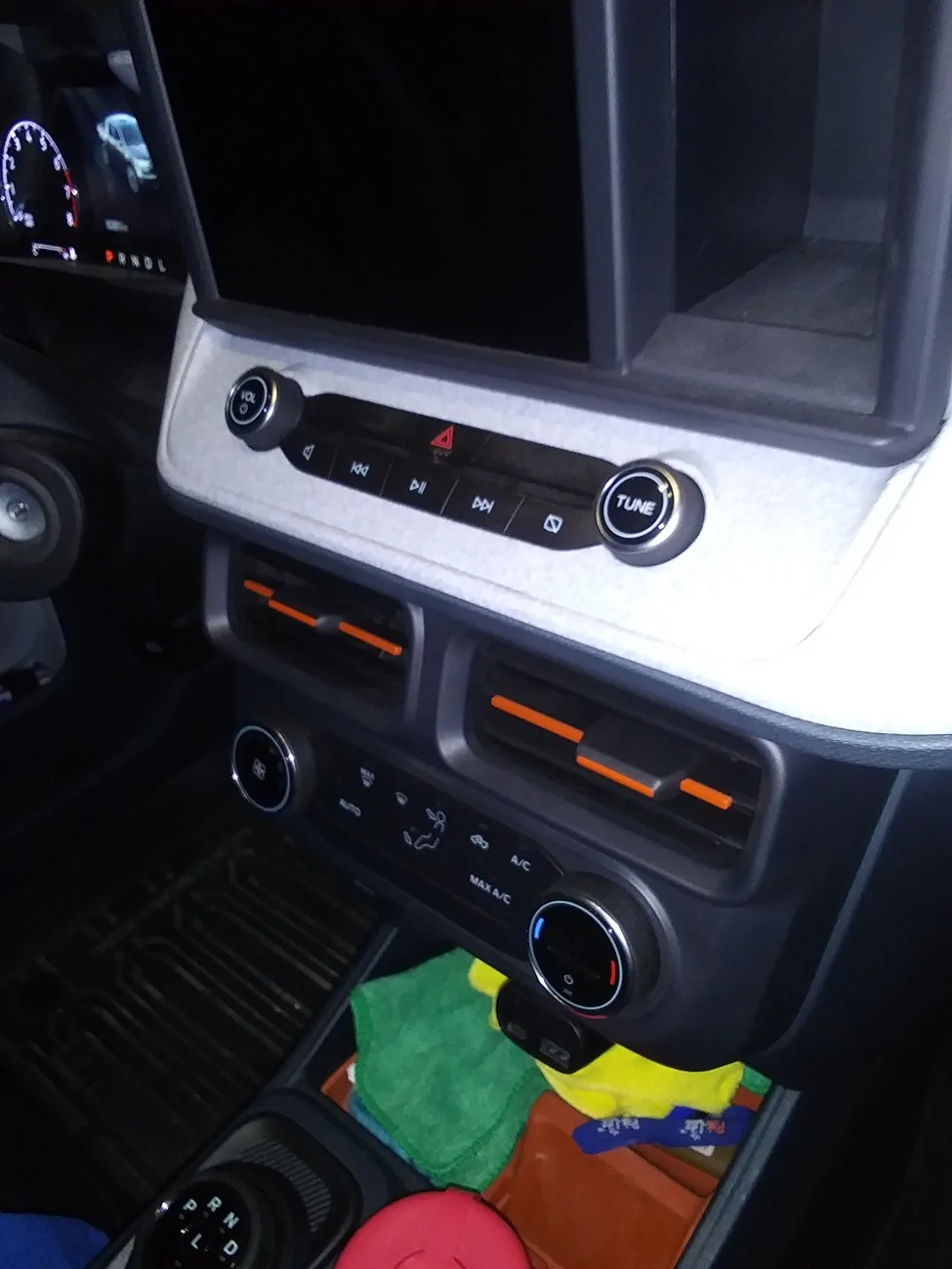

Hello I’ve been concerned because my Maverick puts auto AC on in 60 degree weather… I tried to figure this out when I realized that and couldn’t find anything in the manual like people said and my FordPass app looks different than what online says and how to turn auto AC off…
it was 53 this morning and my truck automatically turned AC on… I know I know I know it’s for defogging…. But it’s COLD why does nobody understand why AC when it’s cold just DOESNT MAKE SENSE.
please please please help me I don’t know what I’m going to do when my car is turning AC on when it’s 10 degrees or below.
please help!
The compressor will not run if the ambient temperature is below a certain level. It doesn't matter what the light on the dash says. If it's below a predetermined level the compressor will NOT engage. It's NOT something to be concerned about, Just drive. Let the truck do what it's designed to do. In the unlikely event that the compressor does engage, still no reason for concern because the compressor is a variable displacement. So even if it's running at a low temperature, it's not pumping anything.
