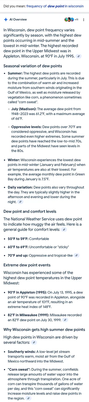

No, I'm in Wisconsin, not humid. Turns on randomly due to lack of use maybe. So intermittent I can't pin point it. Or it's a programming glitch. Your theory then it's on all the time due to humidity with the windows down, not the case.
It appears that the dew point is quite frequently Reached in Wisconsin. In mid summer driving past a cornfield at 72°F the humidistat can turn AC on to prevent fogging. Etc.....
