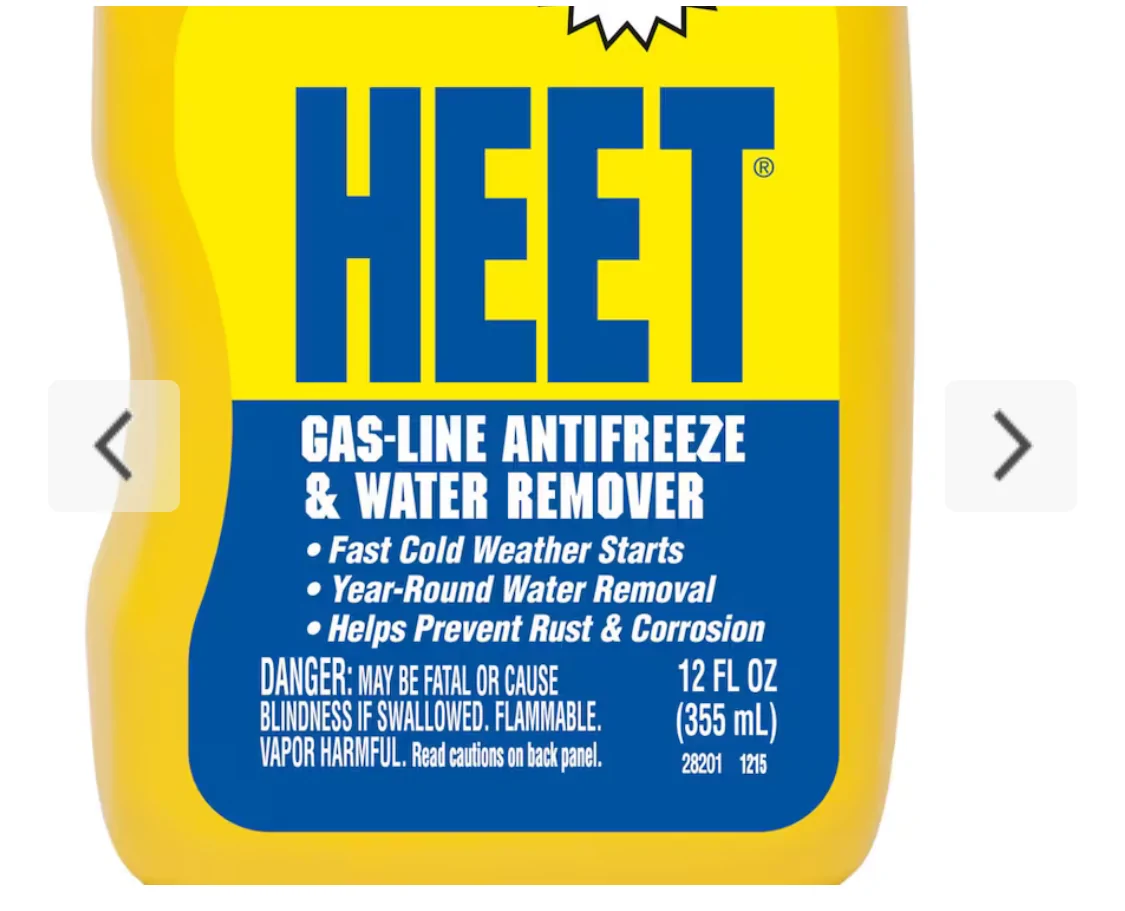

Primary ingredient is alcohol.
Ford Maverick (Article) The Feds Plan To Start Diluting Gasoline (E15)This May 1774883090617-wy

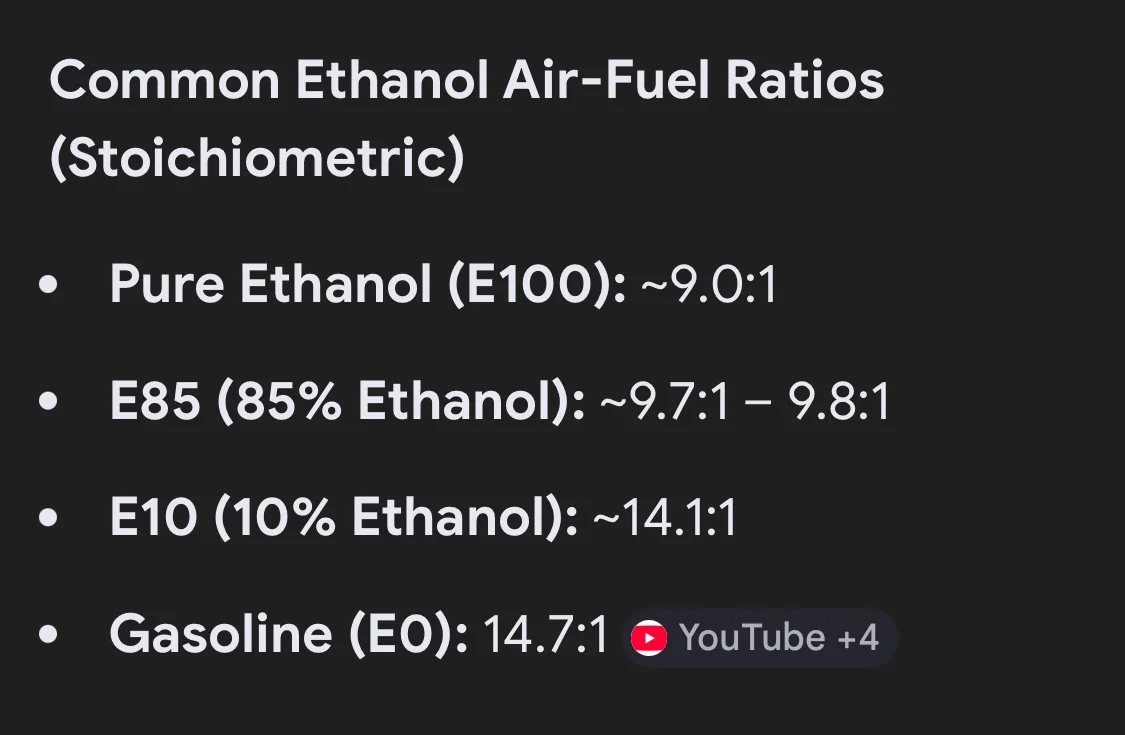

Slower flame propagation is what gets you a more complete burn and less pollution per stroke.
Small engines like that. Just like big engines.
What small engines without electronic fuel injection don't like is the rich mixture required from ethanol. So usually they run lean when they can't self adjust. It's up to the user to manually richen the mix and most people don't do that.
Gasoline needs 1 part fuel to 14.7 parts air.
Ethanol needs 1 part fuel to 9 parts air.
E10 needs about 1 part fuel to 14.1 parts air.
Ford Maverick (Article) The Feds Plan To Start Diluting Gasoline (E15)This May 1774884024655-8g
