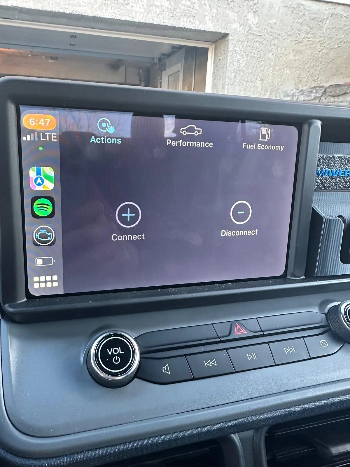

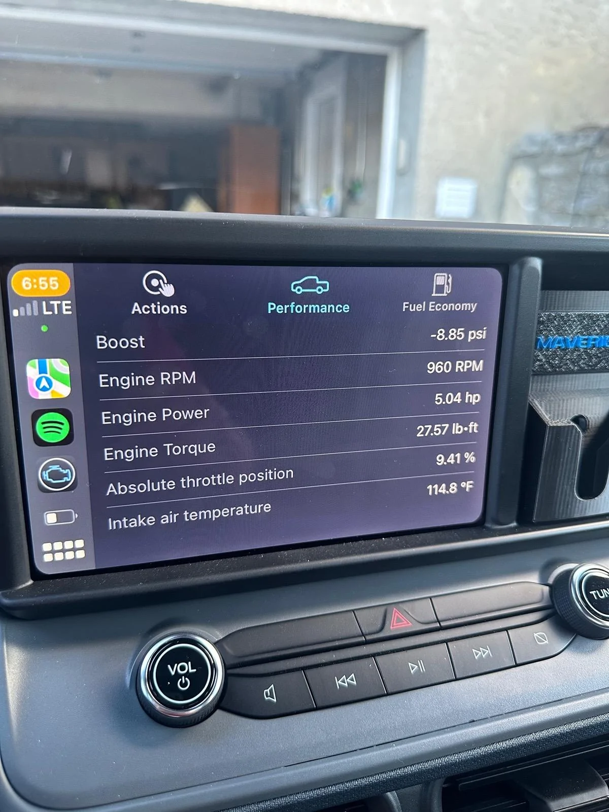

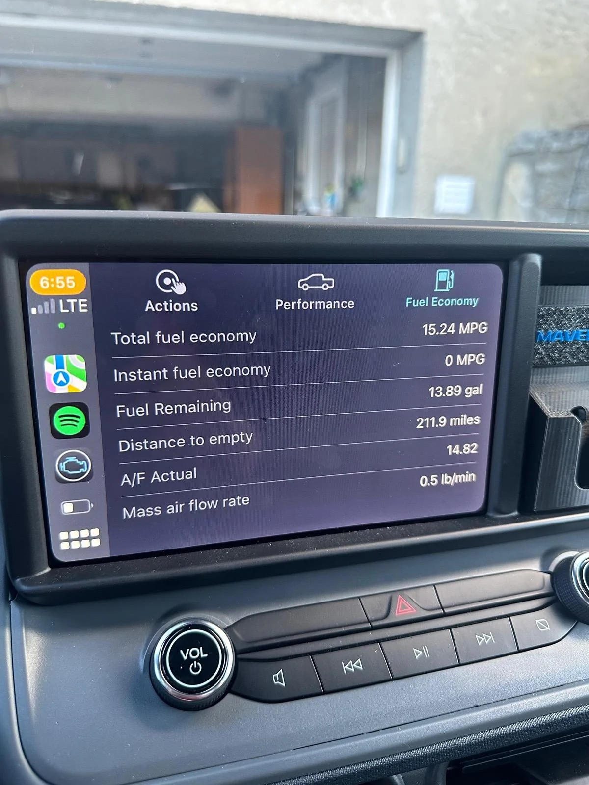

Im using the Carista (wireless bluetooth ELM327 adapter) with a wireless CarPlay adapter (CPLAY2air) and the OBD FUSION app on IPHONE to achieve live data reading on multiple adjustable screens while driving. Here's a picture below.
EDIT: To adjust what you're seeing on CARPLAY you need to go to the OBD FUSION app on IPHONE and go to Settings - Preferences - CarPlay then you can adjust the Parameters displayed on CarPlay! ALSO you do NOT NEED wireless CarPlay. This will work with wired CarPlay too!
