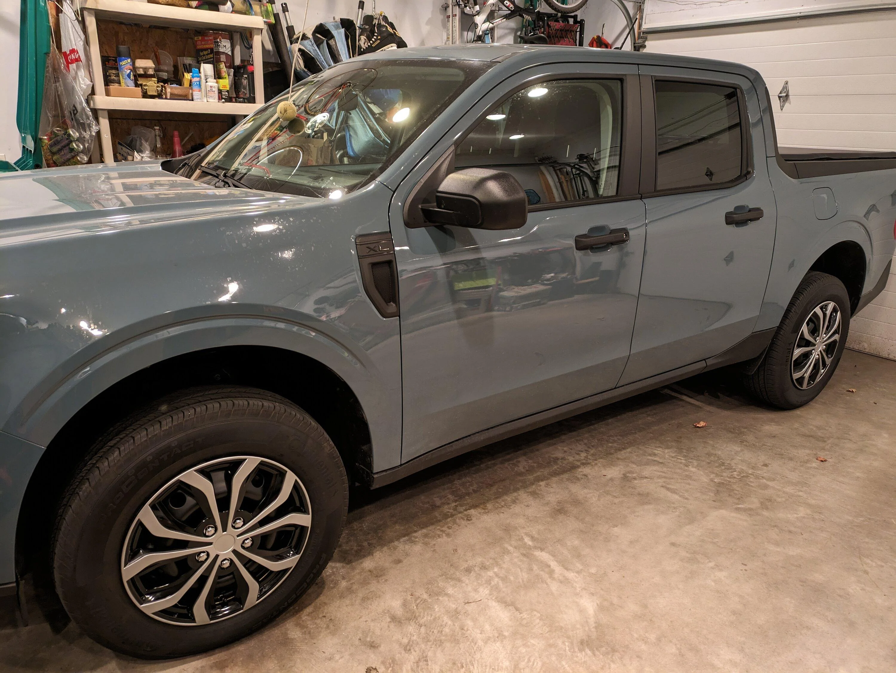

I saw others recommend putting on at least four coats, so I did five for good measure. The four wheels used exactly three cans of Plasti Dip which cost me $22 from Menards. I put it on pretty thick so left 60 minutes between coats rather than the recommended 30 minutes. The hub caps cost $55 from Amazon so my total steelie extreme makeover was a mere $77...and I'm really pleased with how they turned out.

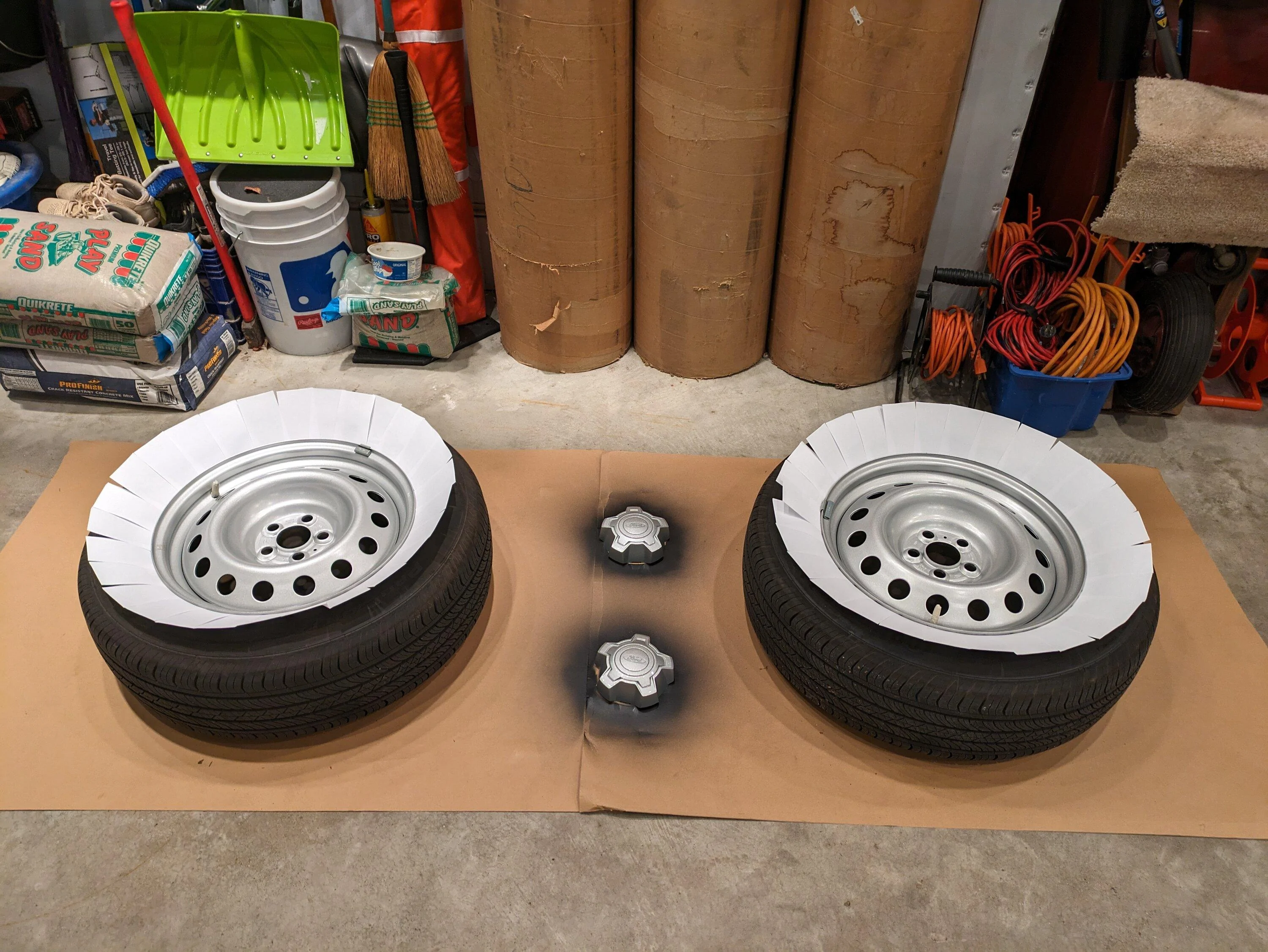

Cool. I picked up my XL Thursday & can't afford wheels. I can afford your steelie extreme makeover tho. Thanks for sharing the how to. Oh, how did you mask the tires?
I used Frank the Handyman's technique - cutting 8.5 x 11 pieces of paper and making a ring around the wheels. See the 3:10 mark in this YouTube video. Masking tape around the valves.

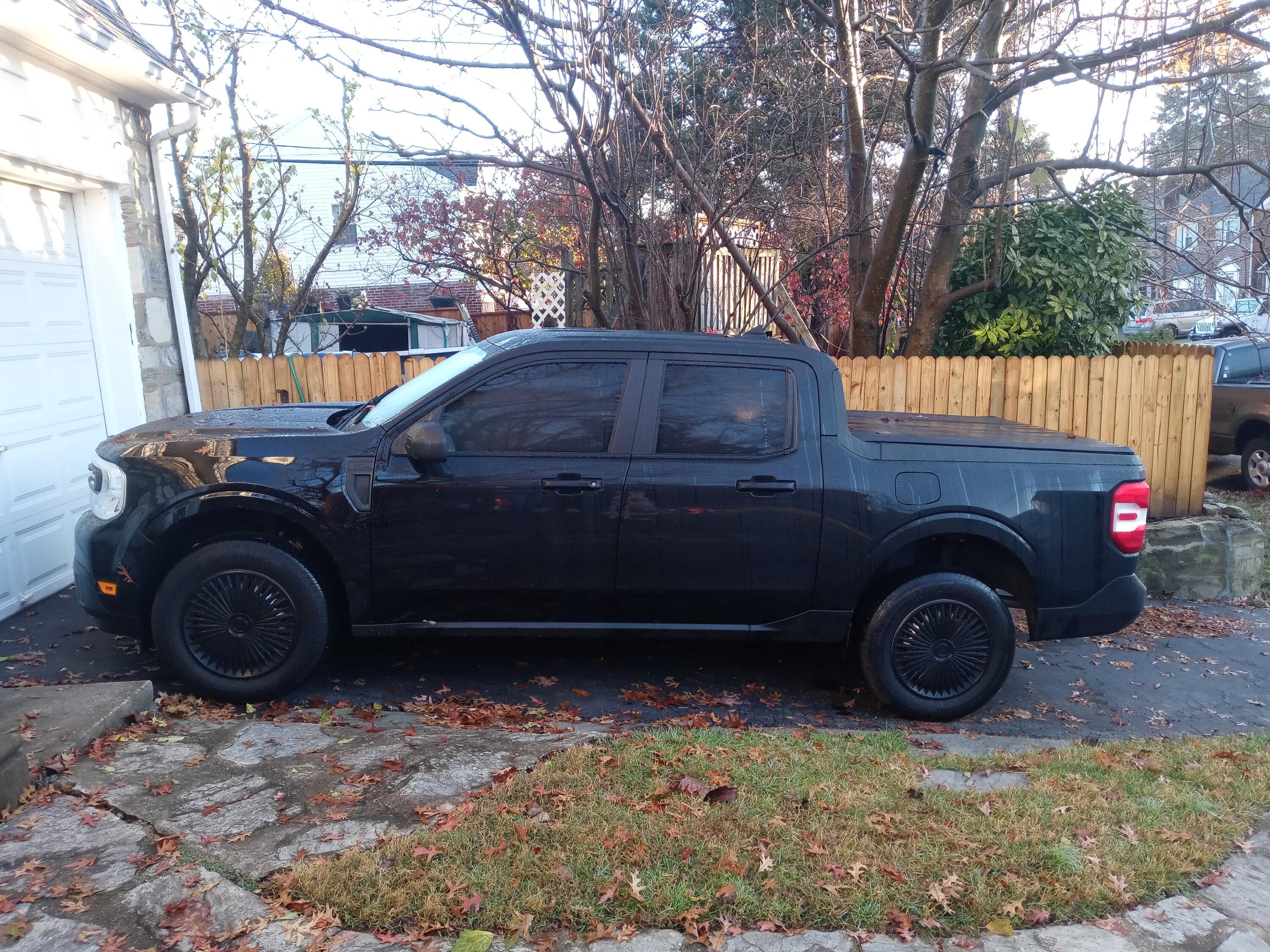

Your idea was my weekend project! I used 5 coats of matte black Plasti Dip on each steelie. Hub caps are from Amazon.

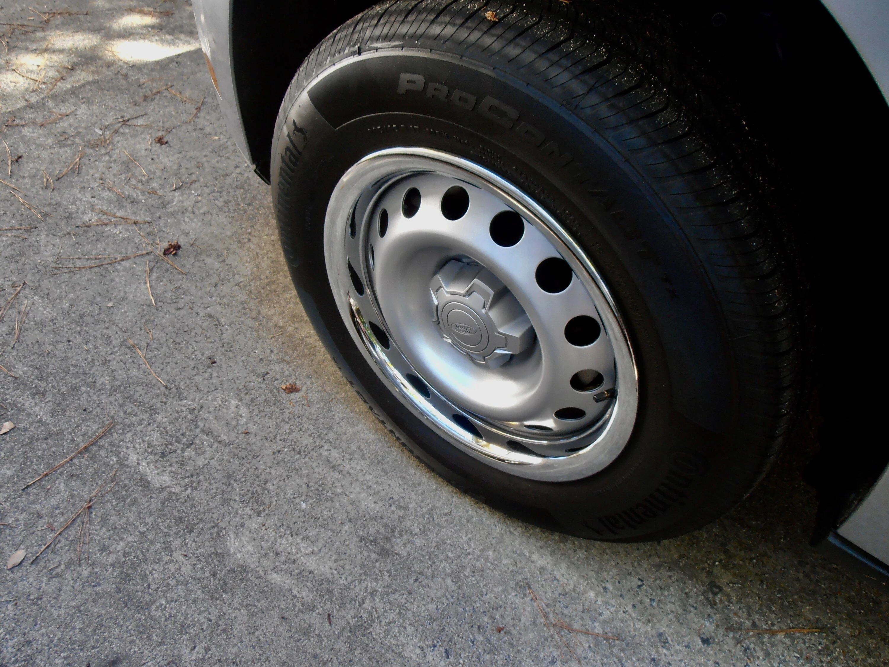

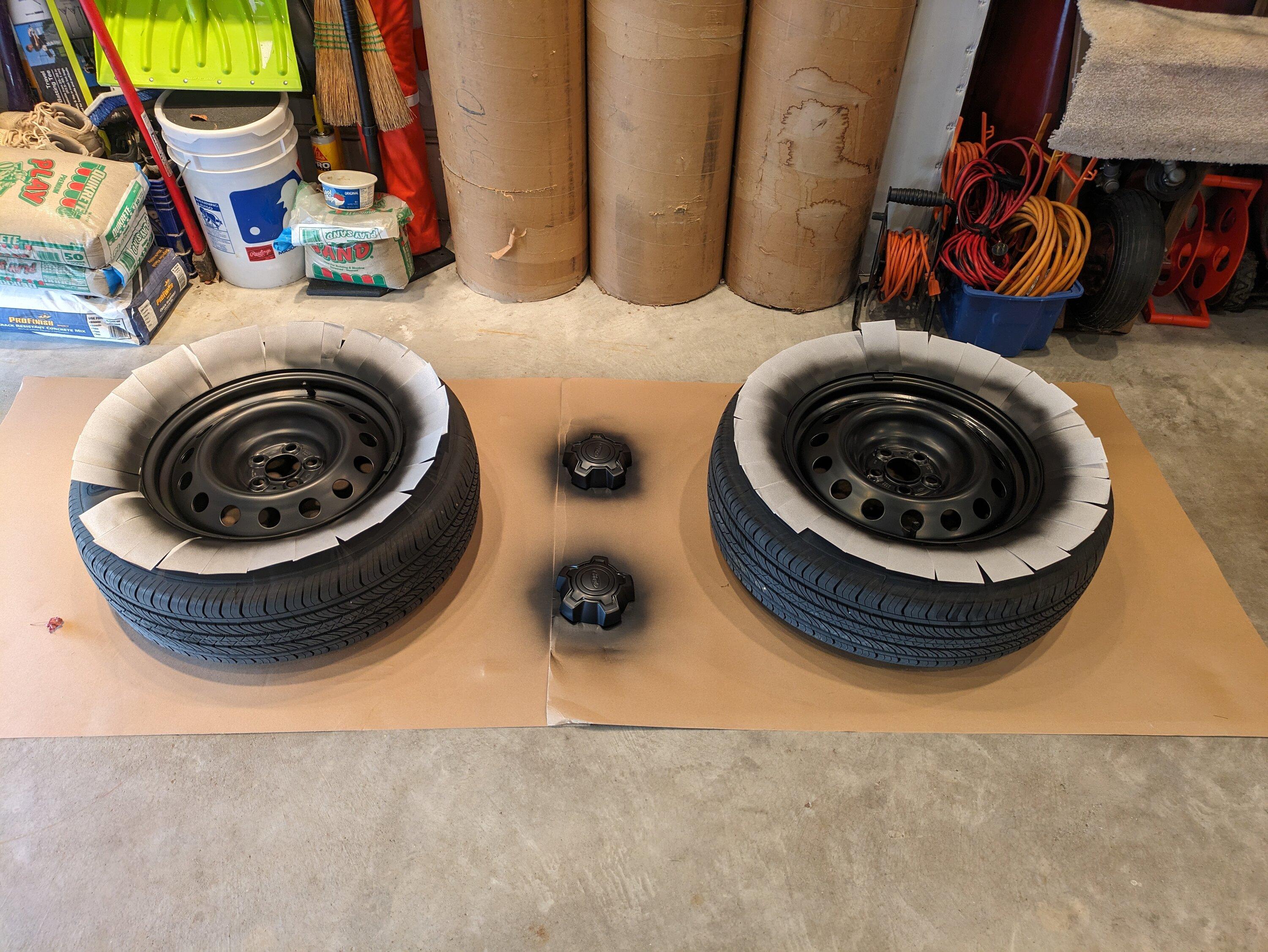

First I taped off the wheel, I found
Ford Maverick Anyone paint steelies BLACK and install hubcaps??? 20230901_161510
the best is 2" Masking tape as I could put it behind the rim on the tire.
Ford Maverick Anyone paint steelies BLACK and install hubcaps??? 20230901_161454

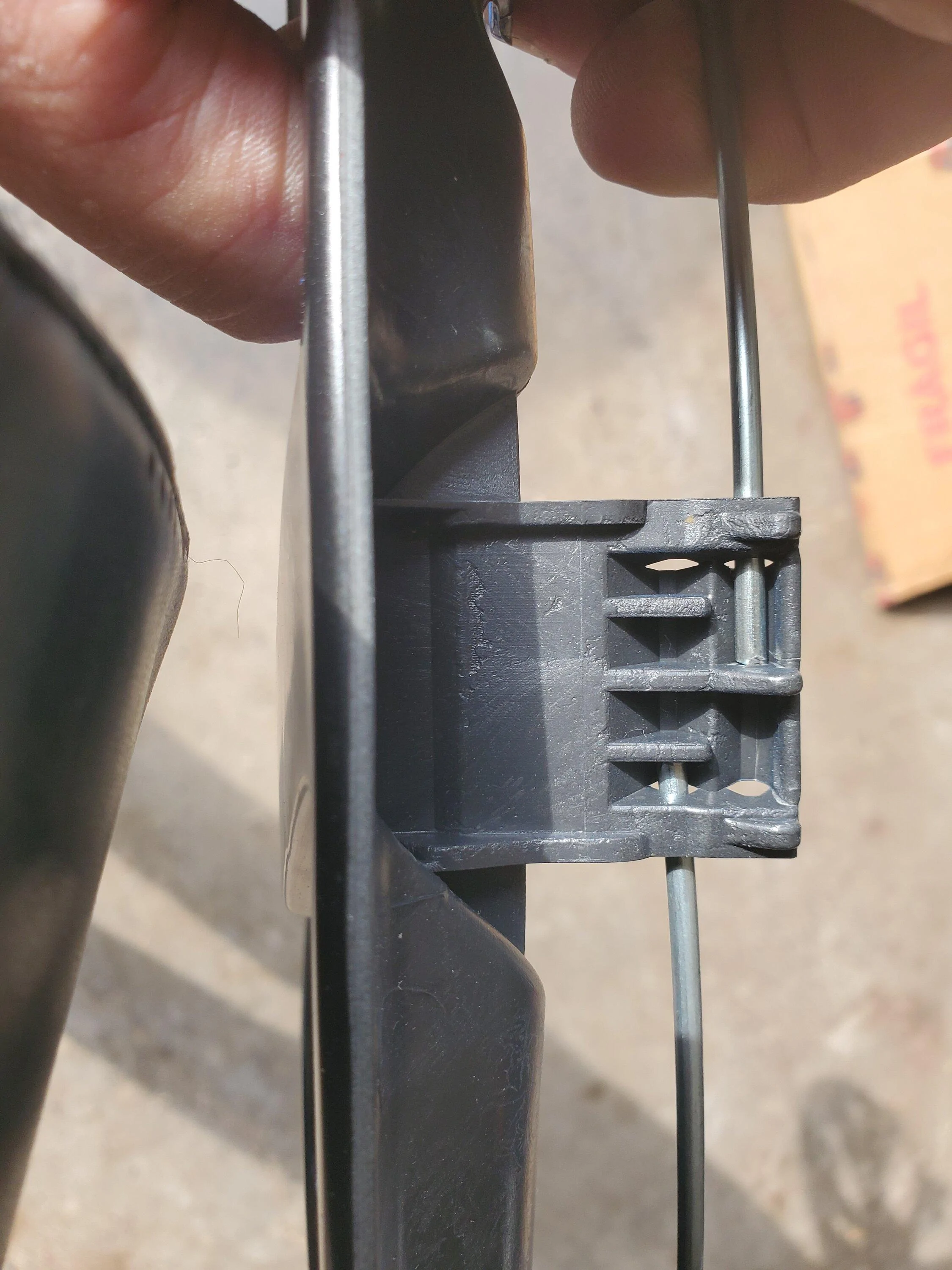

When putting on these hubcaps, you need to apply pressure on 3 points, so use your hands and a knee. They pop on nice and tight this way.

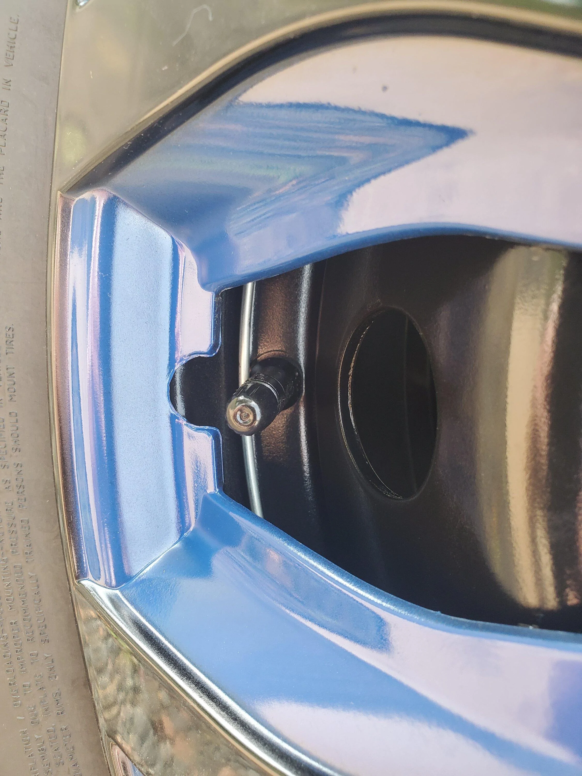

note: the steel ring on the hubcap goes on the outside of the tire valve.

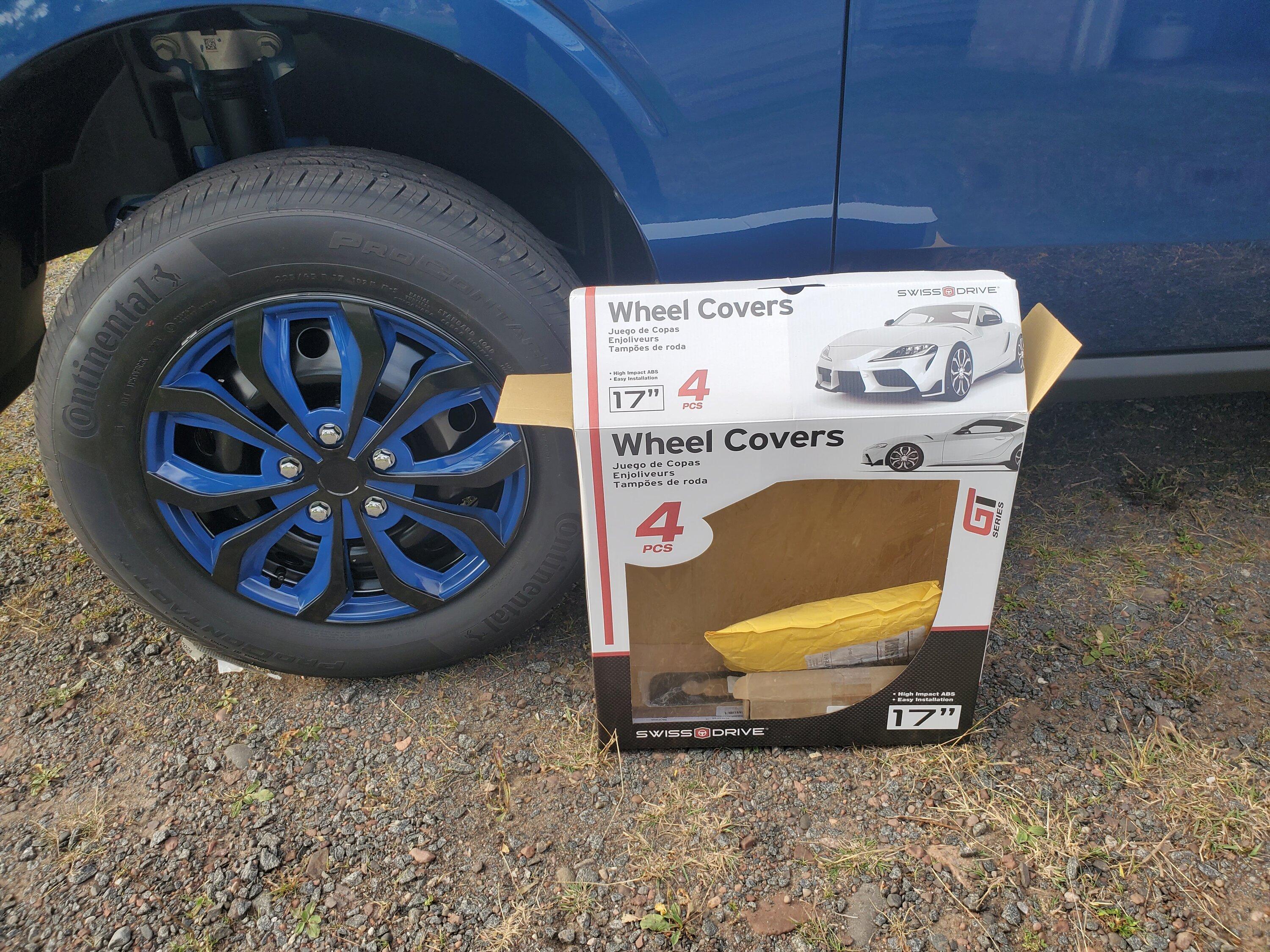

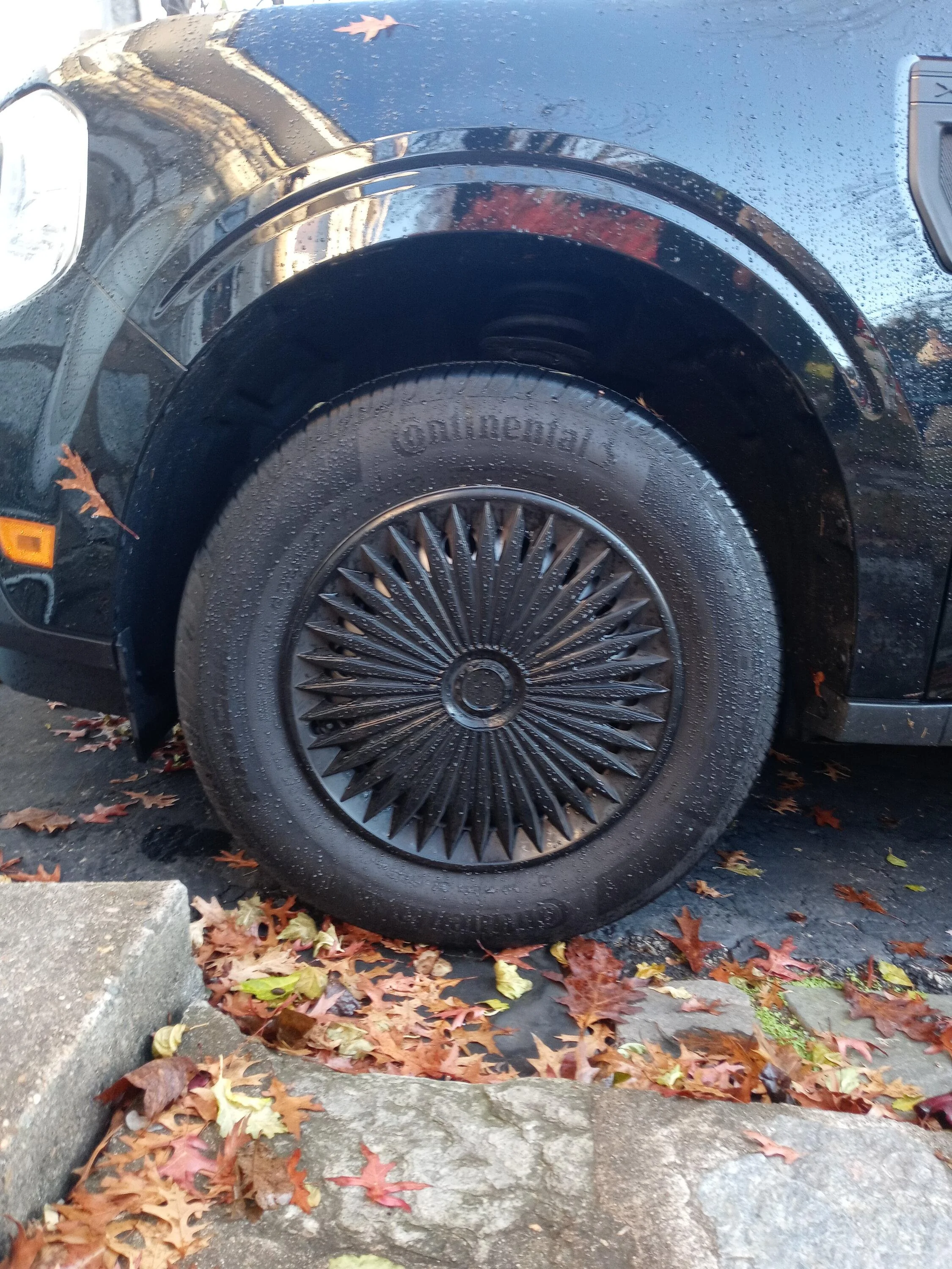

I like the look of the steelies. I put black wheel covers on my 22 XL ecoboost. A small part of the steelies can be seen, but i am ok with that. 60 bucks and a year later still happy.
Ford Maverick Anyone paint steelies BLACK and install hubcaps??? 20231127_075003
Ford Maverick Anyone paint steelies BLACK and install hubcaps??? 20231127_074955
