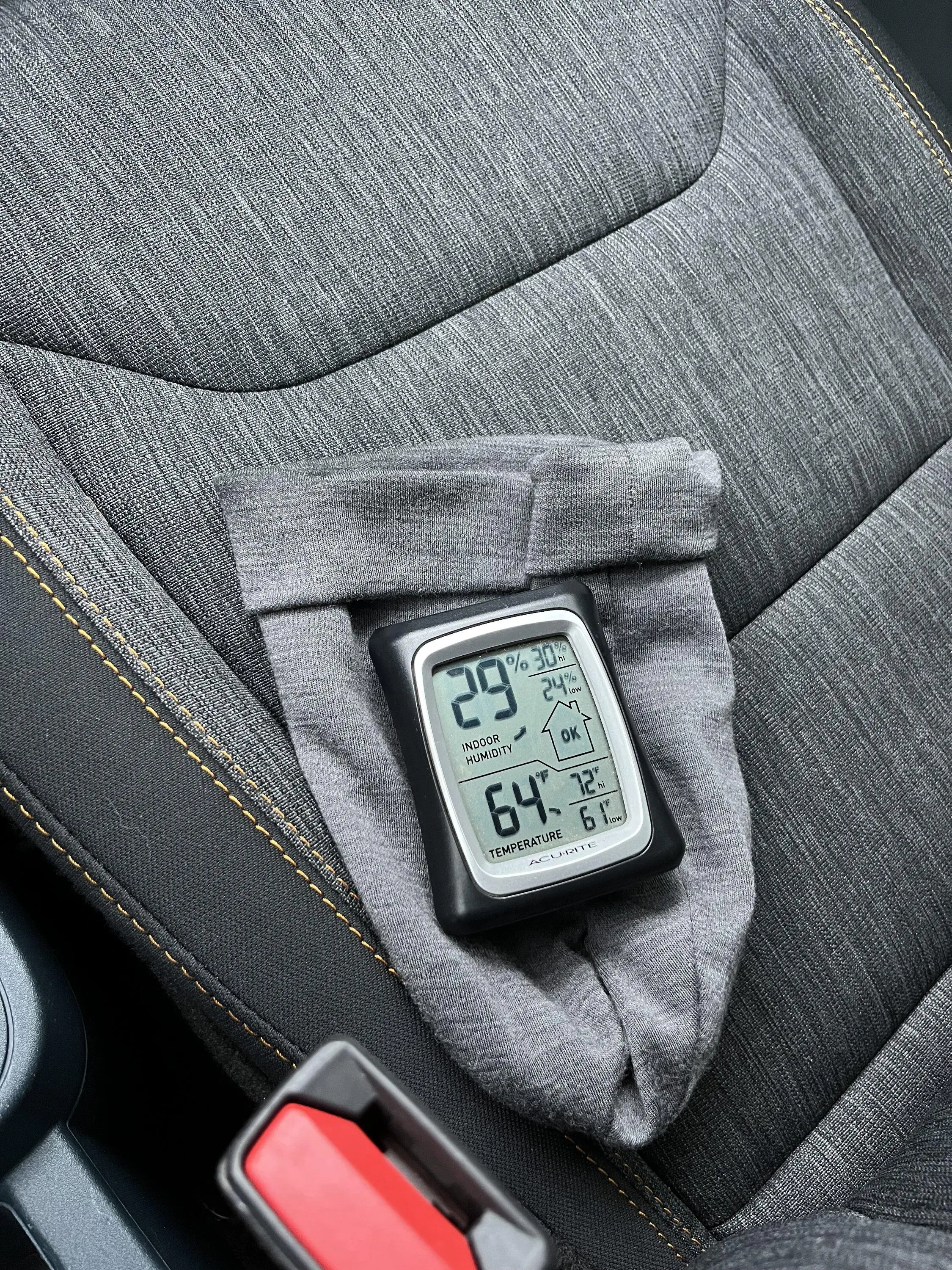

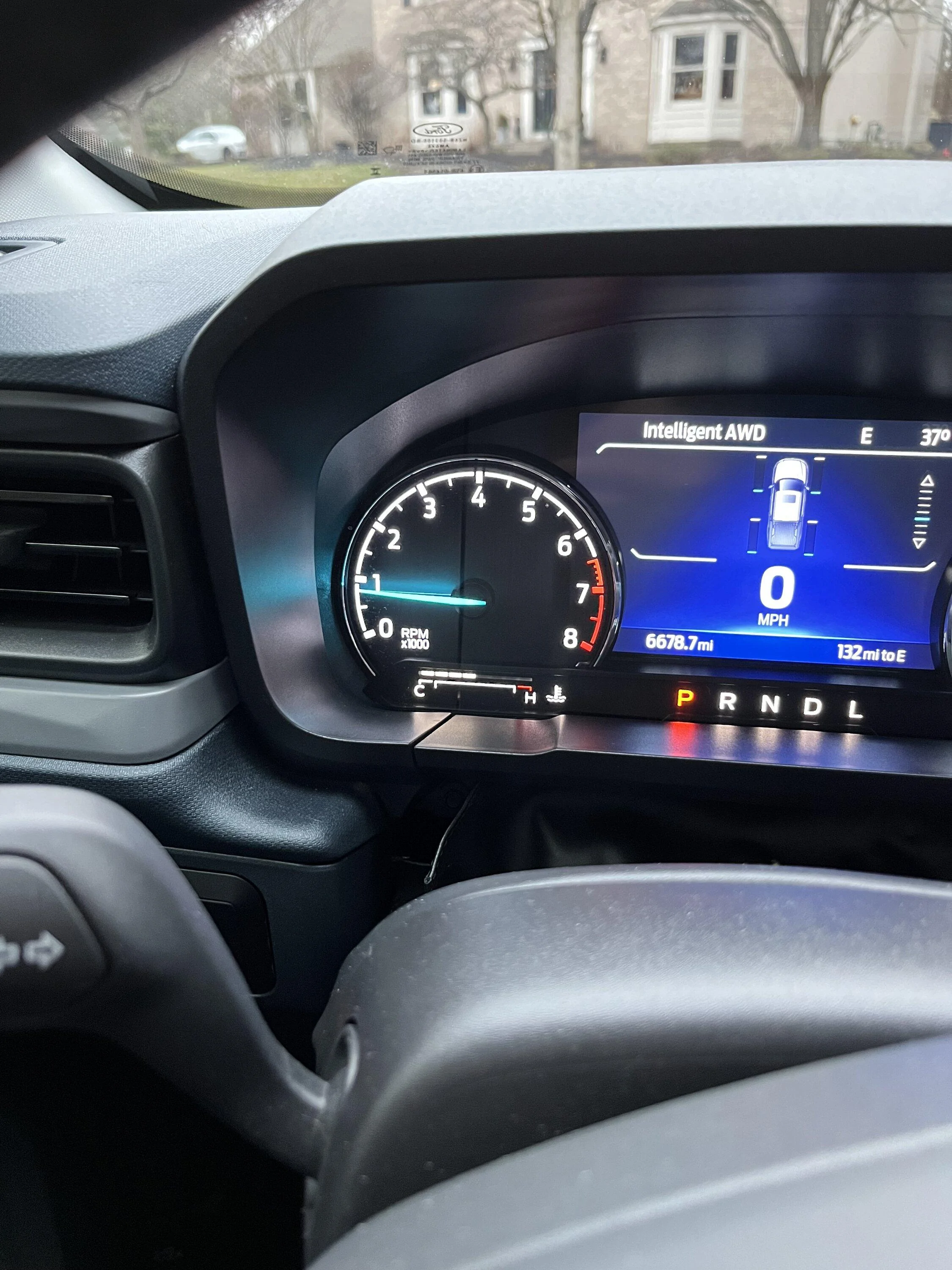

I didn't feel like waiting for OP to respond. Just did a 45 minute trip in damn near identical weather to OP. I set my auto-climate control at 68 degrees with full fan speed. My vehicle reached normal operating temperature (4 bars) and had ample time to heat the cabin to desired temp.
As expected, the ambient temperature on the front seat of my vehicle (with the thermometer on top of a hat that came from inside) was only 64 degrees despite the temperature for the auto-climate control set at 68, and the the fan speed reducing well before this

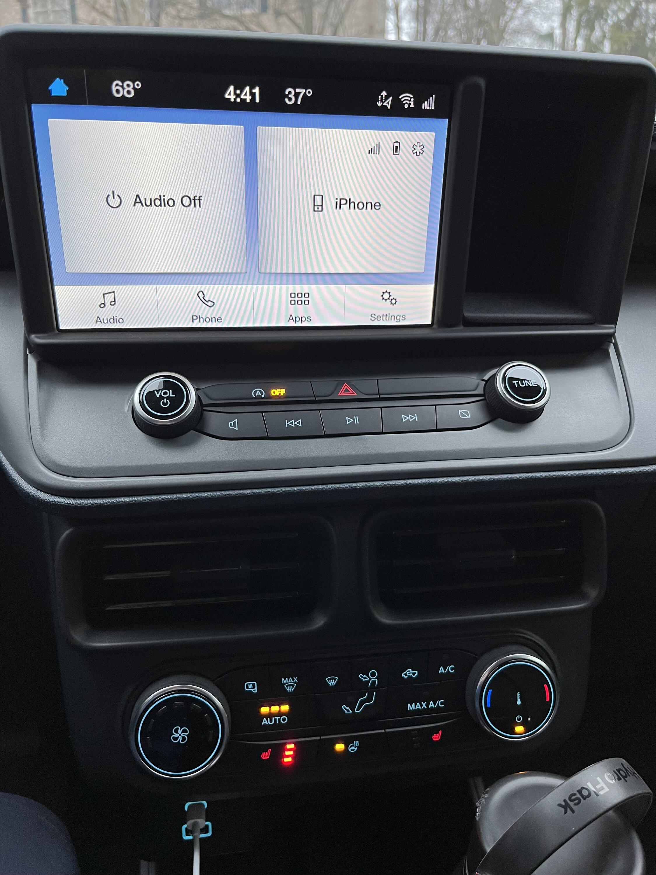

Climate was set to 68, full fan speed, temp outdoors was 37 degrees

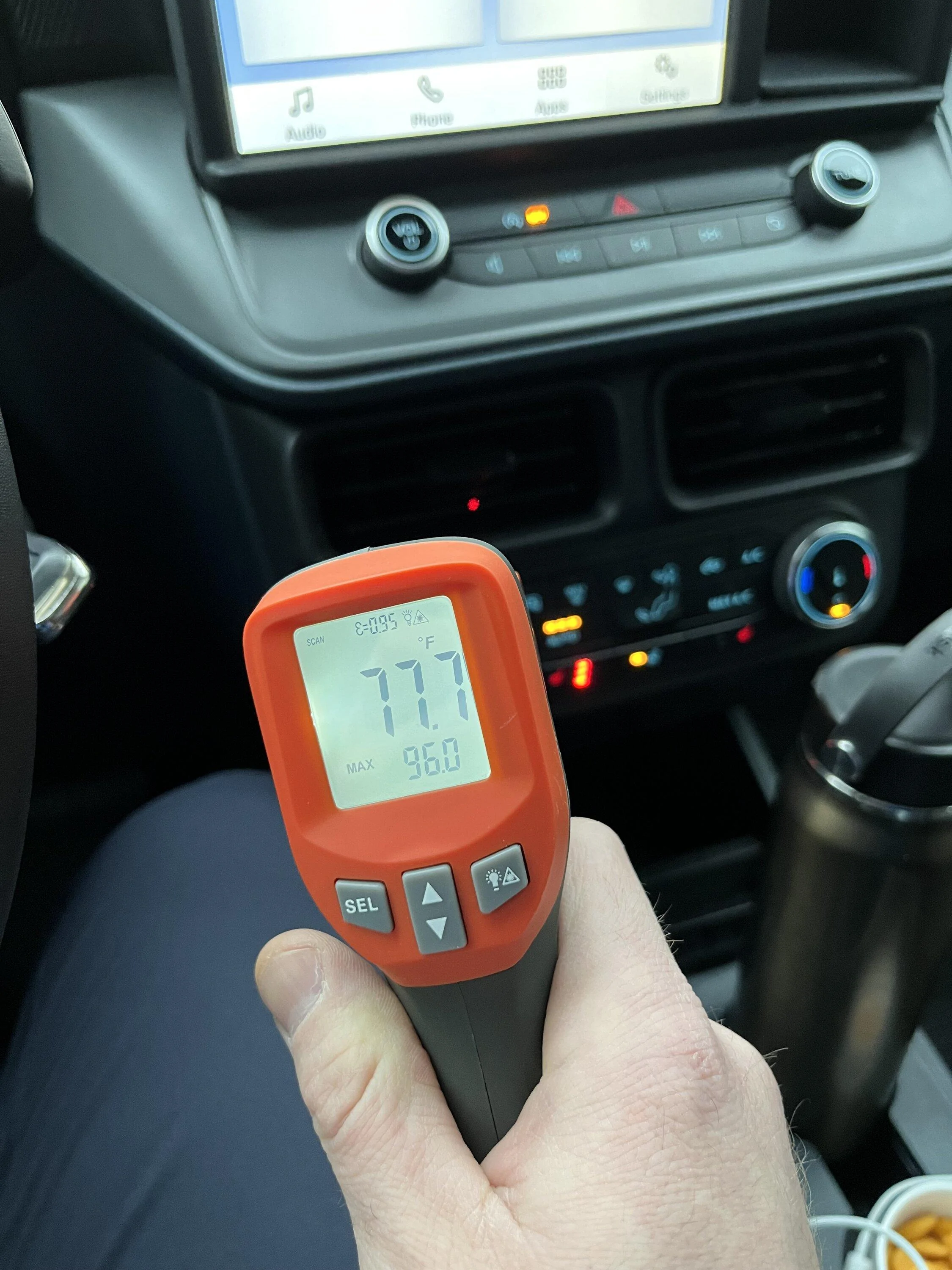

Air temp from the vent (which wasn't actually blowing - most heat was coming out from the windshield defroster - in the 80s).......was...........77 degrees
