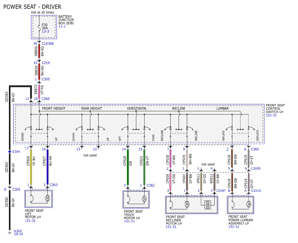

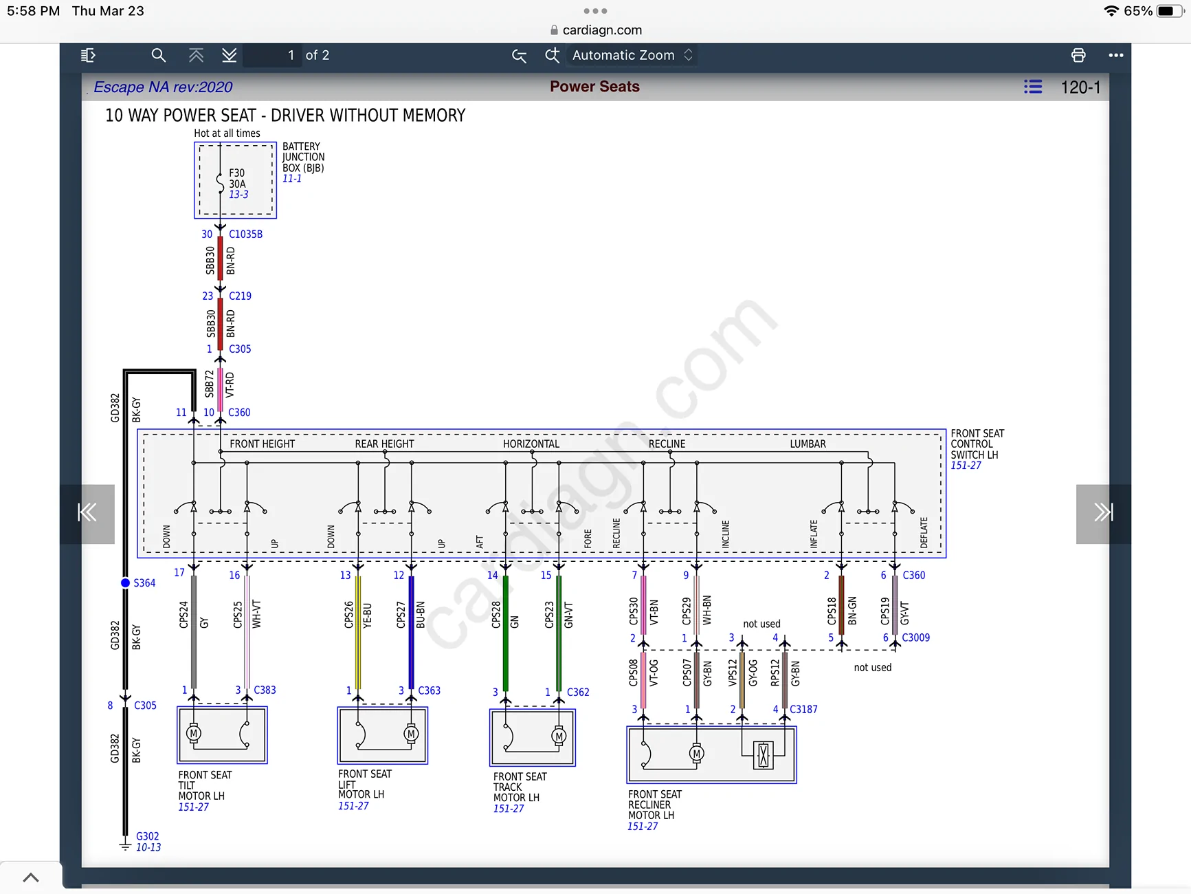

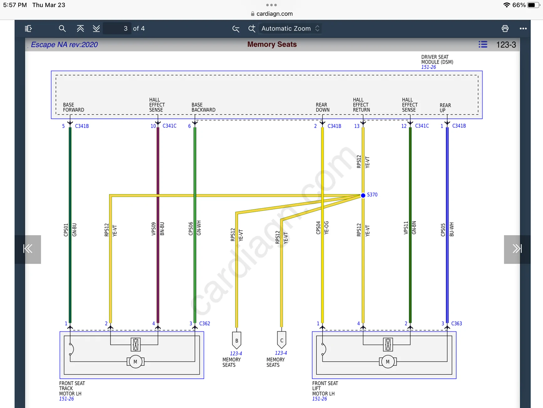

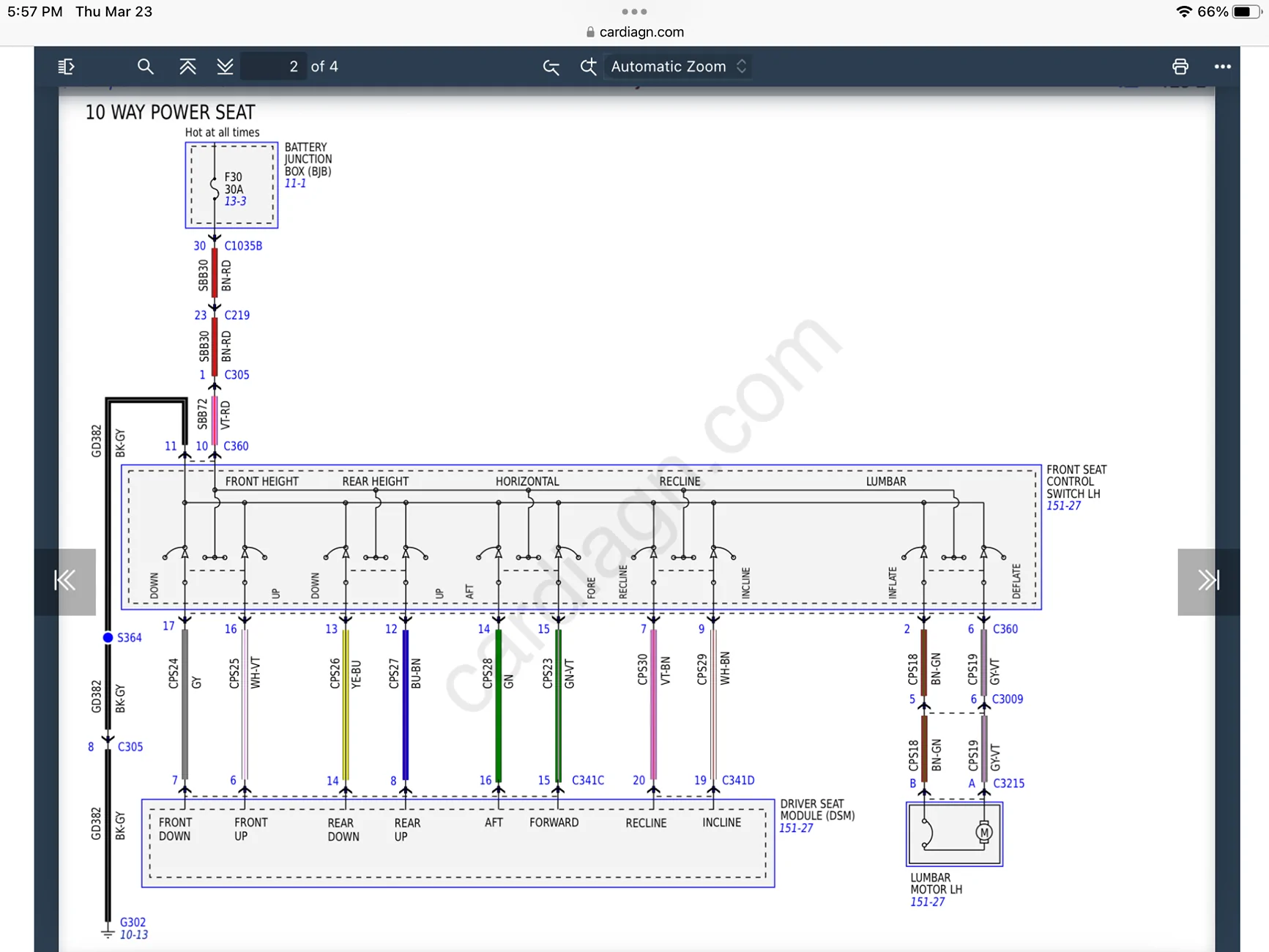

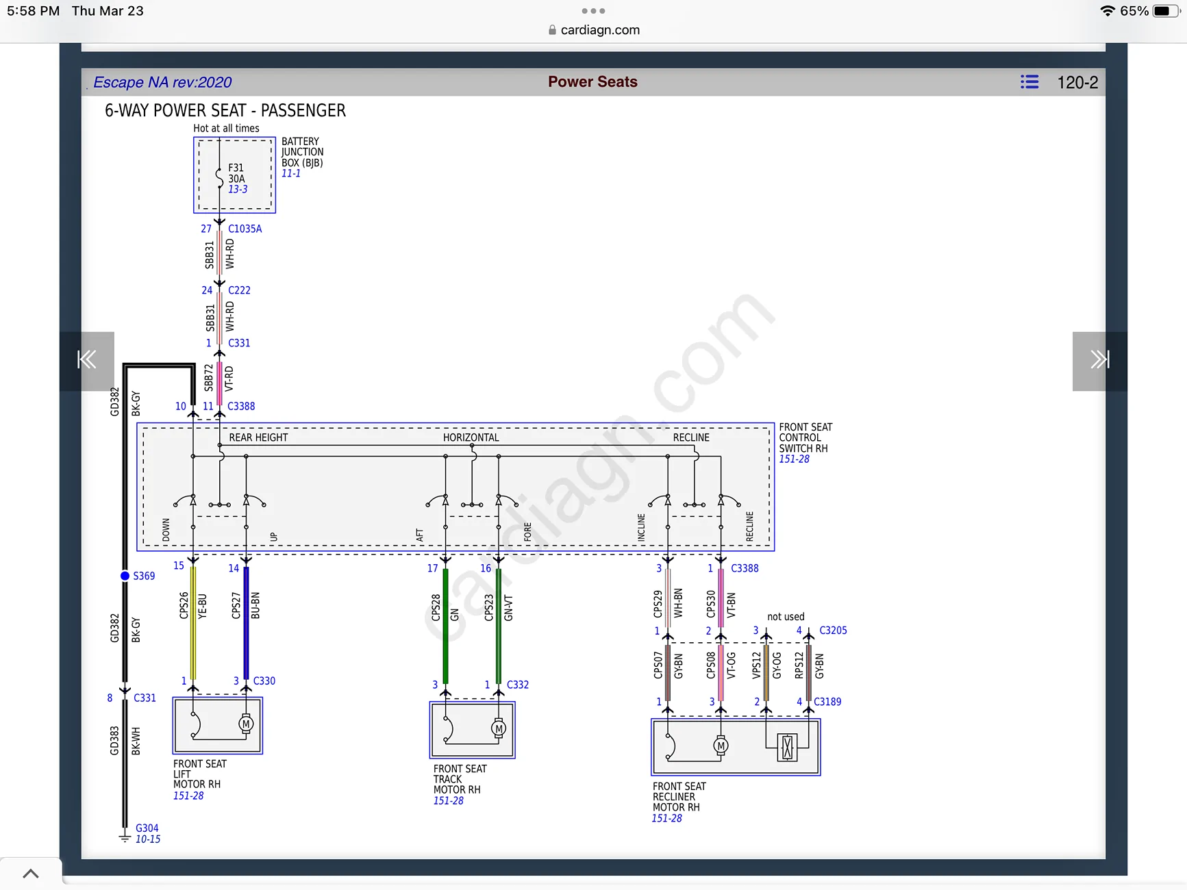

Here are some wiring diagrams I got before.
Looking at these, it seems the recliner motor, in our Mavericks, have a sensor in them. If so, you might be able to test with that.
First one is the Maverick; 6-way seat.

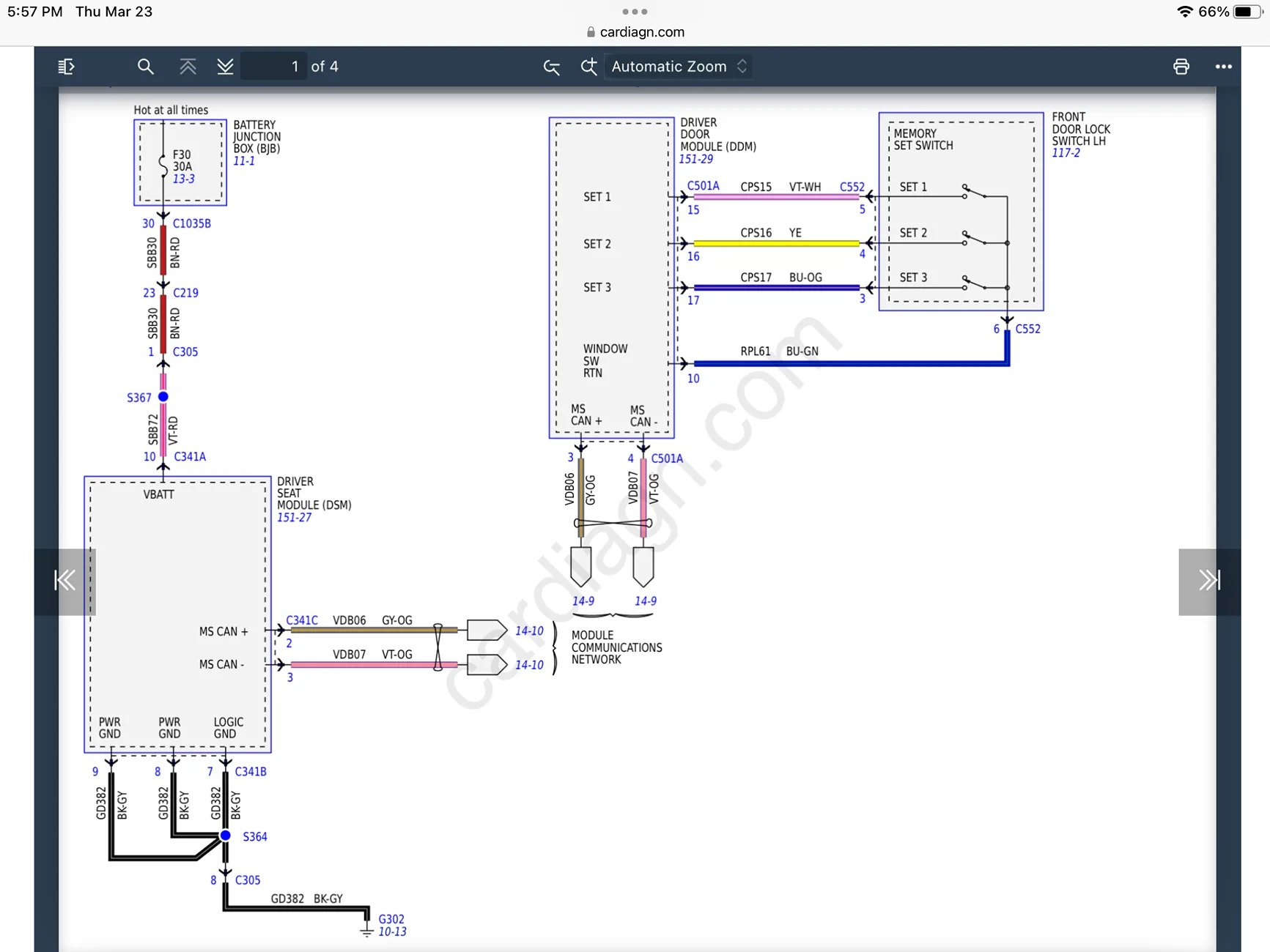

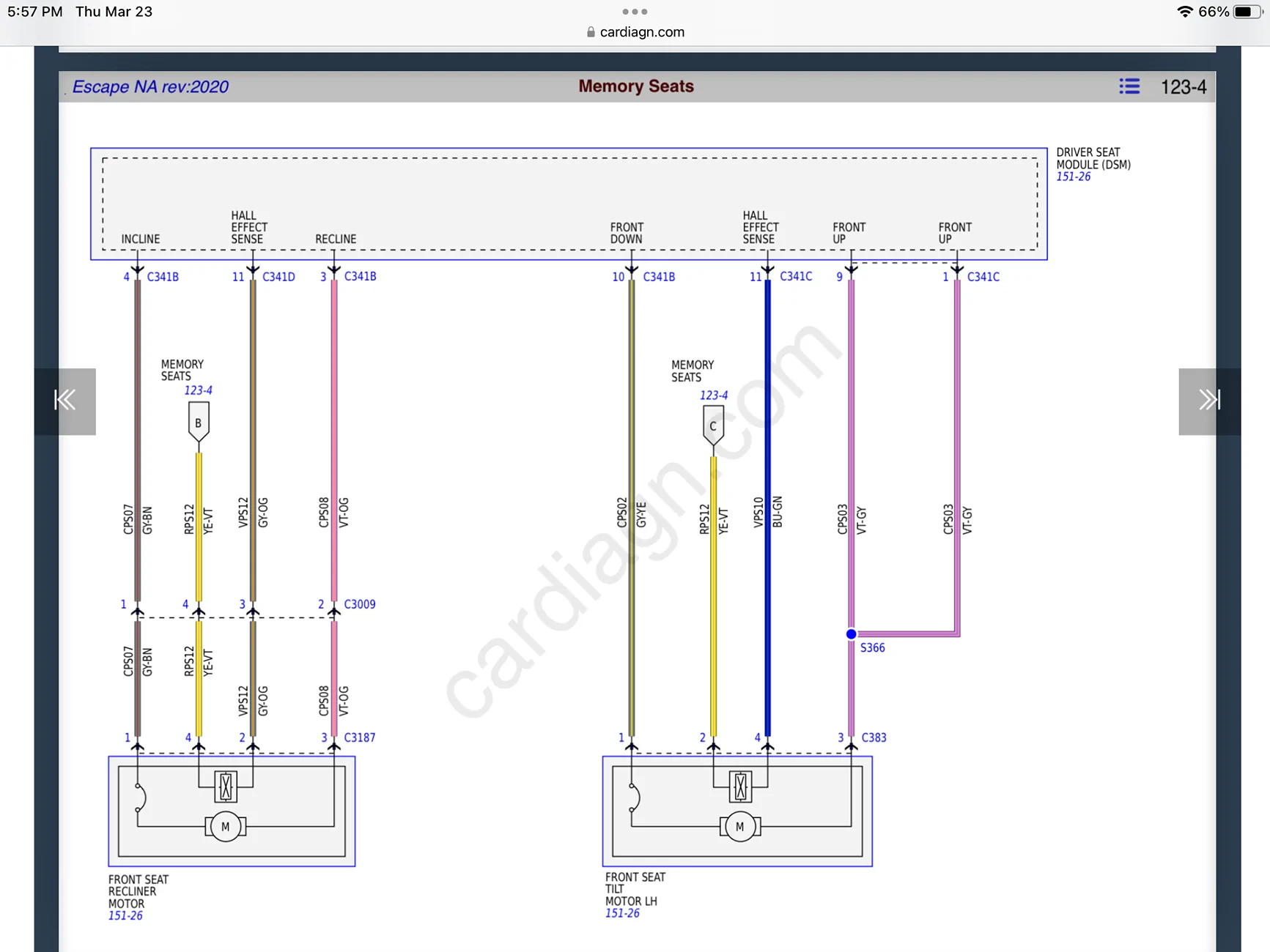

Escape 10 way power seat
These 2 are Escape again. They show the details of the sensor wire versus the motor itself.

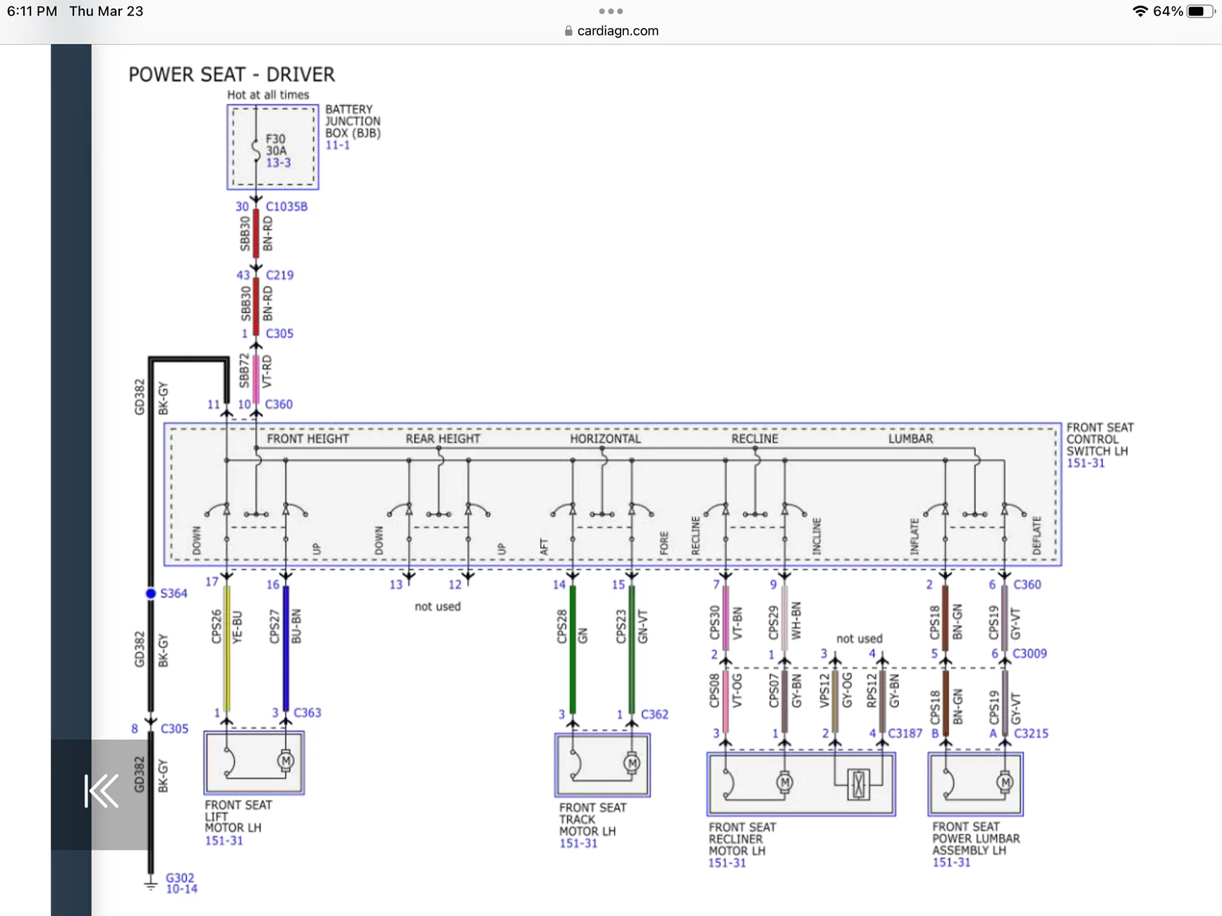

For reference, 10 way power without seat memory
This what the Escape power passenger looks like.
This is the memory seat switch.

These are useful. It’s promising that the seats use the same pins for the non-memory seats. What’s less good is that it looks like a Drivers Door Module (DDM) is needed along with a Driver Seat Module (DSM) and that they need a good amount of added wiring including through the doors and back to the fuse box.
