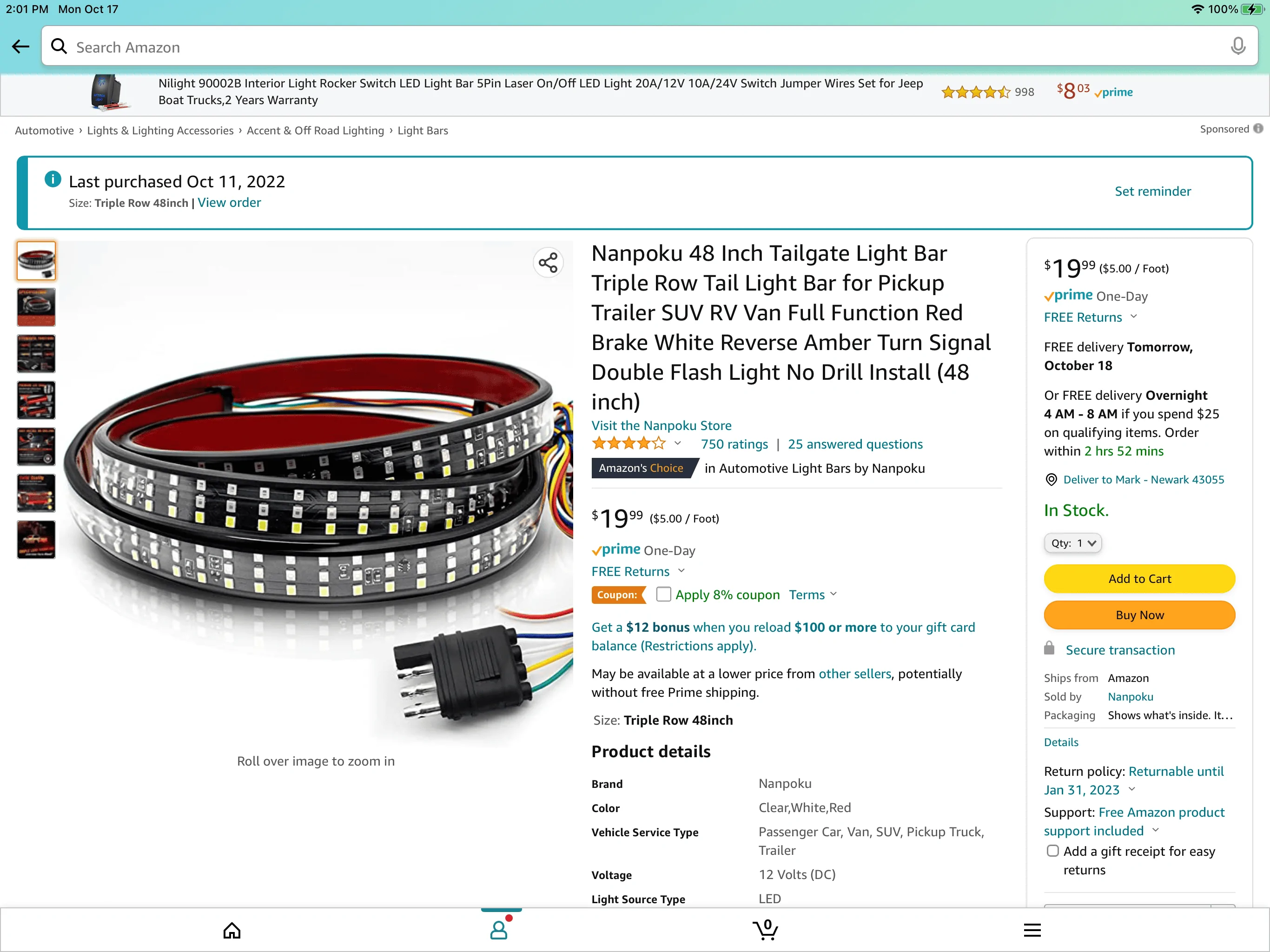

Any reason why these LED lights not working on hitch connection?

4 pin is 1-Running/Brake lights 2-right directional 3- left directional 4-Ground. The only way the LED can work is with the truck lights on witch makes no sense to me. Only need the running light wire and ground to make the lights work. Will they get brighter when you use the brakes?

If the description of the product you bought is accurate, it states 'amber' turn signals, the Maverick does not have those. I do know that vehicle 4 pin wiring is different if you have separate amber turn signals.
Interesting. Well, I think this is becoming a larger luxury than I thought it would be. Seems like it’s time to return It. Thanks.

Also remember led bulbs only work if current flows the correction. If you reverse pos and neg wires they will not work. The guy that rewired the 4 prong had to change the wiring because his truck was checking circuits and did not find a trailer so it deactivated the 4 pin plug. I'll see if I can find it.

I ended up getting a different set of led lights and plugged them into the hitch and they worked perfectly. However, the computer thought I had a trailer and disconnected some of the CP360 warnings such as blind spot and cross traffic. Someone here posted a uhaul video on wiring their hitch and now the led lights work and so do all the CP360 functions.
Good advice. Thanks!
Ok let's restate the 4 pin connections. 1-is actually running red light and will light both sides using the weaker filament in the bulb 2 - is the right directional and uses the stronger filament in the bulb and will blink the bulb 3 - is the left directional and uses the stronger filament in the left light and will blink the bulb. And walla 4 is the ground! When you step on the brake both sides of the trailer or whatever you have plugged in will light up the stronger filaments in the circuits. The 4pin on the maverick appears to have additional functions for the computer to enable and/or disable when a trailer is connected. I suspect that a male to female 4 pin adaptor would be required to be plugged into your light bar with the #4 white wire in the new adaptor not connected to your light bar. This would be so the computer will not think your bar is a trailer. Depending on how the computer is programmed you may or may not have your light bar work. Ground the light bar circuits elsewhere not through the ground wire used as a sensor for trailer.

Is the 4 pin like the 7 pin on 4k tow? If trailer is plugged in it disables the auto start/stop?
