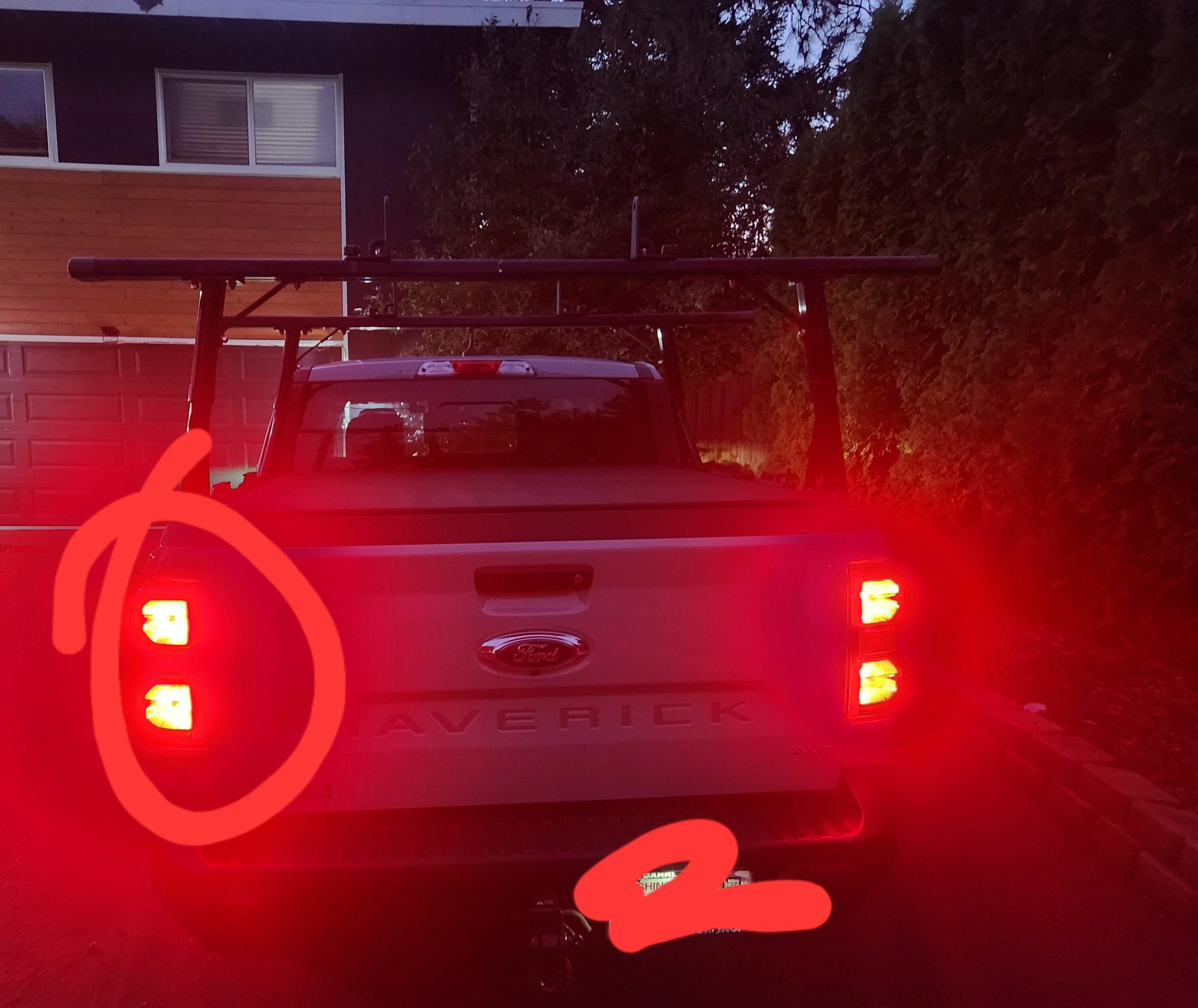

it was 10 degrees F when this happened to me
So far no repeat. It was right at freezing this morning and it seemed to work fine. I do have all my stock bulbs in a drawer somewhere, so if it happens again I might swap them back out. But I doubt it is the bulbs.
It's not the LED bulbs. When I had the issue, I put back my original OEM bulbs and it still didn't work.

Mine is not working again. Started on the coldest day this year so far. Temp was only 29 degrees F.

For me, I did not get any sort of notice. I often wait with my kids at the bus stop, leaving my truck running while we are out at the stop with the other neighborhood kids. One day I noticed one side was "out" when I glanced back at my truck. That is when I tried all the troubleshooting where I had someone watch while I pressed the brake pedal (lights came on just fine), tried the turn signals (lights came on just fine), etc....

No notification. I notice when I use my remote and unlock the car one side tail lights (right side) no work. But when you hit the brake pedal they light up.

The cold weather is definitely what triggered it. My guess is some wire harness is affected by the extreme cold.
It was so cold both times this happened that the hard rolling tonneau cover was difficult to roll back.
It's strange this is what "alerted" me to the issue reoccurring.
