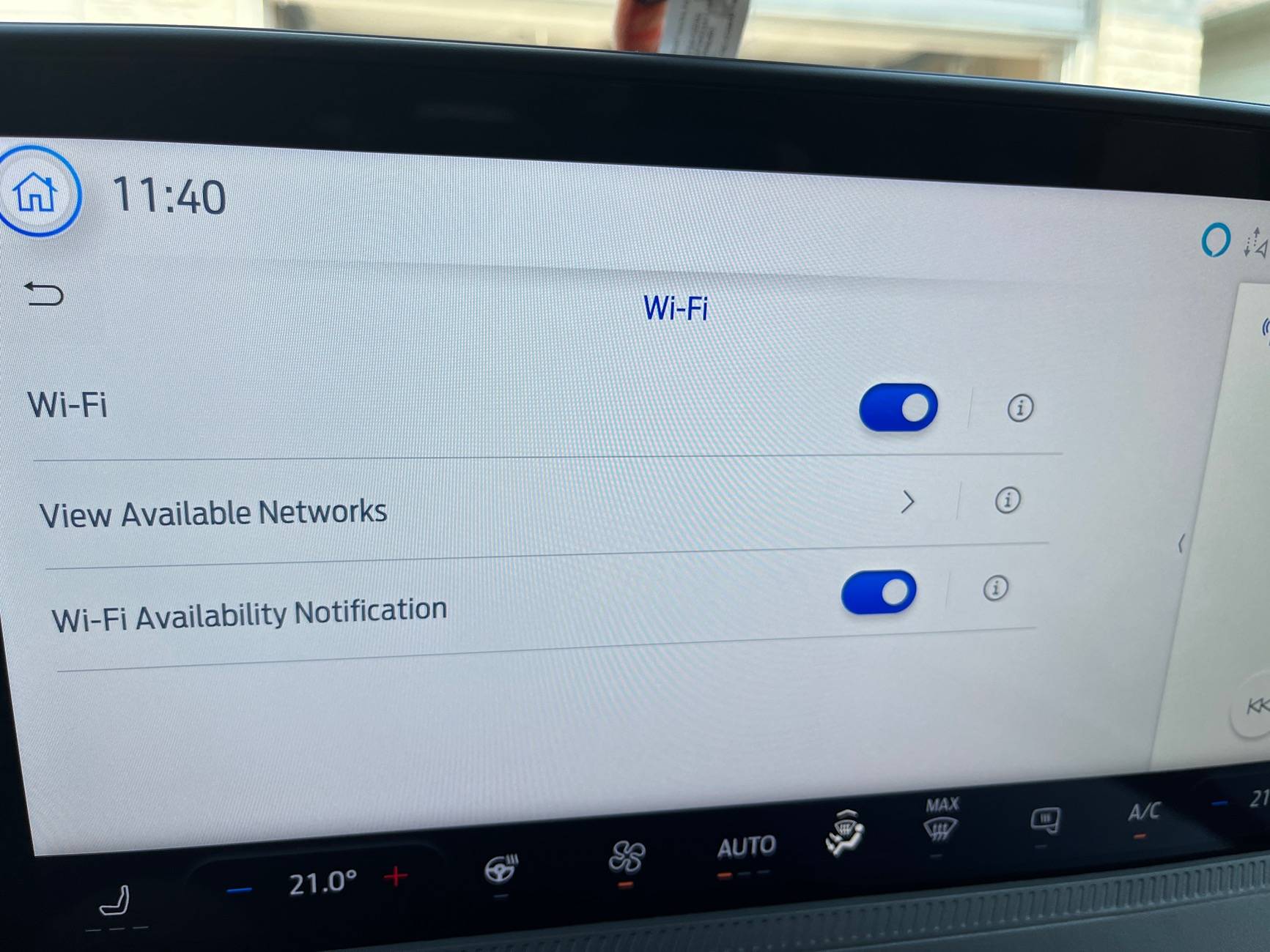

Sitting in the garage and on my driveway my ‘25 Maverick doesn’t see my wifi. Yet my RV that sits further down the driveway connects its Sync no problem to my wifi and the Blink camera in the RV connects no problem as well. I have tried adding my wifi connection but since it doesn’t see it it didn’t connect. My ‘14 Escape had no problem connecting as well.
Anyone noticed this with their Maverick, i don’t think there is anything else i need to turn on.

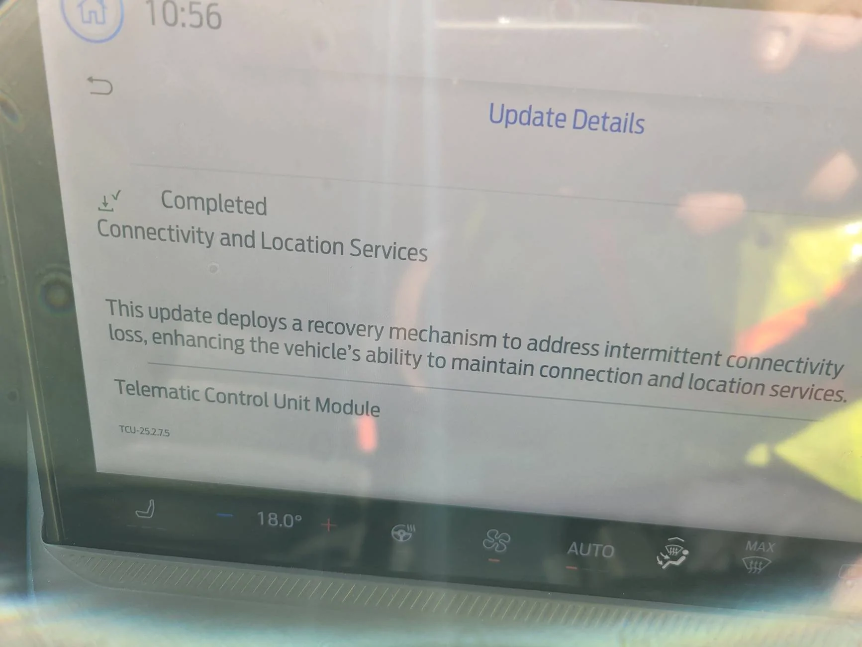

May not be the issue, but make sure this wifi update is installed.
