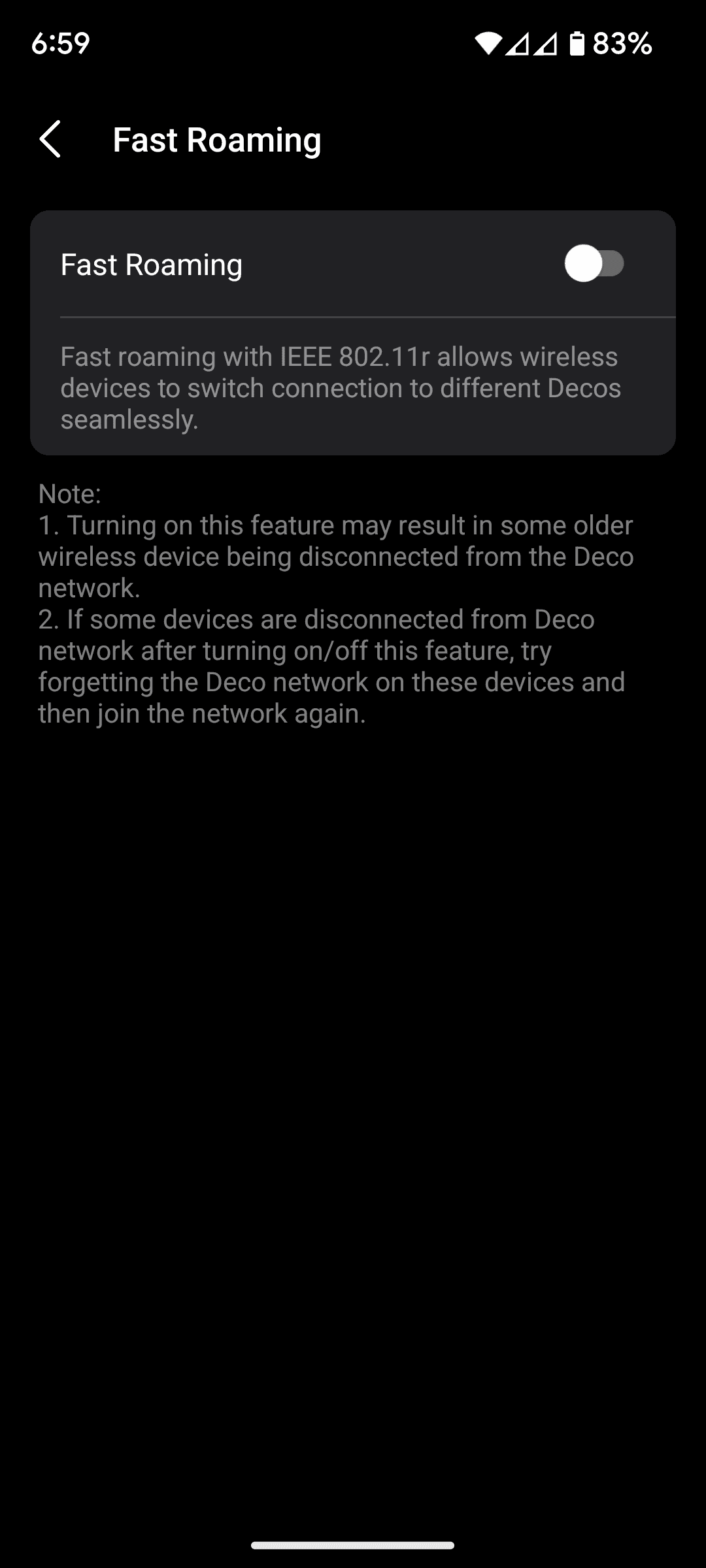

I was having trouble connecting my truck to our home wifi network. Not often needed, but if you want OTA updates, it's required. I searched the internet and found information on a different model Ford forum that worked for me.
If you have a home mesh network and your truck won't connect after multiple attempts you may try turning off "fast roaming" on your home network. I did this and it connected right away.
I'll have to see if any other devices now have issues because of this change. My guess is not, as the only devices that move around in our network alot are our phones and the dogs tracking collar and they seem to still behaive the same, so.........................fingers crossed.
