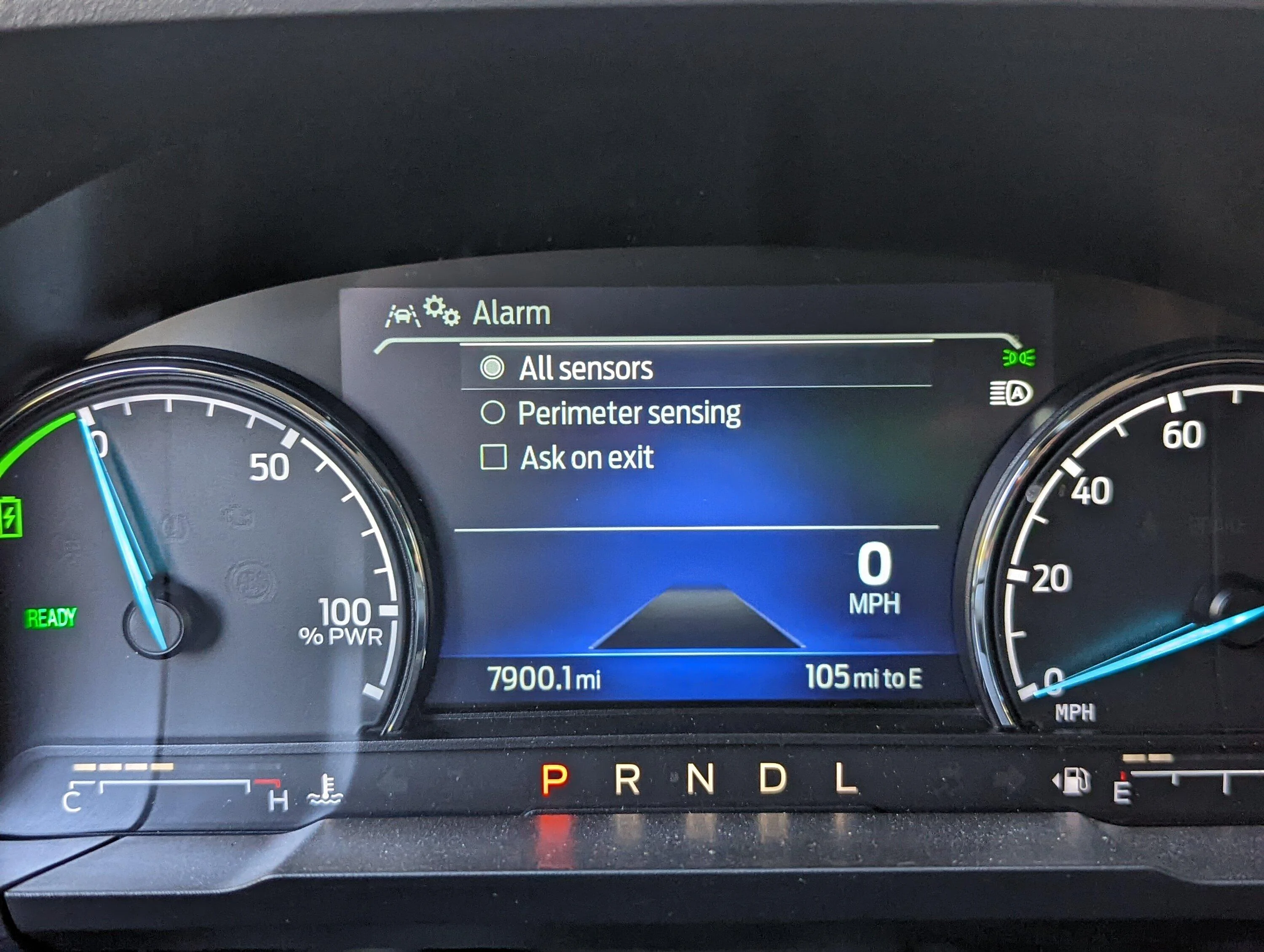

I added the setting to mine with Forscan but it doesn't do anything. Whether you set All Sensors or Perimeter Sensing the Perimeter Plus is still active. No way to turn it off.
The setting was meant for vehicles with Interior Motion Sensors, which Maverick doesn't have even though mentioned in the manual, so you could disable the interior sensors.

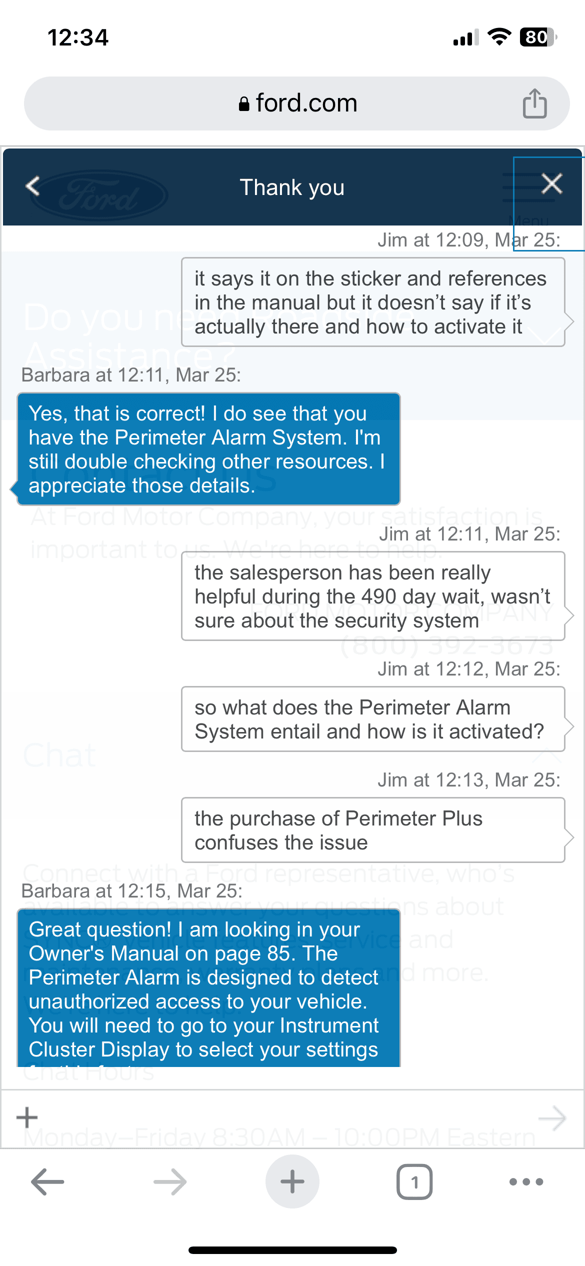

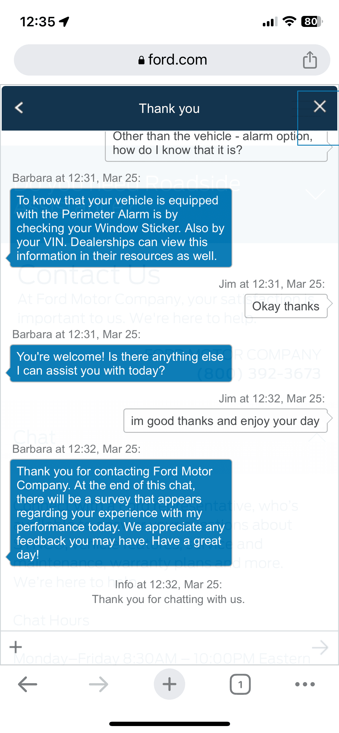

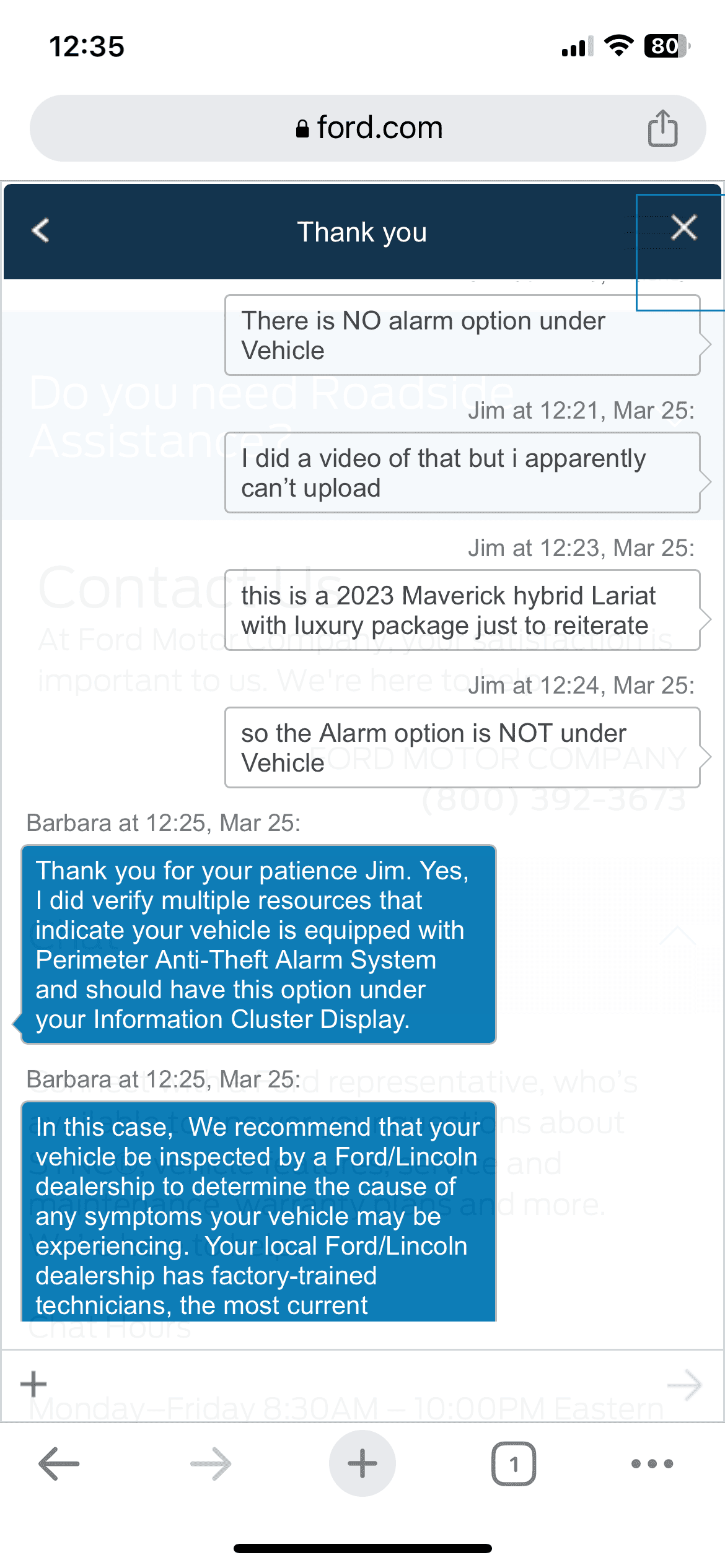

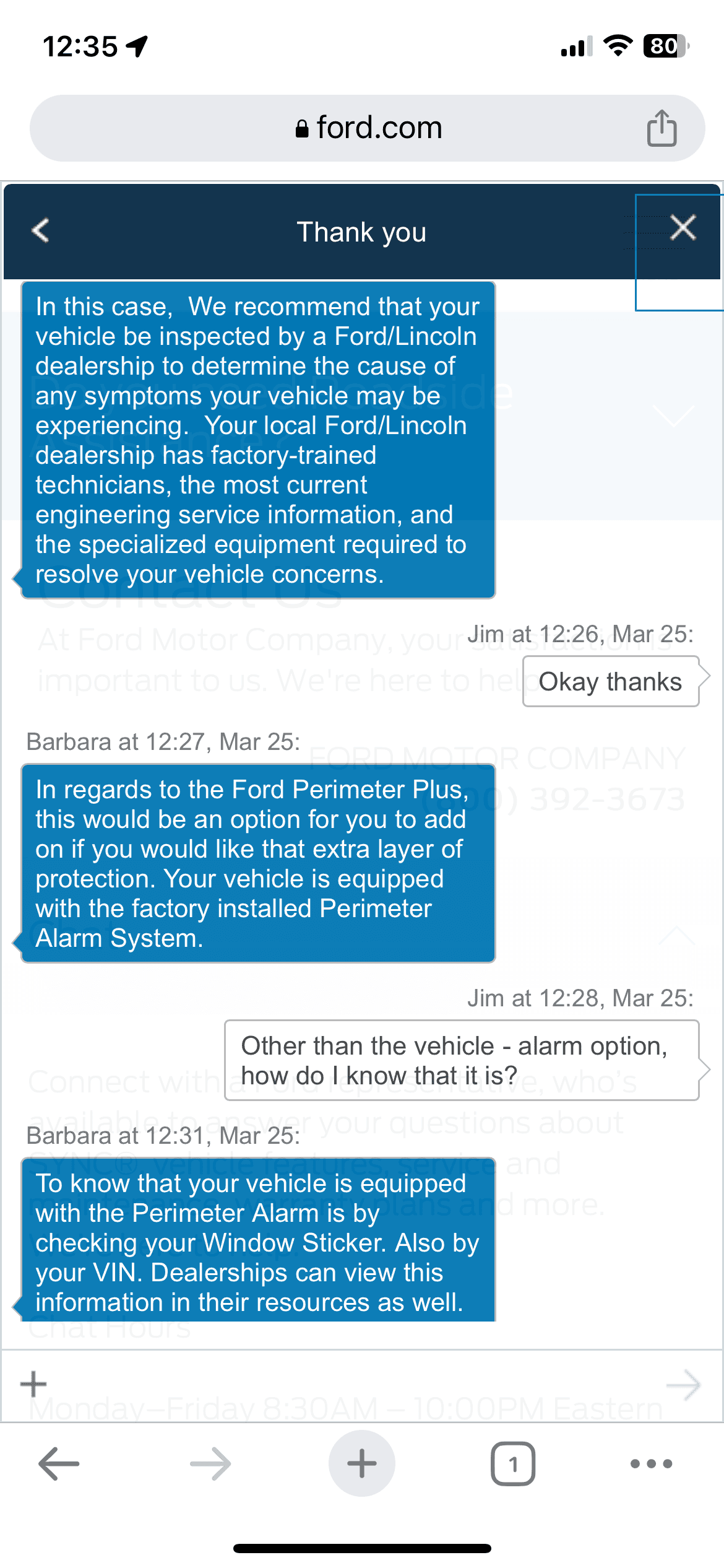

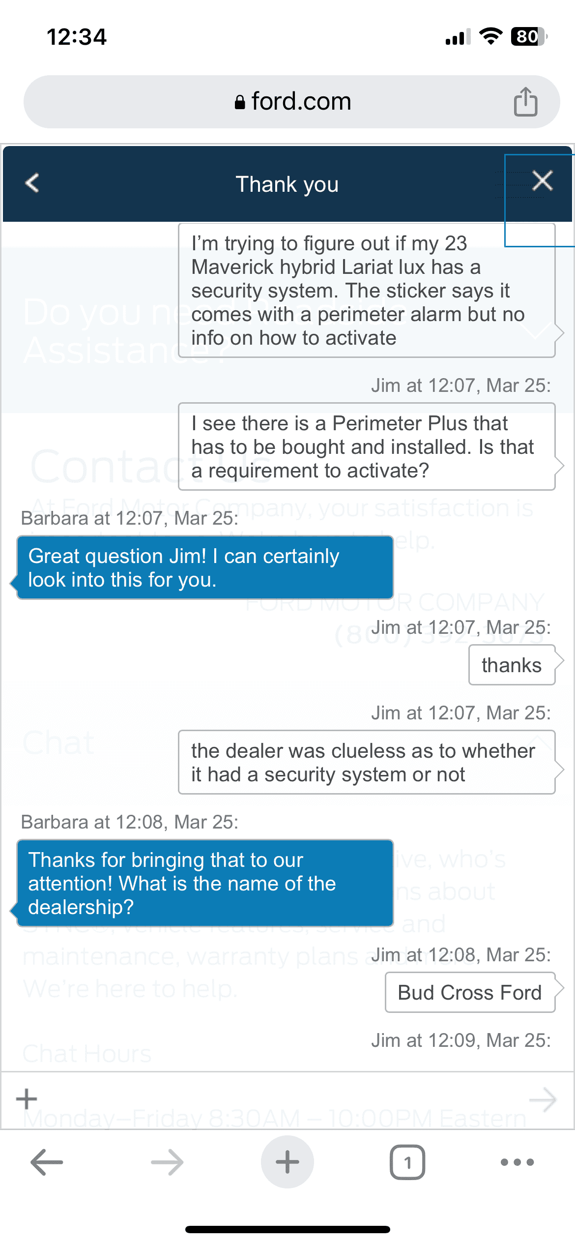

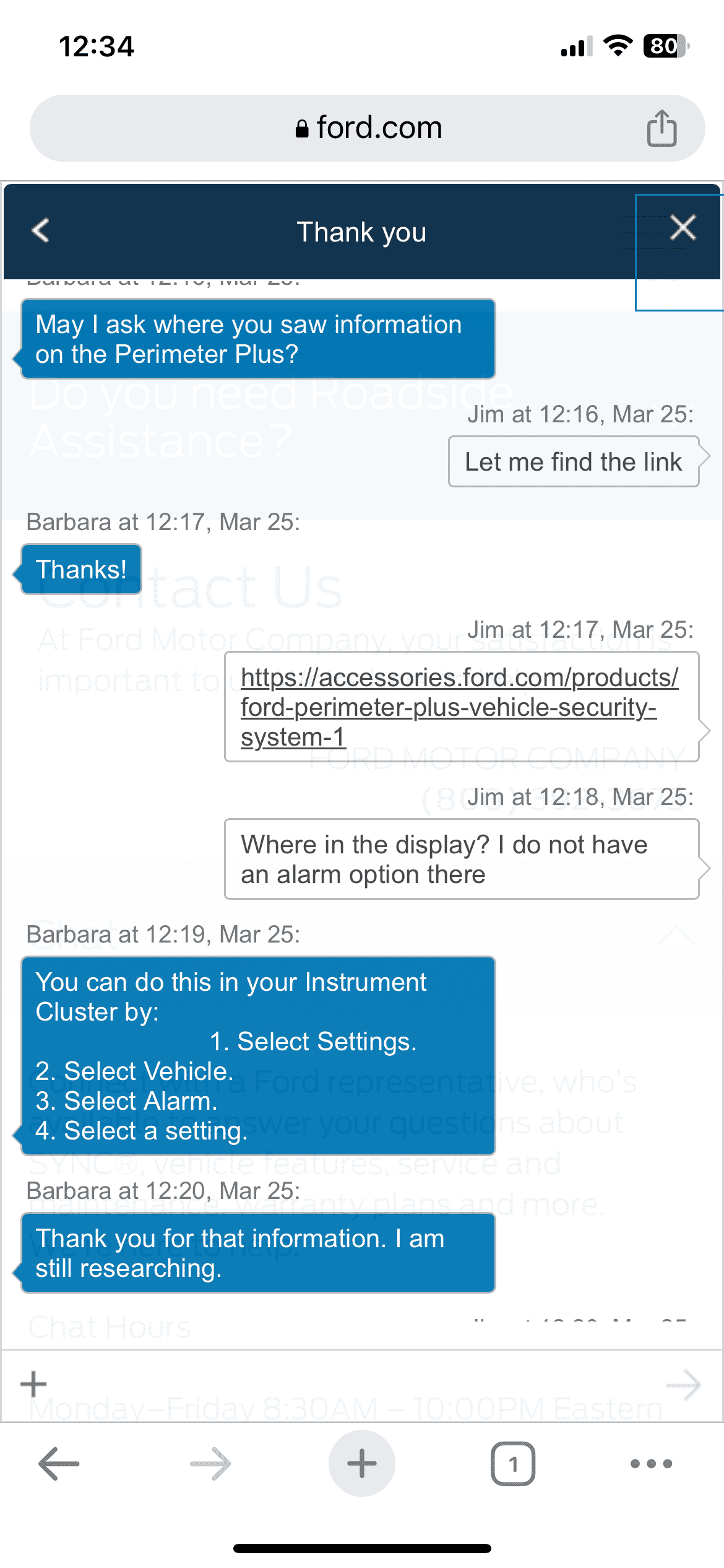

My screenshots on my conversation with Ford Chat in regards to the Perimeter Alarm for the 23 Maverick Lariat Lux. No help here…
