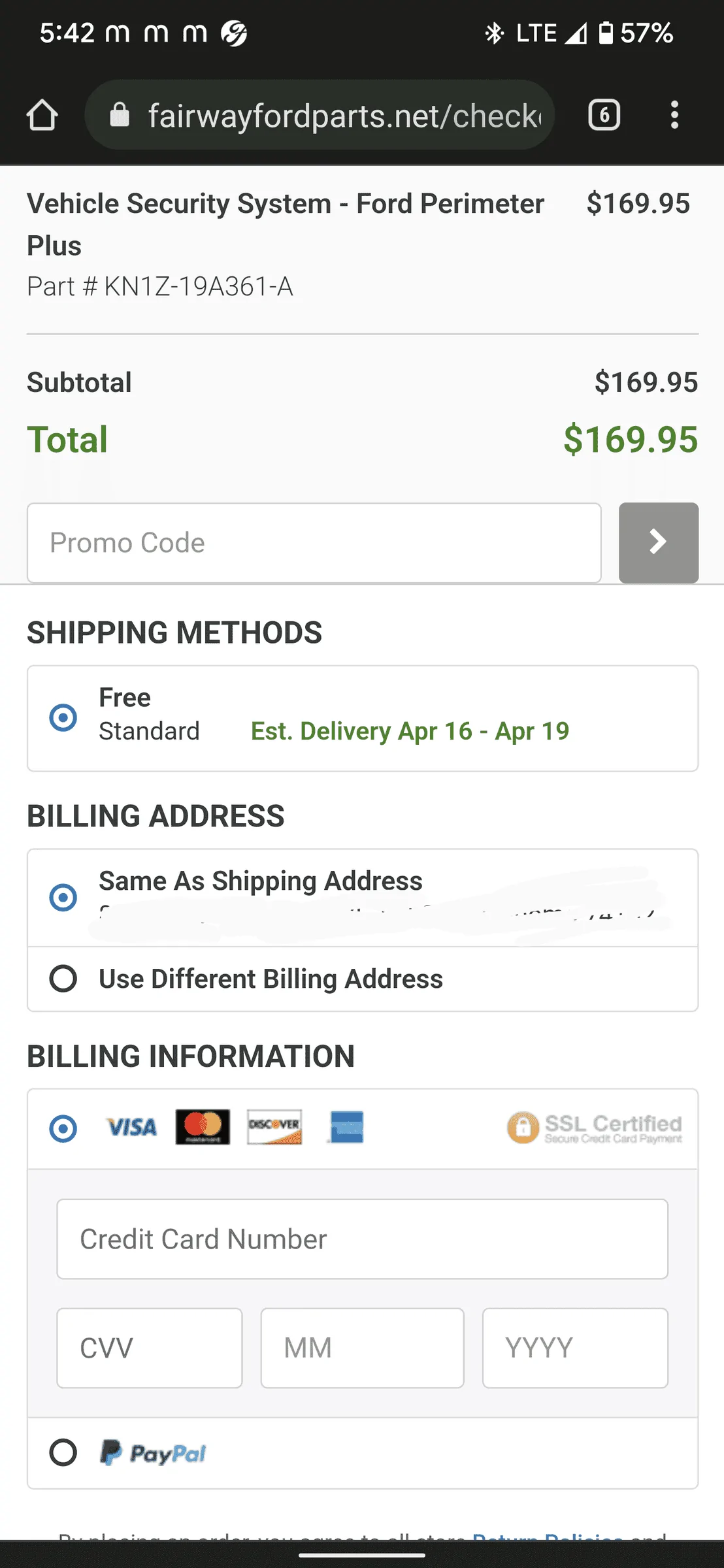

You can use points online at fairway ford. Ive bought with points from them and so have many on this forum.
Thanks, how would you do that.
I'm on the checkout page and I see a spot to enter credit card information or PayPal and then submit order, there's nowhere to enter Ford pass points.

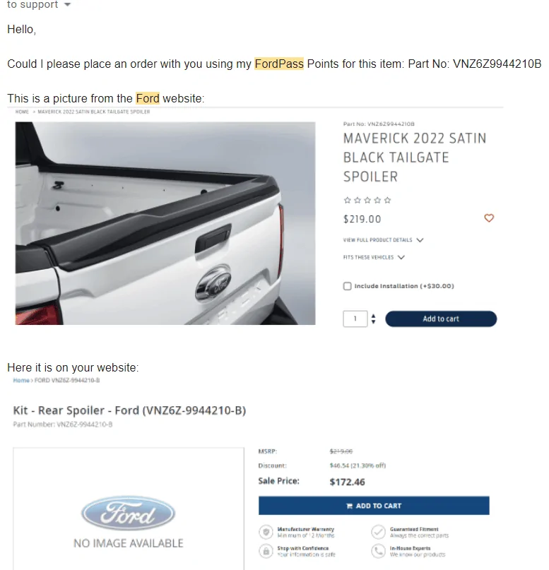

You have to call them or send them a message.
I emailed: [email protected]
I told them the item I wanted, gave them the item number, and gave them my fordpass account number, name, address, etc.
The next email I got from them simply said, "It will ship tomorrow."

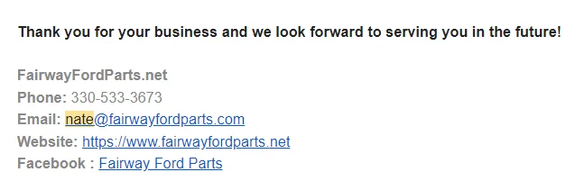

Everyone here and on their website says you need to call "Nate." Ive spoken with him before, definitely the guy to talk to over there.

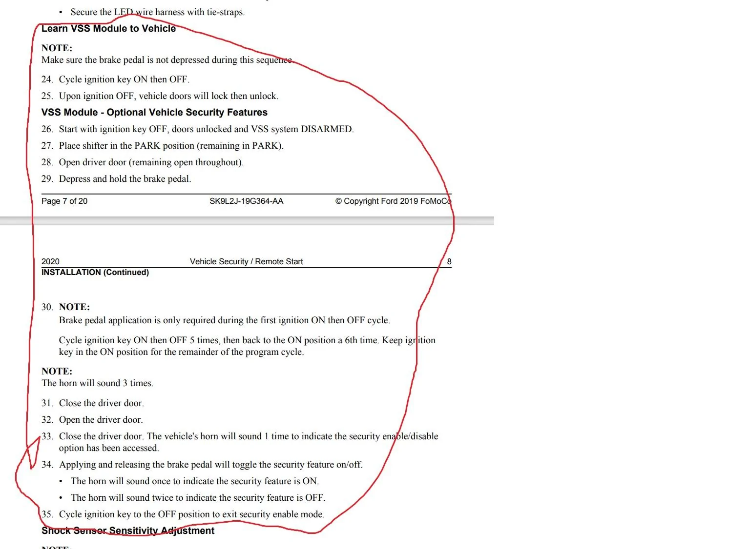

No sir. Once installed the manual has you do a little brake peddle / key switch dance so that the new module is recognized. Then you perform a series of tests to ensure all works, and to make any adjustments to the shock sensor sensitivity, and away u go
Thanks, ordered one today from fairwayford for $170 and used my Ford Points.
Is this the install manual you used?
Did you disconnect the negative battery terminal and do everything I circled in red?
Ford Maverick Anti-theft proximity alarm? Perimeter

You got it - and I did not bother with pulling the battery ground. No action required for the key fob to work as a remote start.

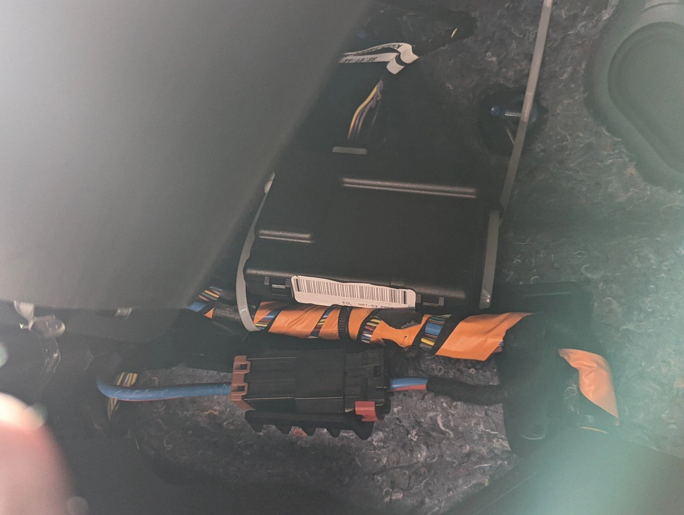

Thanks, I got it installed but may need to change the mounting location. It's not going off on max setting if I hit the passenger side. I tried securing to that bracket in the picture. Didn't see any solid metal cross members.
Where did you mount yours? Also the Ford Pass app no longer gives a message if the alarm is set off, this was working a few weeks ago. Does yours send an alert?
Edit: I just got One Alarm Triggered notification in the Ford Pass app, after setting it off probably 15 times testing it.
I removed some trim pieces and secured the device higher up to a metal dash brace, it's not any more sensitive, maybe less.
