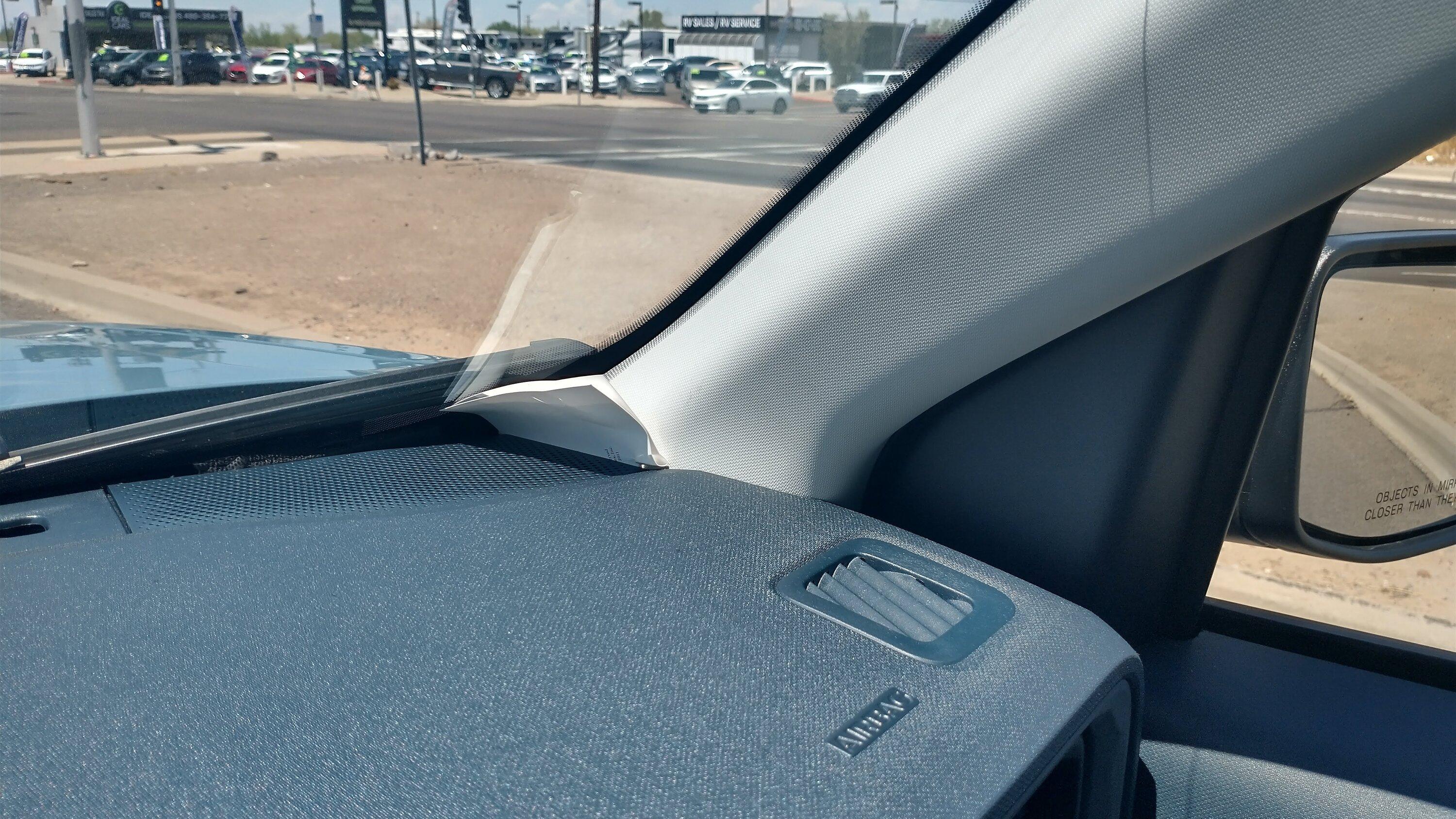

I fixed the dashboard buzz/rattle thing. I bought 5 pieces of black craft felt from hobby lobby, and a can of 3M spray glue. I spray glued the felt and rolled each piece into a tight cylinder. Then using a wooden paint stir stick I wedged them down across from center out, between the dash and the windshield. Problem solved.
