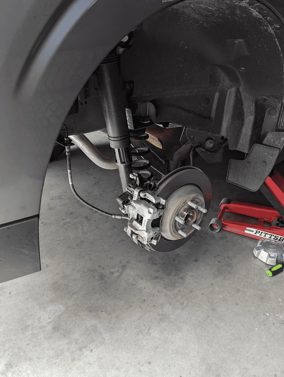

The hybrid uses Ford's force vectoring springs in the rear, they are curved to act like torsion bars and reduce body sway.
I see that Air Lift's website says this kit is for Maverick FWD versions but I'm not really sure if the FWD Ecoboost Mavericks use the force vectoring springs like the hybrid does. I have not seen pictures of a FWD Ecoboost Maverick rear suspension to know what springs are in use.
I'm wondering if these bags straighten the force vectoring springs and defeat the spring's purpose.
I have tried contacting the company but I only get people who look at the website and say 'yep, they work for the FWD version'. I cannot get an answer to 'are they are designed for use with the force vectoring springs'.
I thought I'd ask someone who is using them, "do they straighten the force vectoring springs"?
Thanks for your attention and help.
Here is a photo of the rear suspension on my FWD ecoboost. Looks to be the exact same as hybrid eh?
They both use force vectoring springs and that is one of the reasons the tow capacity is limited to 2k on all FWD vehicles.

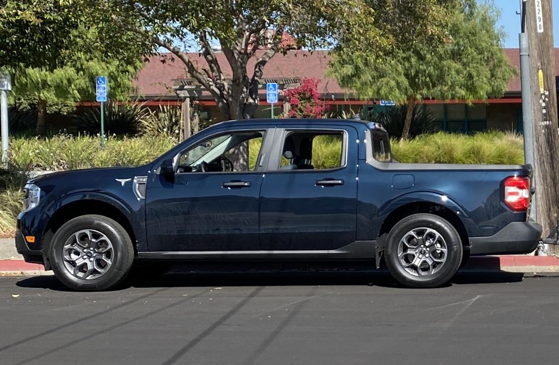

Call this 400 pounds tongue weight on the hitch and 300 pounds in the bed. With the air lift kit at 20 psi.
