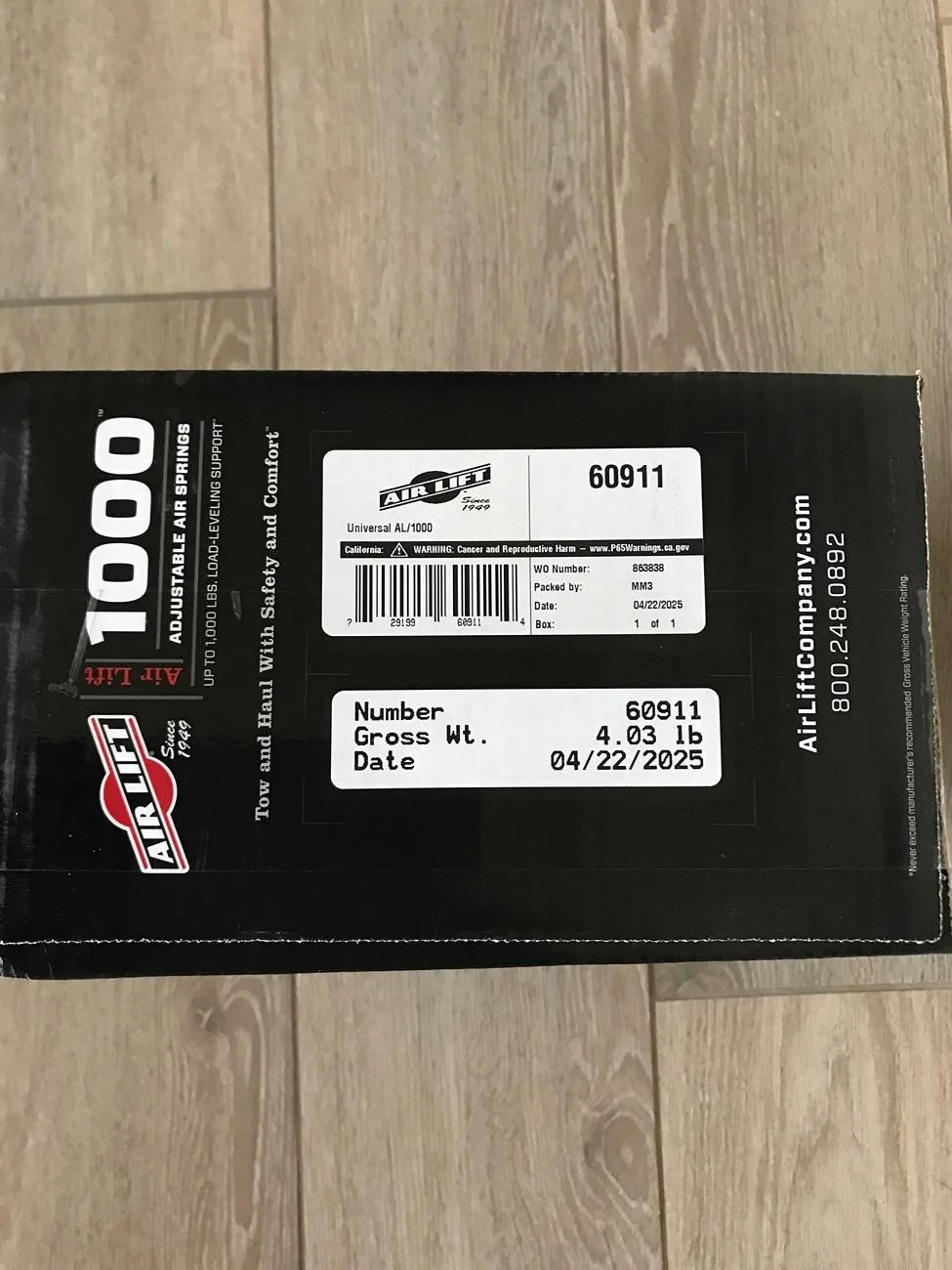

Just went through the process of obtaining and installing the Air Lift 1000 system. The previous post are correct. The AWD are smaller and can be ordered from E-Trailer or directly from Air Lift. The photo below has the number. E-Trailer only has the AWD models. I spoke to the headquarters in the product sales department and after a light search he identified the Front Wheel drive Mavericks use a Universal AL 1000 kit. Air Lift doesn’t offer free shipping but it wasn’t much.
I paid a local installer from the E-Trailer list and assisted with the installation (mostly handing tools) and it was not a cheap install ($300) but worth it to me. I now run around town at 10# pressure with no change in feel and bump it up to 35# pressure when pulling my camper. You’ll notice the extra help with a load.
