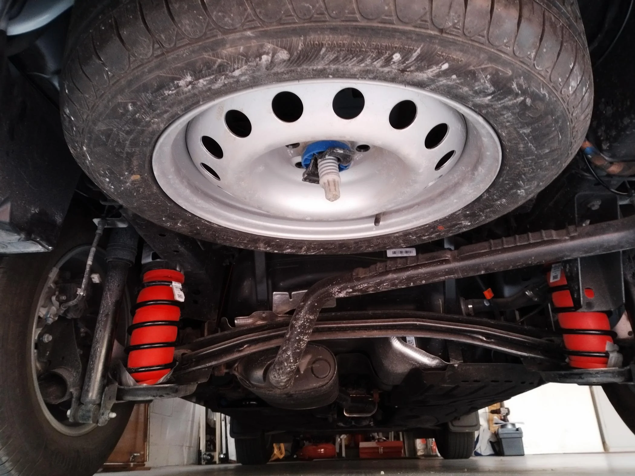

Measure the inside of your spring and the height while the truck is in the driveway empty, Summit Racing had them in stock, it a PIA working around the bracket that protects the gas tank from the exhaust pipe but other than having to fix the abraded tube coming out of the left air bag it has really helped while towing.
Ford Maverick Air Lift 1000: Kit Confusion? IMG20230419094454
