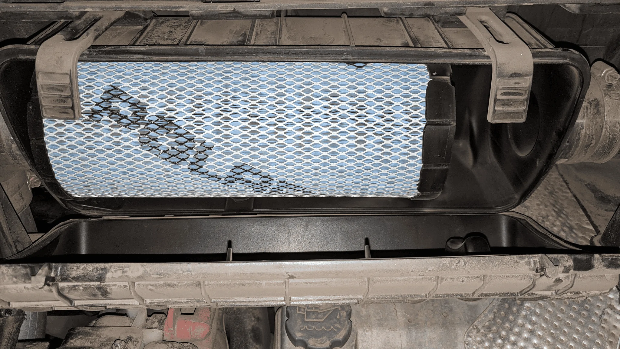

I use an AEM Dry Flow on my track car, and OEM paper filters on everything else. I even go as far as to install particle separators on my SxS' with UOA before and after.
Ford Maverick Air Filter - Trash Talk 1714755749876-d2
Since putting those in, I haven't had to change a filter in 2,500 miles of riding silty, dusty trails. Prior to that, I had to replace the filter after every weekend. A lot of guys won't buy a used machine if it has a K&N on it.
